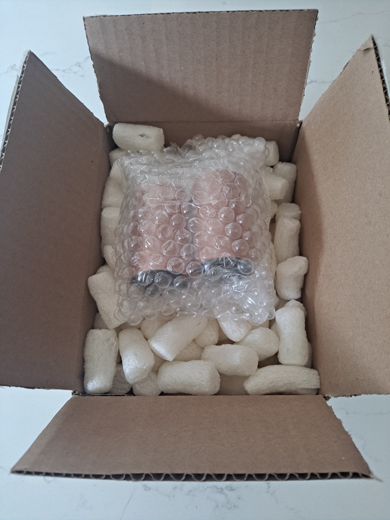

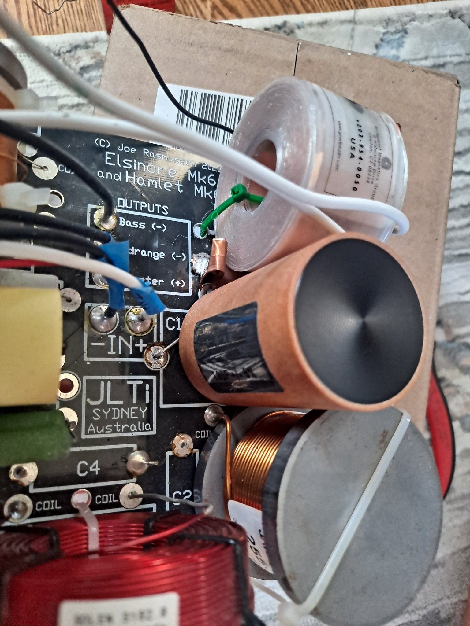

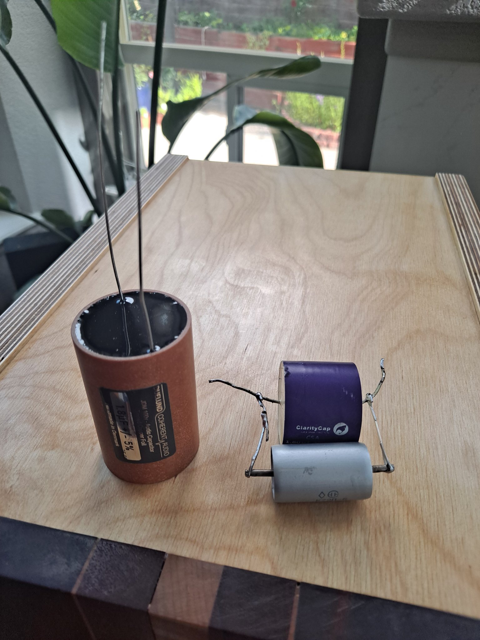

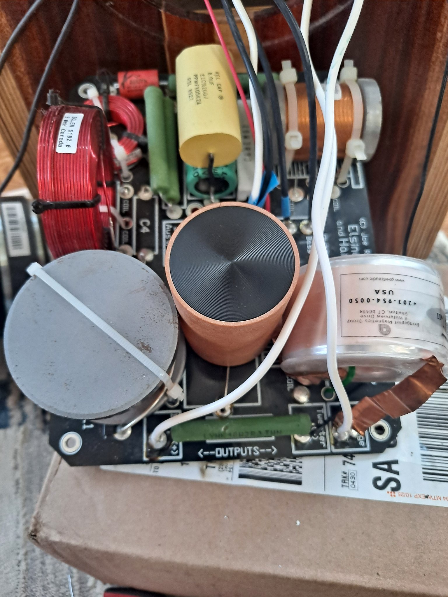

I received the Duelund caps from Parts Connexion today. I was able to get the 0.47mH foil inductors for the midrange on the board as well as the Duelund caps onto the board. The foil inductors have been installed for a while but with smaller caps. You can see the claritycap/Russian film that was in the circuit before.
The fact that they are radial is actually a really nice thing. They can be installed to one side of the axial footprint which allows you to run a large foil inductor on the midrange. So you can have your cake and eat it too. Axial caps with these dimensions would not fit with the large inductor... Also, if you wanted to place the cap on a small dab of silicone, that would secure it and allow you to pluck it off of the board if needed.

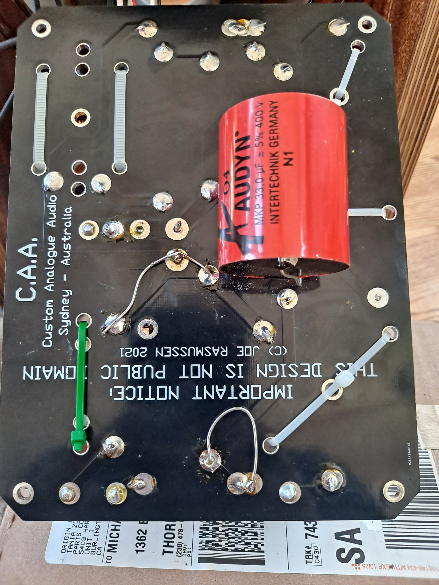

Because you do not dare snip Duelund leads, I simply soldered them to pads following the traces on the bottom of the PCB. So if for some reason I want to remove this cap, I can desolder the leads, then melt the solder on the tweeter pads and pull the Duelund leads through.. Very nice! And I will have the full leads intact.
It is still early but the sound is definitely very nice!
