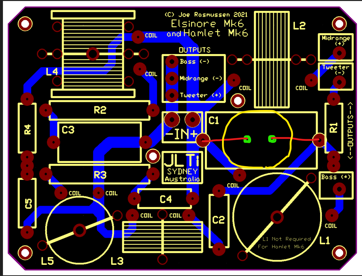

Have you boughten the TCM caps yet? Joe talked about how the Miflex and Duelund are significantly better. I mentioned the Elsinore project to Parts Connextions and how Joe liked the Duelund tinned copper caps as one of the options. Miflex is having issues at the moment so production has ceased. However, Duelund seems to be doing alright. So Parts Connexion talked to Duelund about making some 1.8uF 100V caps which have dimensions that should comply with Joe's PCBs. The owner of Duelund (Frederik) said it was a much better idea to go with the 100v VS the higher voltage alternative. It also brings the size and the cost down a bit.
They are radial so this is what I am going to do when I get mine:
If you look at C1, you can see my ugly editations. The green represents two holes being drilled, the red represents the leads being soldered to C1's pads from underneath and the yellow circle represents the cap's footprint sitting on board vertically. If you wanted, you could place the epoxy portion of the cap on a could small dabs of silicone or hotglue. However, with the dampening charactoristics of the capacitor, I don't believe you need to worry too much.
