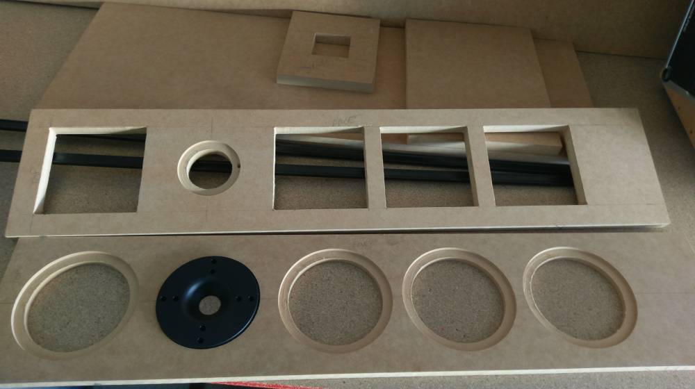

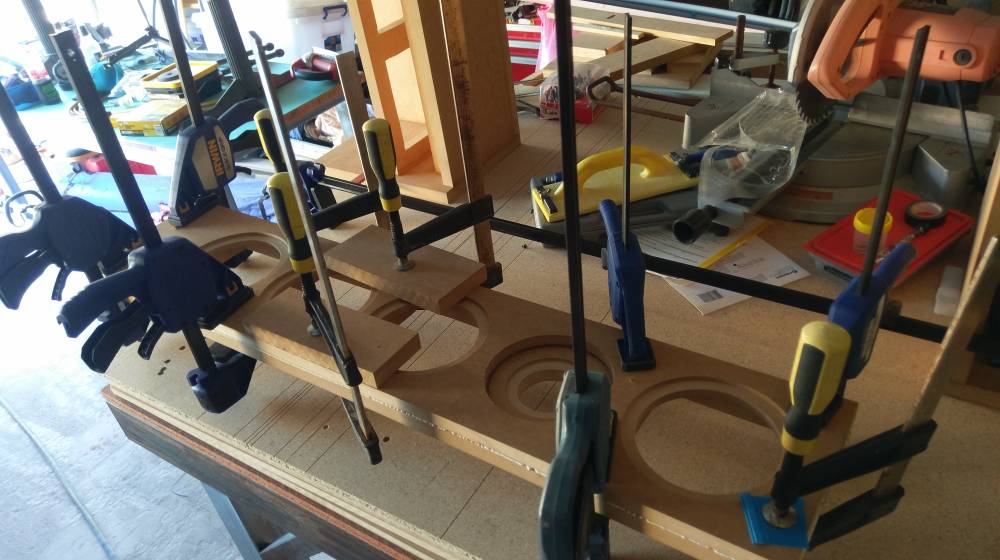

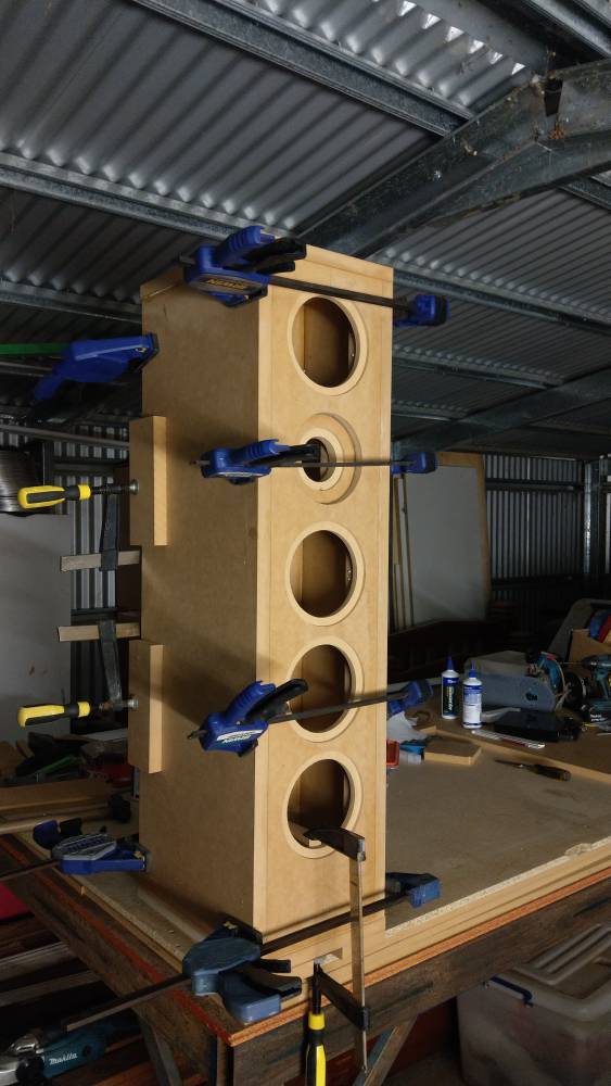

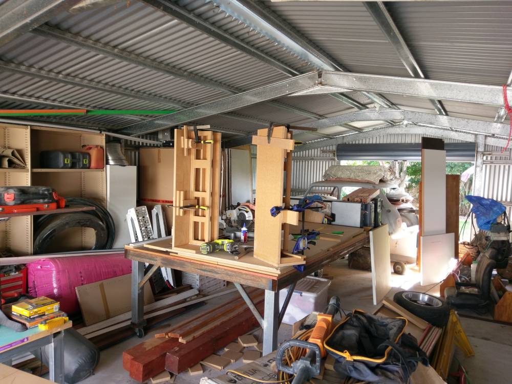

How's everyone doing the speaker holes? Last time I did some I used a hole saw and a rebate bit to flush mount the driver. I've only got a 9.5mm rebate bit which isn't going to cut it.
I also used holesaw for 15", stupid but it worked.
attachment.php
attachment.php

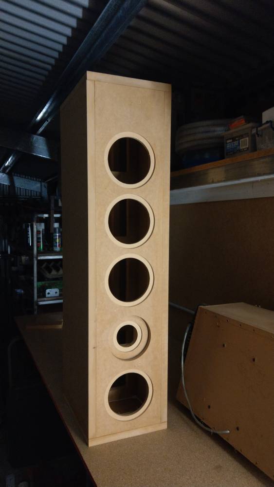

Now i build my jasper jig with 6mm plywood
attachment.php
One thing I learned when cutting the holes was when you cut the complete circumference in one go the piece you are cutting out sort of cog wheels with the router bit and takes a chunk out of the edge of the hole. I found it best to almost complete the hole, stop the router and knock out the centre piece, and then clean up the edge with the router. Looks like you're making good progress. What finish are you planning for them? One piece of advise, do the finishing before you take them inside for listening otherwise you may never get them back into the workshop!!
If the pin for your hole jig is long enough, its best to put a piece of scrap wood under and clamped to the piece you are cutting, drill your center hole for the pin through both pieces and set the router depth to just get through the piece you are cutting. When the hole is completed, even though the cutout is loose, the pin is still set in the lower piece and the router is still secured and not set loose.

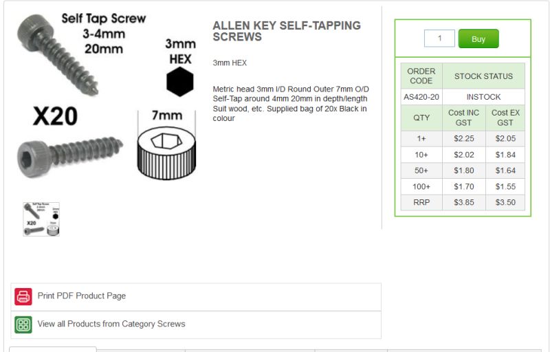

What screws are people using for the drivers?
I found some 8g x 38mm pan head in black on ebay, does that sound about right? It looks like the SB drivers use a non-countersunk screw.
rampage101,
From the diagram on the product page, looks like M4 or size 8 guage screws should work:
6" SB17NRXC35-8 :: SB Acoustics
I would also prefer a non-countersunk screw.
Screw length - possibly 25mm (screw body length only, without the pan-head cap) would be enough? How thick is the part where the screws will get inserted? If it's not too thick, and you use much longer screws, the sharp points will just stick out from the other side... in case you need to adjust the fill or internal wiring etc. there is a chance of getting pricked.
Max diameter on the pan-head cap needs to be within ~8mm.
High quality gloss black can look very nice, but can be a lot of work. Have you painted gloss black on MDF before?
I had intended on cutting the screws off if need be, but thinking about it now 25mm should be plenty.

WES Components have these screws which have a nice appearance. They suited the Pereless Nomex drivers very well.
