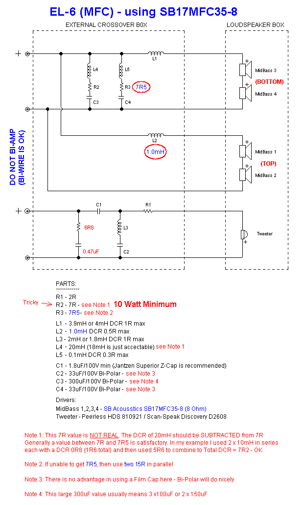

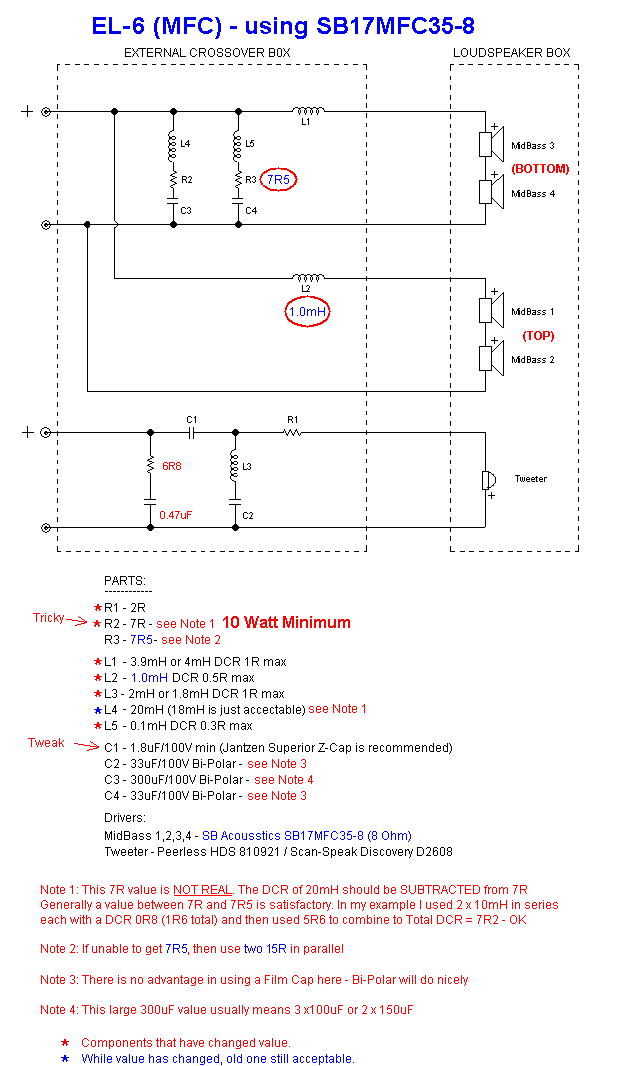

Taking a closer look, it now clear that the use of the alternative MFC driver (SB17MFC35-8) needs two minor changes to the Crossover to optimise things. The changes will be shown below.
Without these changes the Elsinores will still work, but the changes recommended gives a smoother and with slightly less brightness in the upper midrange and lower treble, that then matches what we already have with the NRXC driver.

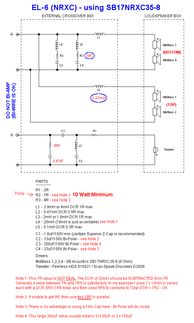

To keep things simple, from now on we shall refer to the two variations a EL-6 (NRCX) using SB17NRXC35-8 drivers and EL-6 (MFC) using SB17MFC35-8 drivers. Clearly the tweeter remains the same.
With the changes recommended, I have been listening to EL-6 (MFC) version and I can assure everybody that it works just as well as the NRXC driver. I am very pleased and I will be keeping mine working with the MFC drivers. The difference in sound is so small as to be inconsequential - the replacement drivers is NOT a downgrade. So please feel secure in going ahead as the MFC driver will continue to be made.
OLD NRXC:
NEW MFC:
In both diagrams the components that are different have been encircled. For the MFC version the L4 0.47mH is changed to 1.0mH and R3 was 9R must be reduced to 7R5 because of the effect of the inductor change has made to the load impedance.
I cannot hear any downsides with the new MFC driver, the sound is remarkably close with either driver. So if you have had any doubts, please dispel them.
OLD NRXC:
![EL-6_Xover-NRXC1.gif](https://www.customanalogue.com/elsinore/elsinore_images/EL-6_Xover-NRXC1.gif)
NEW MFC:
![EL-6_Xover-MFC.gif](https://www.customanalogue.com/elsinore/elsinore_images/EL-6_Xover-MFC.gif)
