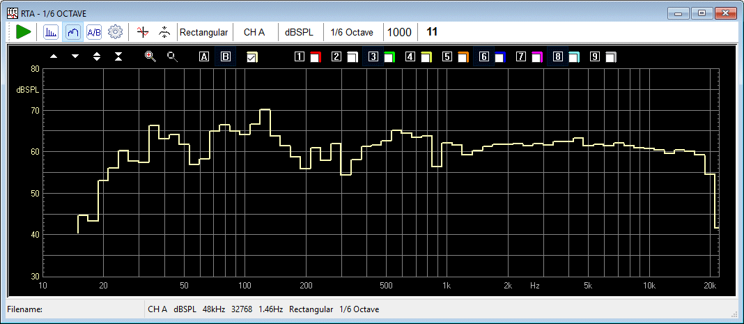

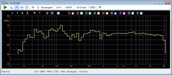

I had included the RTA measurement and it did not work and I still can't get it to show as an IMG link.
So you will need to click on it as a URL link.
www.customanalogue.com/elsinore/elsinore_images/EL6-MFC-OFF-AXIS.gif
Keep in mind that the below peaks and troughs are room modes and they change where you are in the room and is normal. Above 1KHz the room modes gradually become less and note how smooth the response becomes. This in fact is smoother than the NRXC.
The response below 1KHz is basically the same for both NRXC and MFC versions.
(Added it as an attachment as well.)

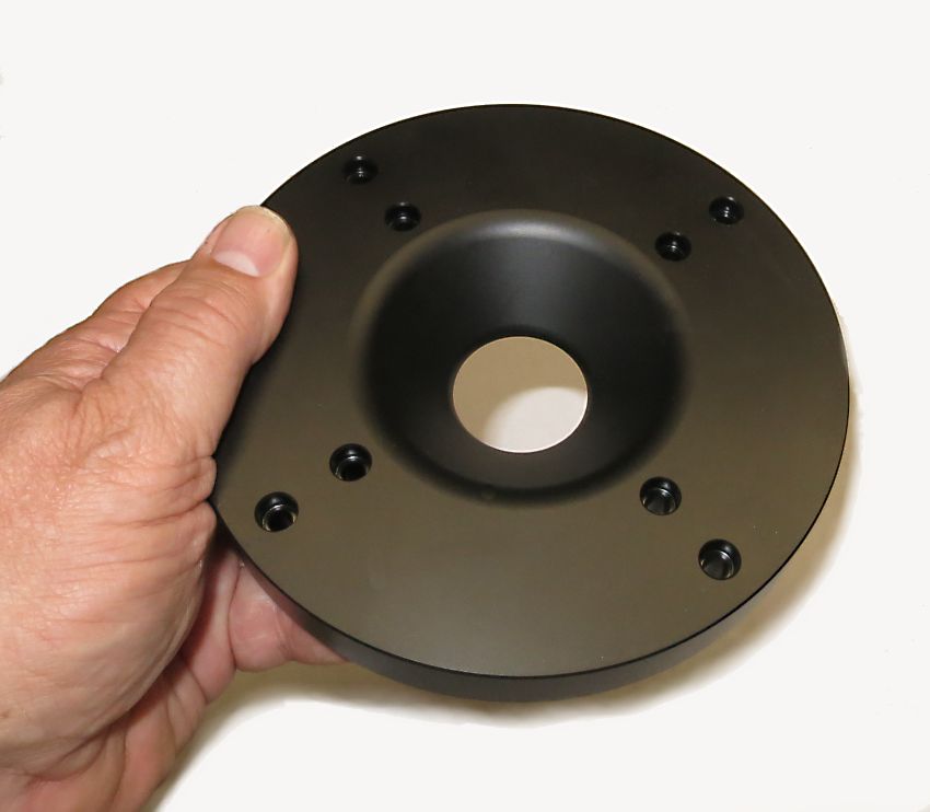

I think i figured out most of all the design but have one question, what is the inside diameter for the waveguide and the diameter where the curve stops before it turns to a flat disc of sorts. the waveguide is the last thing i need to model. in the mean time I will share where I am now and hopefully someone here can review my work and make sure everything is correct.
Re the Waveguides, you do know that they are available and also buying them and using them does go a little way, not a lot, towards regaining some of the costs as even DIY is not free to the one offering it.
The Waveguide needs to be an incredibly close fit near the 'throat' where it sits inside the bevel next to the small surround and voice coil. If you don't get that right you can get a very erratic response in the upper octaves.

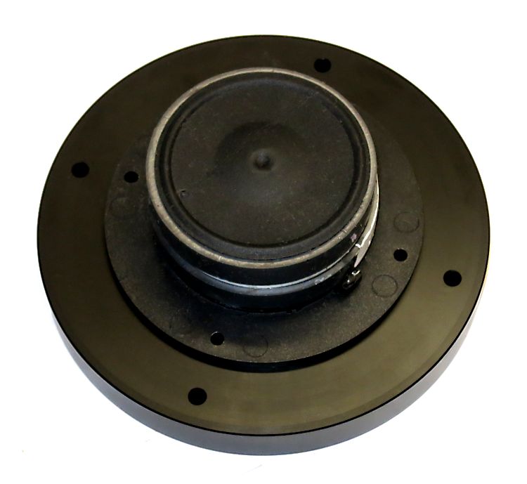

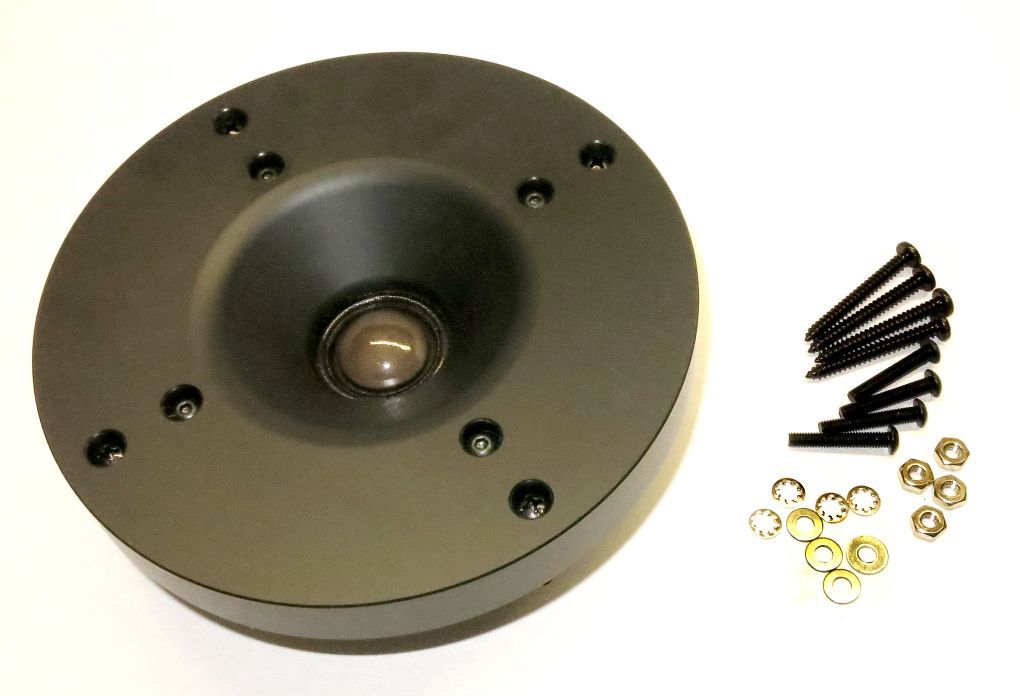

I am not doubting the quality of the waveguide, just thinking that if I have this made using cnc I should be able to incorporate the waveguide into the design. However I am kinda thinking I misunderstood how the waveguide works and is connected. I was thinking that the tweeter geets mounted to the sub front panel, and the wave guide gets mounted to the front panel sitting on top of the tweeter.
judging by the upclose photos of the wave guide, it looks like the tweeter is mounted to the waveguide and the waveguide mounted to the front panel?
That's right, they are mounted together first with the black bolts, nuts and washers (supplied). Then the waveguide with tweeter is now screwed into the sub front panel with additional black screws supplied. You will note that the front panel where the main drivers are mounted is 18mm thick, so is the waveguide, so it ends up sitting flush. The cutout is 150mm and the waveguides are 148mm diameter, so you will have a small 1mm gap all around. It all works really neat and most importantly is that it is not mechanically compromised.

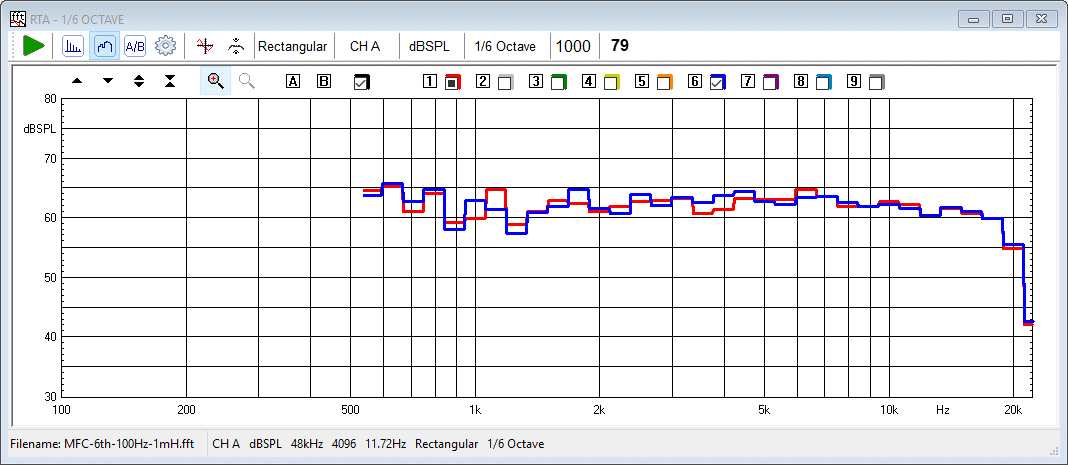

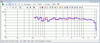

I have had problems posting graphics from my website here, so I will try again.
The Blue is the newer MFC driver and the Red is the NRXC driver.
These measurements were taken before and after the drivers were fitted. The difference at 500Hz to 2KHz may be explained because while the exact distance was preserved, but not necessarily the exact height. So please make allowance for that - but I am pleased.
I will also add the graphic to the attachment below, in case there is a problem.
