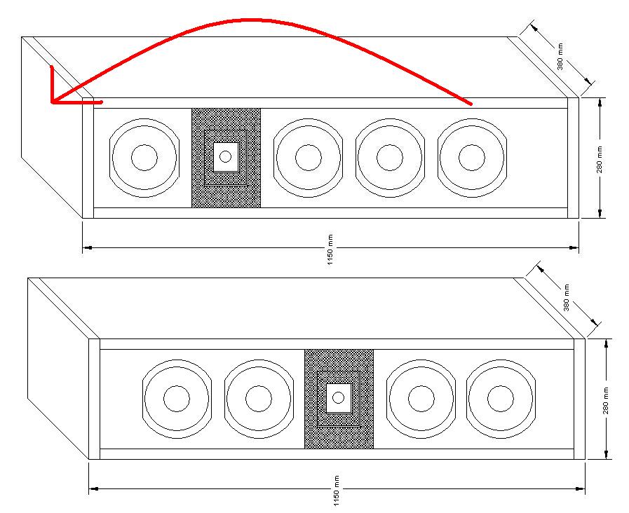

but i must have missed the final conclusion on the center speaker, how did it end up? 16ohms MTM?
Is it possible to make it a MMTMM, by simply moving one speaker unit to the other side? size is not a problem 😉
Not sure if I understand the question. Oh, maybe I do. Hmm... it would make for a BIG centre speaker.
Something occurred to me, but need to know the answer: Are you able to do pink noise 1/3rd Octave in-room tests? As this is a centre speaker, perhaps diffraction loss is not that critical. And what we have in mind should be able to tweak by ear. Pink noise tests would help.
I think we could get somewhere if you are willing? I think a 16 Ohm MTM is possible. We are not starting totally from scratch...

i am unfortunetly not able to make the measurements, since i don't own any equipment. also the reason why i am building speaker kits
ups i didn't mean a mmtmm but a BMTMB, Hope you get what i mean from the picture i added.

im currently in the process of building LCR elsinore speakers. Regarding the centre design im just following the details as listed on page 4 of this thread. All parts are cut and im awaiting binding posts before assembling all the boxes. Im holding off purchasing corssover components until all the boxes are built.
It seems that the centre channel and two-way for those who want compact (relatively speaking) stereo pair as well as for other multi-channel purposes, will be a reality in 2009.
Since you are in Perth, if/when you have boxes ready before Rob does (he is a couple of hours away), I can give you a suggested crossover for the time being, to get yours up and going. But I need to arrange with Rob to actually get a physical box here and then the final tweaking and fully recommended crossover. But based on my current measurement of the Elsinores I should be able to come up with something for you first that you can later just update to the final product/crossover.
The same applies to anybody else wherever they are. The results and development will be reported here.
We can make this a team work and anybody willing to build the box right now or within a short time, will effectively become part of the project. How is that for encouragement? 🙂
