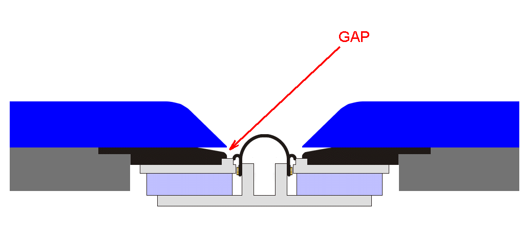

Computer Modelled Results:
That will be the result with details supplied so far.
OPTIONAL - PLEASE READ AND DECIDE:
IF a Zobel Network made from 10R Resistor and 0.68uF, it will look like this.
Note the flatter HF Impedance (Z) and Electrical Phase.
Later I would like users to test this optional extra. Note that it is no affect on the Frequency Response with Voltage type amps and very neglible with non-Voltage amps.
Yet it sonic influence is something I'd like an opinion about. It shuld not be a hard test and we can share its influence.
OPTIONAL CROSSOVER PARTS LIST
2 x 10R 5W min
2 x 0.68uF Film Cap - Use Good Quality
Again re-iterating what I said above, that 2.2uF High Quality cap going to the Tweeter, while I have specified that value, I would also like to try 2uF and live with it for a little while before making final comment. So If I change that valuie, hope you don't hold that against me, but I will advice what I do.
I think I have now passed on all the Crossover details I have now.
Now have to wait for Steve to come back with final Waveguides for distribution. These will be measured up and possibly posted (Steve will have final say).
In the meantime, if any questions to be asked, fire away.
Cheers, Joe R.

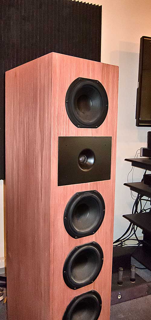

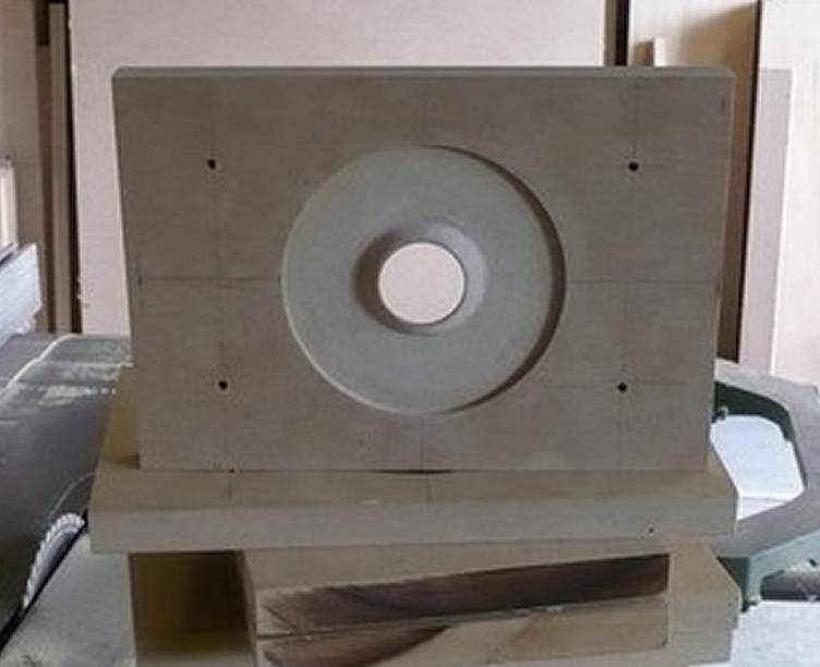

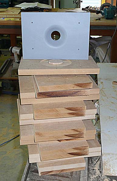

Hi Joe,
I hope you can send the waveguide in France .. I started building the Elsinore for several months now, but I have not yet been completed yet. I want to finish them with white lacquer (like piano). not an easy finish with MDF. The MDF has a tendency to swell with moisture, I fixed by painting the inside of the box.
Is the waveguide will look something like the peerless india large faceplate?
Shallow Waveguide (Buyouts) - Techtalk Speaker Building, Audio, Video, and Electronics Customer Discussion Forum From Parts-Express.com
Maybe I could ask a friend to do it for me with the dimensions and a CNC lathe.
Is it possible to choose a better value for L1 than 1 Ohm? And let L3 1 Ohm max?
As 1.8 mH 0.43R for L1 (M-L140-180 for ex.) and 1.8mH 0,7R for L3 (M-L100-180 for ex.)?
I have often heard it's better to have a DCR as low as possible for Bass speaker, but I don’t know exactly what that change. I don’t want to sabotage your good work with my mistakes.
The Peerless tweeter, there is a touch of white paint on a stud, but I do not know if it's for negative or positive. Does someone can give me an answer?
Thank For all your work and your knowledge sharing.

Yes, getting that glossy finish in MDF is a LOT of work.
The Waveguide will fit into the exact space, the cavity, that the felt is currently fitted. They will be made of MDF and it will be up to you what finish they are. More instructions to come including photos.
If we end up publishing the Waveguide dimensions a CNC machine would be handy. But I need to consult Steve.
The DCR, DC Resistance, is the recommended maximum, so lesser value is good. But low DCR is also expensive, the values I have given means that it shouldn't be hard to get good chokes at your own budget.
Yes, that white dot is positive, others use red and not sure why they didn't likewise.
Cheers, Joe

Here is the problem:
This creates a gap when the conical waveguide is fitted:
Steve says that is the single greatest and most time consuming aspect of make the Waveguide.
Here is a few photos he sent and I cropped and resized, sharpened a bit:
BATCH:
The Waveguide will come with an undercoat. This will protect the MDF from absorbing moisture until you get it. It is suggested you get a spray can Black Enamel - I can get for $5 up the road from here (alternative colour you like). I suggest Satin or Semi-Gloss as the most practicable - flat looks just too flat and glossy shows up the tiniest imperfections.
CLOSEUP - FRONT:
The cavity the Waveguide fits into is 230mm by 160mm, so the Waveguide is designed to fit into that cavity with about 1mm to 1.5mm gap. We are aiming at near 1.5mm, but with a coat or two will be slightly less.
Of course one can carefully trim the edges to give a bit more movement, but it is really more of a matter of getting the Tweeter to line up with the throat of the Waveguide. If you have to move the tweeter, the good thing is that any imperfection is covered up when the Waveguide is in place:
![tweeter-wave-gap.gif](/community/proxy.php?image=http%3A%2F%2Fcustomanalogue.com%2Fdiy%2Ftweeter-wave-gap.gif&hash=733307fedf9167178c32bcefb4b5fd19)
BATCH:
![Elsi-Wav-%20batch.jpg](/community/proxy.php?image=http%3A%2F%2Fcustomanalogue.com%2Fdiy%2FElsi-Wav-%2520batch.jpg&hash=7b65dfe9a026ac5d9f536aff0bdc6b19)
CLOSEUP - FRONT:
![Els-Wave-front.jpg](/community/proxy.php?image=http%3A%2F%2Fcustomanalogue.com%2Fdiy%2FEls-Wave-front.jpg&hash=57133030939594ab20b83ded9509bab0)

Final Pic - Prototype:
Make sure to click on it - it looks squat on my monitor:
![MyEls-Wave.jpg](/community/proxy.php?image=http%3A%2F%2Fcustomanalogue.com%2Fdiy%2FMyEls-Wave.jpg&hash=903602f822812c0a63c1126cf69e3465)
