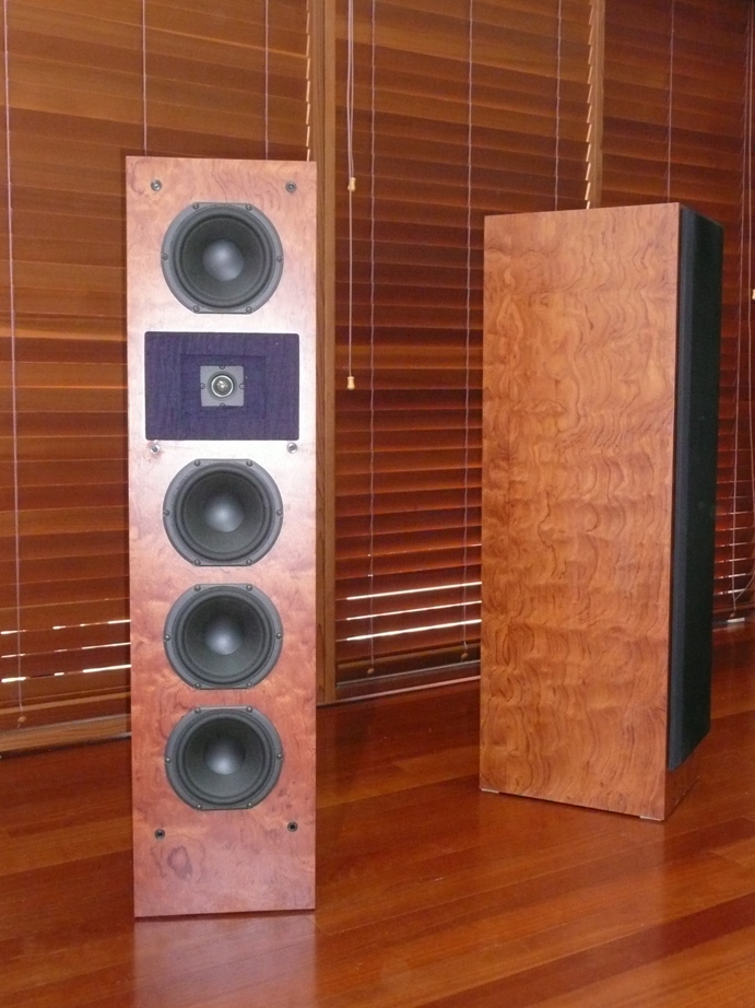

Gday All
My first post so be gentle with me.
First batch of waveguides will be sent to Joe next Monday.
Long time follower of this thread.
Elsinores has been my first effort in the DIY audio world and I am blown away with the results.
A couple of photos of my pair attached (I hope)

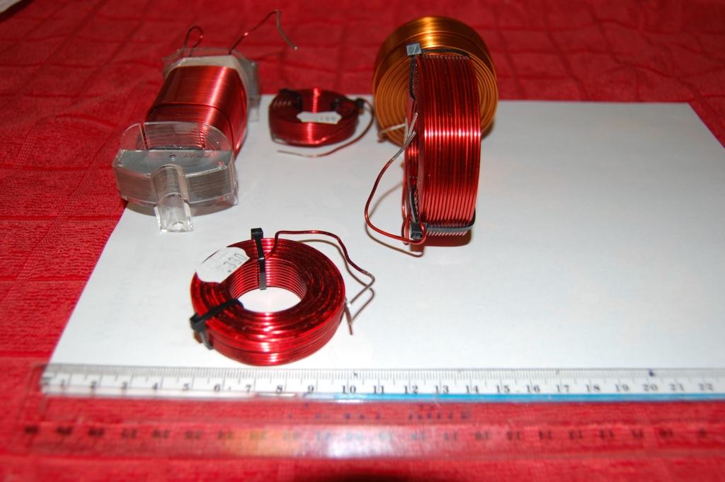

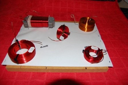

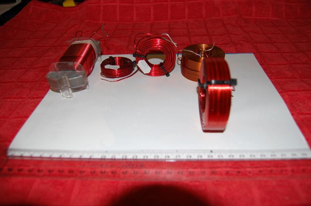

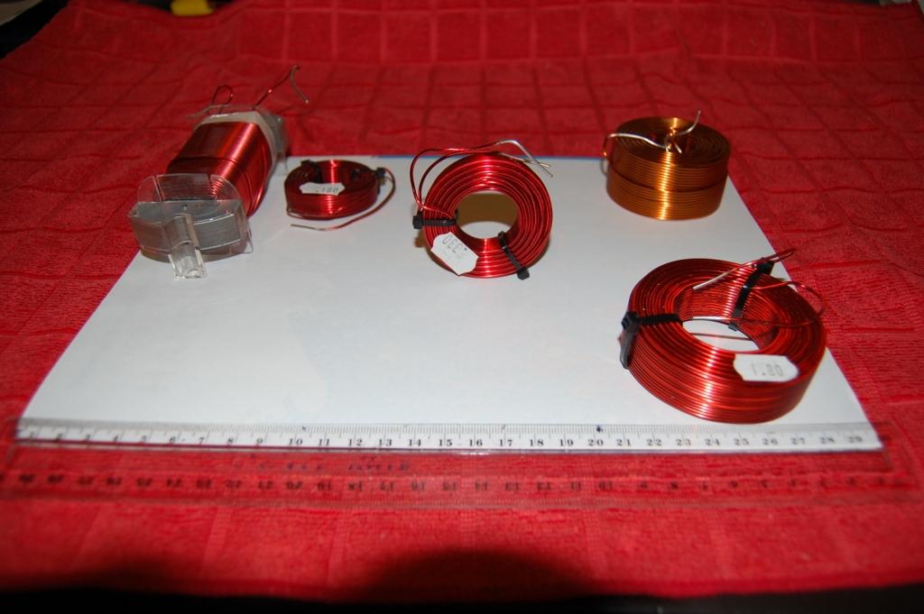

Currently trying to set out the coils on a4 paper for best orientation any suggestion appreciated.
I was looking at humbles website and he packs the stuff really close together, couldn't find one with five coils though.I did see his write up on coil placement but the five on one board got me.
Cheers Paul

Hi Paul,
Changing the driver orientation should make no difference, as long as you manage your wire connections.
My layout is most like your Pic 1.
Apparently lab measurements indicate that any crosstalk is very low after about 50 mm between coils I usually go or the greatest separation allowed by the dimensions of the mounting area (or box). Another rule of thumb says that when you look straight through the whole of a coil you should not see another coil behind it, especially not one with the same coil orientation. Pic 1 looks the best in this regard also.
My 2 cents. Good luck.

Good news about the waveguides and congrats with your superb looking Elsinores. They speak volumes about your craftsmanship.
