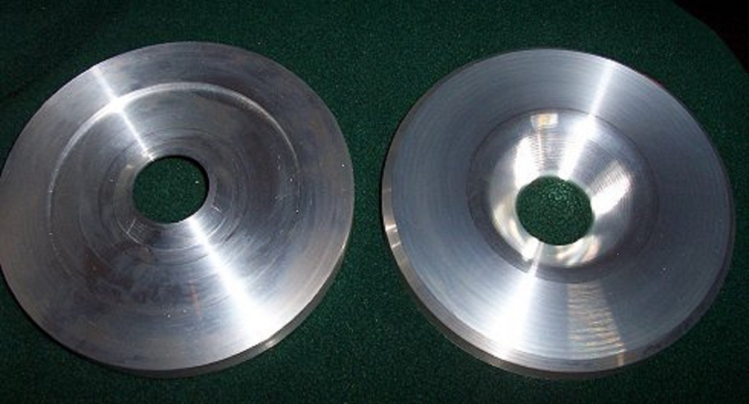

Today, I was At Creative CNC and and after a long discussion on different ways to make the Wave Guide, the best method we came up with was with Alluminum round stock turned in his CNC Lathe. I paid $200 to get first pair made and additional pairs will be about $100. The outside diameter is 150mm
The pieces should be anodized or clear coated.
When I get the units I will post pictures with more details.
The cavity would have to be filled in beyond the Waveguide. Sorry this was the best I could come up with but willing to make MDF filler boards for anyone..

ALUMINUM WAVEGUIDE
You can check shipping costs below MY PC L1E 3B2
I used Small Packet International Air NZ $36.07 GB $33.45
Final Cost is Subject to taking them to Post Office and getting printed quote
http://www.canadapost.ca/cpotools/apps/far/personal/farInt?execution=e2s1
The more people that want these price will lower
(200 + cost for each additional pair divided by the number of people) + filler board + shipping.
I could make the filler board slightly oversized and can be easily sanded to fit snuggly in the opening and so Waveguide ends up in the right place. I can also veneer the board and have a wide selection of veneers on hand. Cost wont be much.
I'll get pictures when I pick them up. I'm trusting these will be good. The guy has done some amazing things with AL. When I arrived he already put Waveguide in CAD and I viewed it in 3D. He made the front of one in lathe with MDF and looked good..
There is guy in my area that powder coats car parts. I might look him up
but dont know if this is best for Aluminum.

Waveguide pictures from Steve at Creative CNC
He decided on his own to put a 45 on the outside and I'm a bit pissed.
I know his heart is into it but not sure if its going to work for the way I'm putting these in. Might have to ask for another pair. The 45 could look good along with a 45 on the filler board but I'm also adding thin wood to flush fit the drivers..
Dont know how the pictures will look but when I pick them up will have friend do better pics..

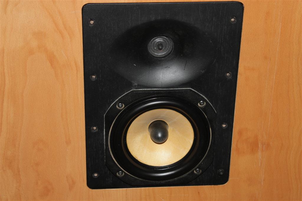

Joel
that 45 degr edge is easy to remove by hand ;)
but a bit small to support the tweeter around its xo point
looks more like a super tweeter thing
or maybe there's more to be added, and I missed that part
well, mine aint too big either
shown for inspiration only, and interest
