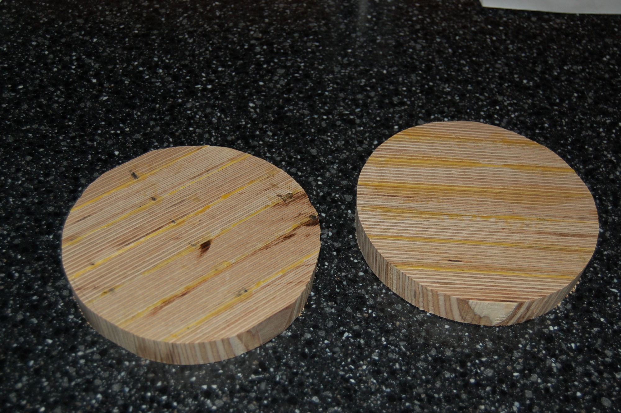

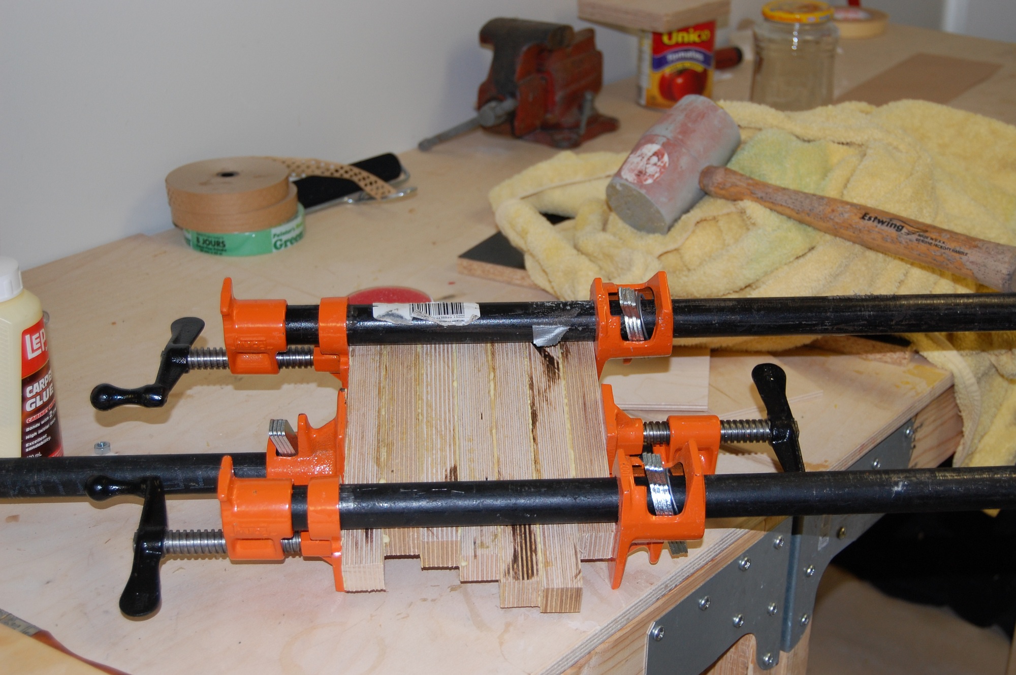

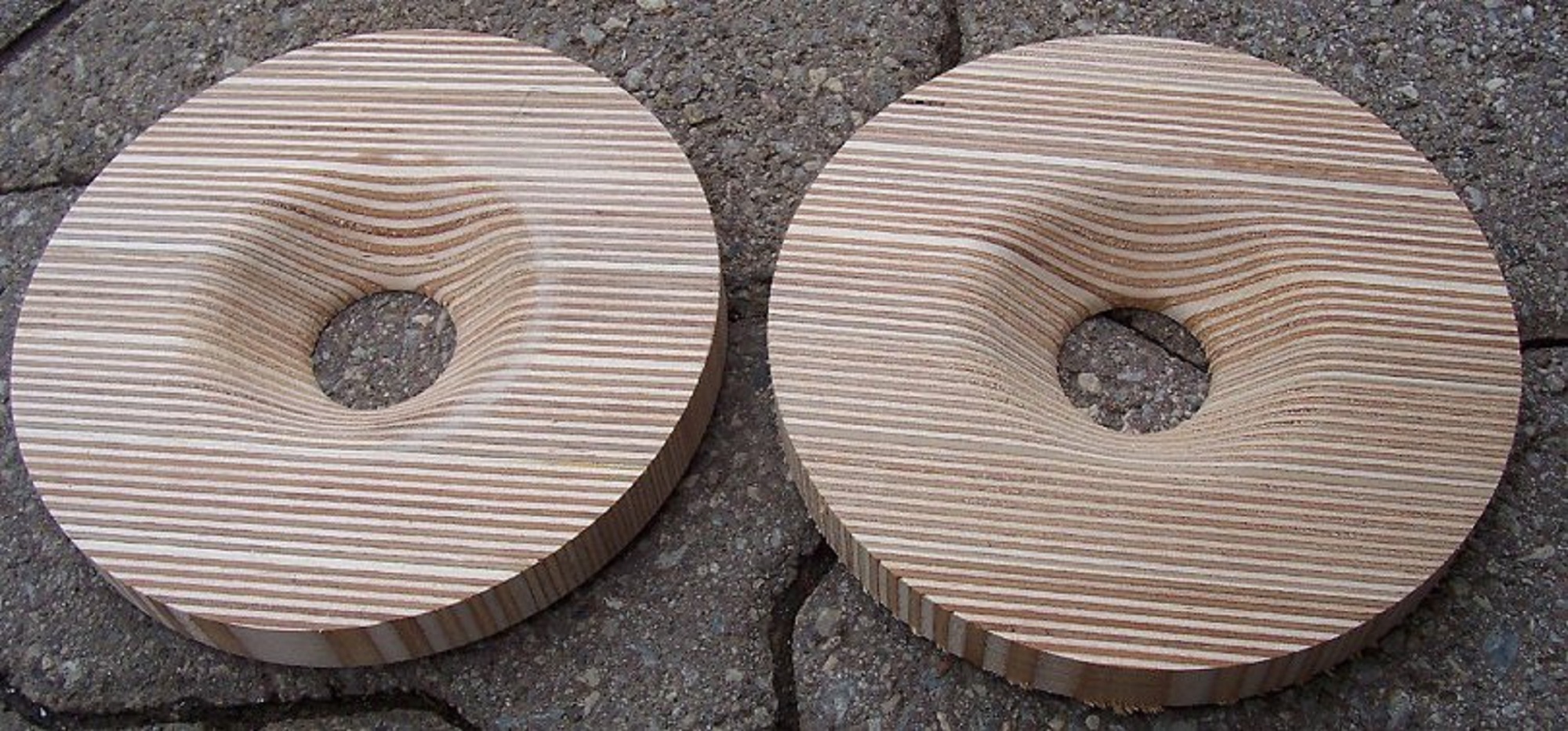

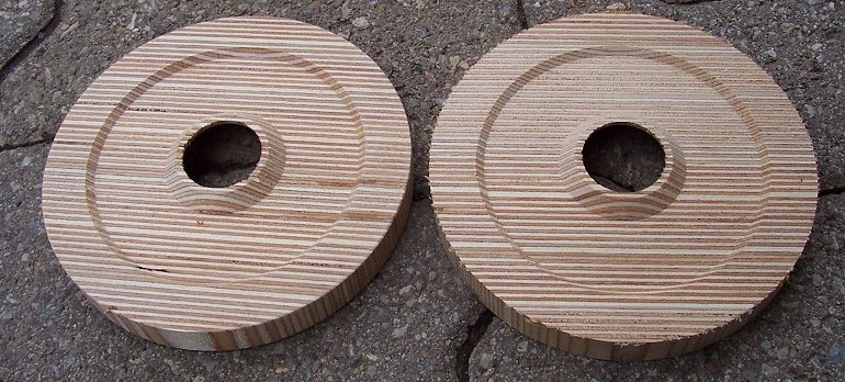

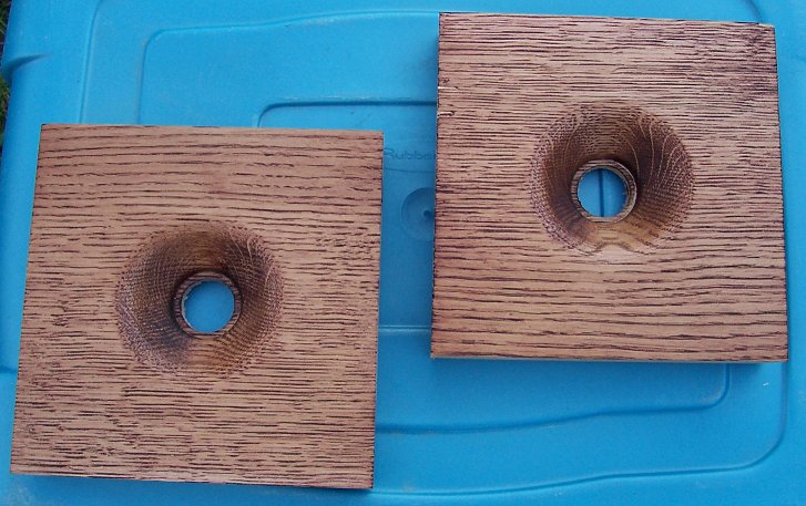

Actually I have been working at trying to come up with something in wood.
we have tried solid oak, maple, walnut, lacewood and plywood(24mm baltic birch phenolic ) end grain showing.
The best for coming out flawless is solid maple but not crazy about how it finishes but could be nice with the right technique.
The idea is that I would deliver the wood blanks routered to a perfect circle of the correct final diameter and machinist will complete the rest. My goal would be to try and get the price to no more than 100/pair unfinished or a least a sealer coat.
We are also looking into ABS.

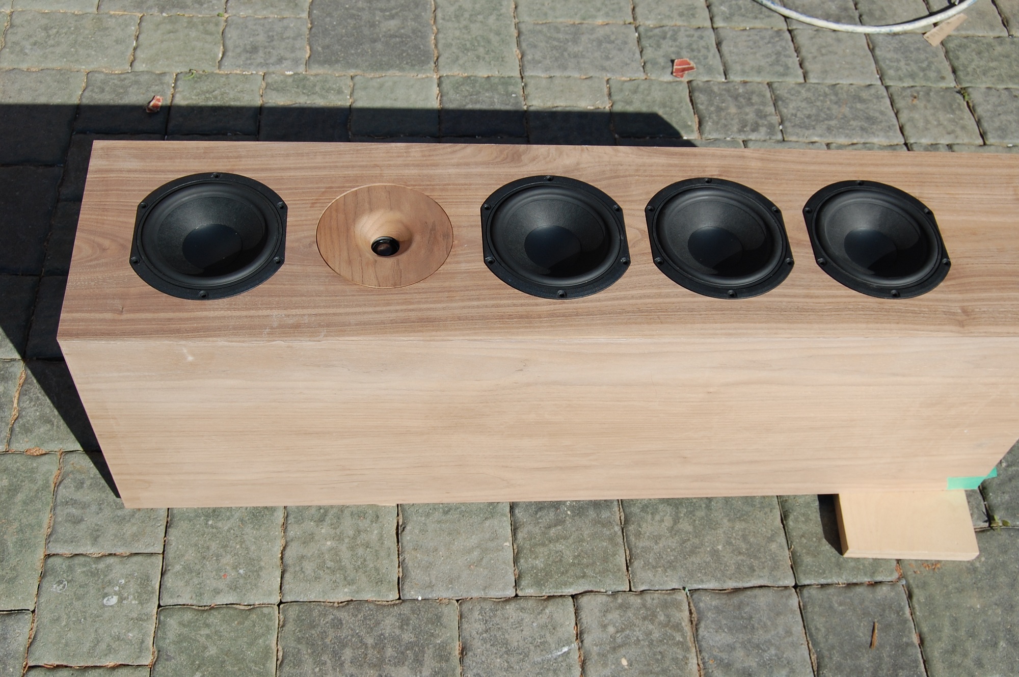

I'm also looking at another CNC'd device(have one now) to assist in Elsinore build but will talk to Joe first before I mention it..
Note on existing Aluminum Waveguide: Planning to listen to the difference between having tweeter mounted to back of Waveguide compared to subfront mounting.. Drill and tap four holes, space and mount tweeter accordingly. Subfront tweeter area is pretty beefed up so dont know if the Waveguide Stiffness would help..
