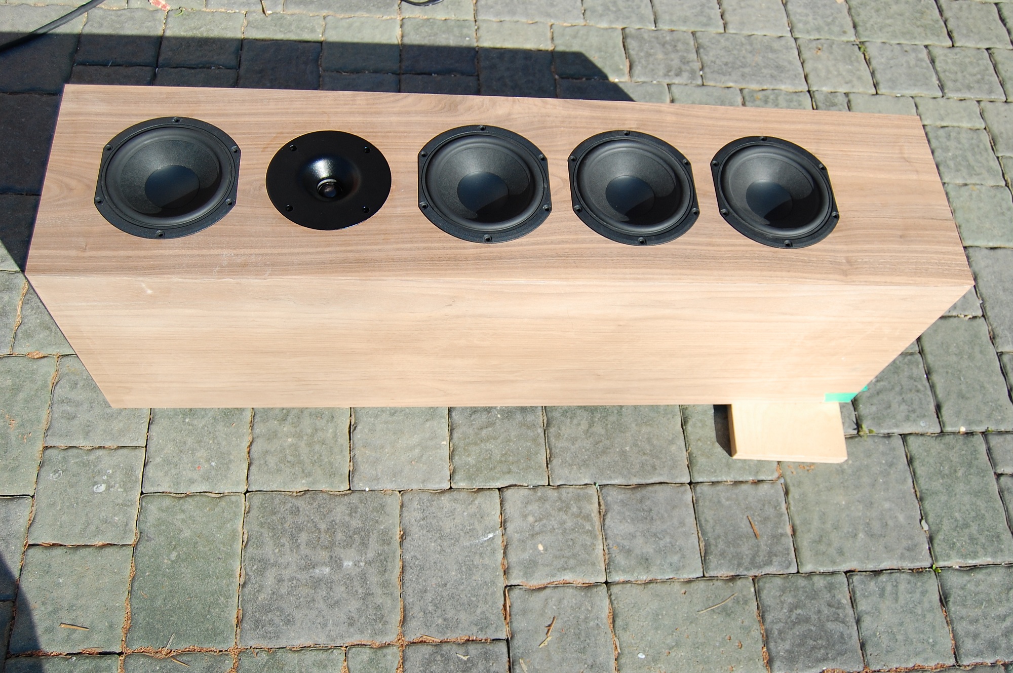

Are you attaching the waveguide to the tweeters or is everything held in by pressure (waveguide pressing back the tweeter into the cutout/stiffener)?
Tweeter recessed and mounted to sub front panel
Waveguide independently mounted to subfront with screws clear of tweeter.
Have to get the tweeter recess right so 3mm projection either just touches tweeter face or slight gap? Probably slight gap is best?
Some Waveguide fillers
Some one already mentioned it but think I'll try gluing in filler and then using filler around the edges. At this point I can level the the mdf and veneer over the front complete.
My fronts are 17.5 mm ply so have to recess Wg a little more into the sub front..
The tweeter looks to be significantly offset vertically to the waveguide in that photo, it it just stuck in roughly for a photo?
Good Eye. The filler is not glued in position in that photo, I just let the filler sit there. On my other pair I have both fillers glued on - I put the tweeters in the recess and aligned waveguides over the tweeter, then placed the fillers over wg. Then I drew 3 scribe marks on the filler and cabinet so I could remove the components and glue in fillers..

Can we see a closeup of where the waveguide meets the tweeter?
