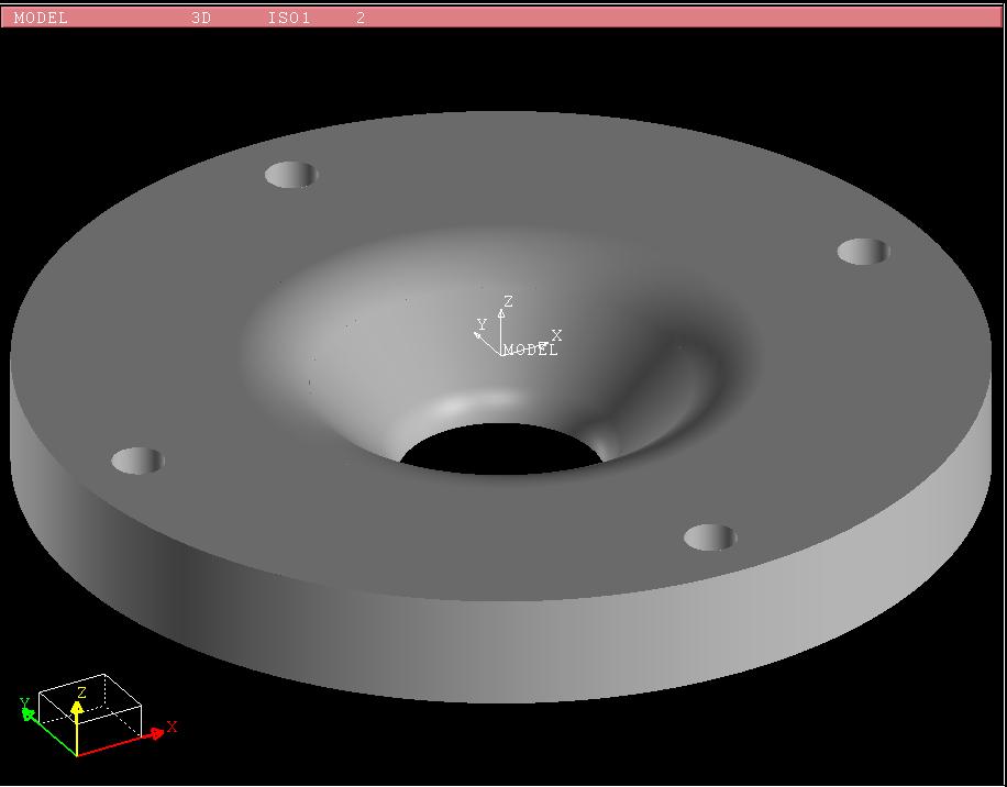

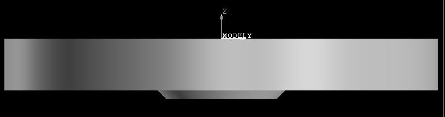

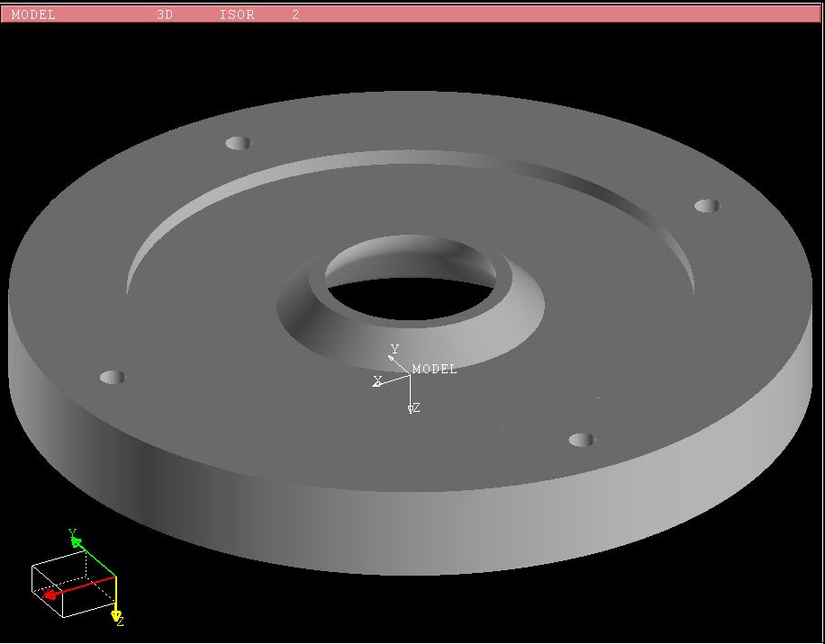

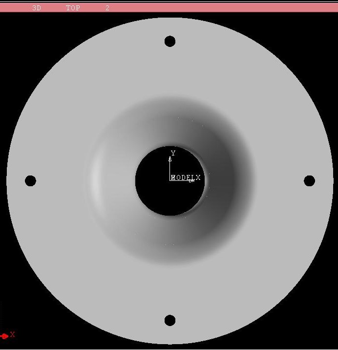

ALUMINUM WAVEGUIDES
I received a few emails while I was figuring out the details but please email again if you want a pair and I will keep track of things now.
The price is based on min 10 for CNC and paint.
Have 2 comitments now. Thank's Ben and Matt from Alberta.
Sincerly, Joel

Do the waveguides exactly match the mounting plate of the tweeter and does it have matching holes so that the WG and the tweeter are mounted with the 4 screws?
If so, that would be great.
How are the WG's finished? Are they black anodised?
The Waveguide is wider than the tweeter mounting plate.
The holes in the WG are halfway between the outer perimeter edge of the bottom recess and the outer perimeter of the WG.
The supplied wood screws are from Solen and designed for Diy speaker projects. They look like machine screws and have an alan head and recess perfectly in the holes.
The WG will screw into the sub front panel with new pilot holes. Screws go 18mm below WG.
Black Powder Coat
Hope this helps, Joel

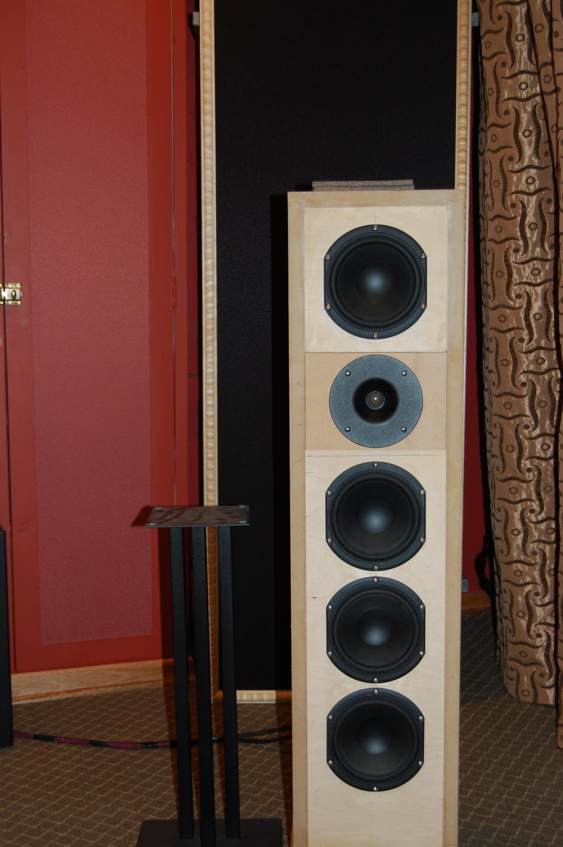

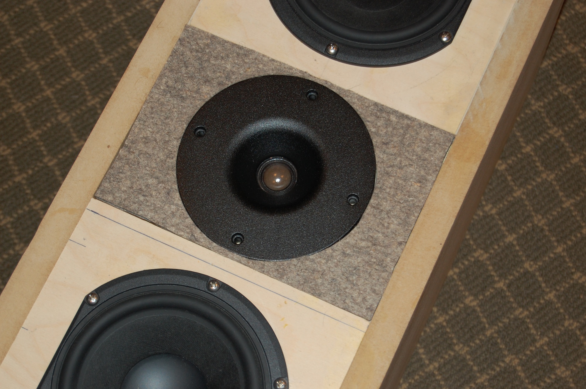

WAVEGUIDE FILLER
What about using the existing felt and cut out the hole for the WG?
Use both pieces, one for back fill(or wood strips) to keep it flush
Tried it quickly with some left over. looks pretty good but imagine it with nice felt, veneered cabinet and accurate trimming..
Joel

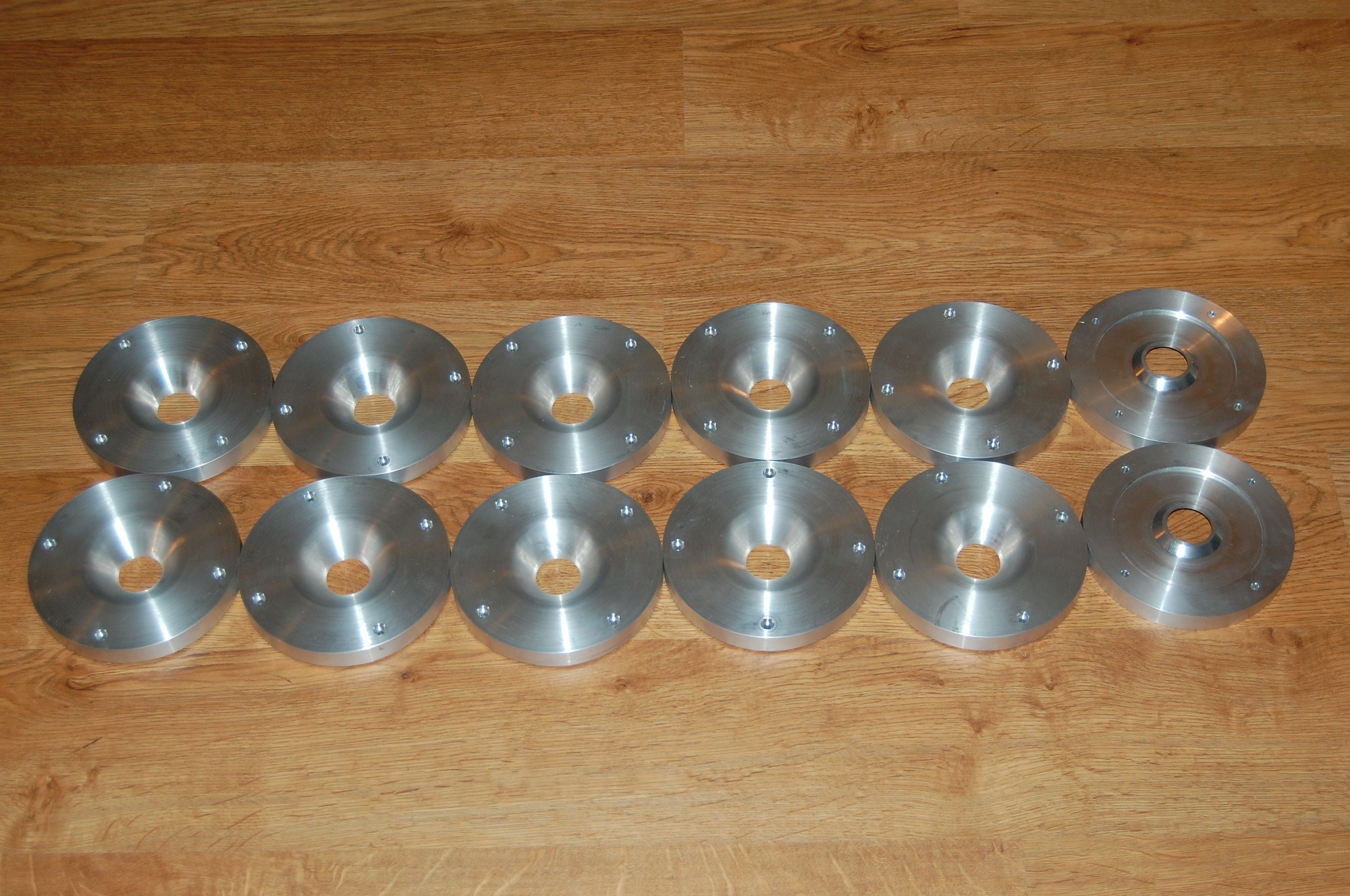

Don, Sorry I'm sure I didn't get your emails. I was checking frequently.
There was a few other emails but the machinist had to drive a bit to pick up the blanks so we had to cut it off.
12 Waveguides ready for paint. Drop off tomorrow

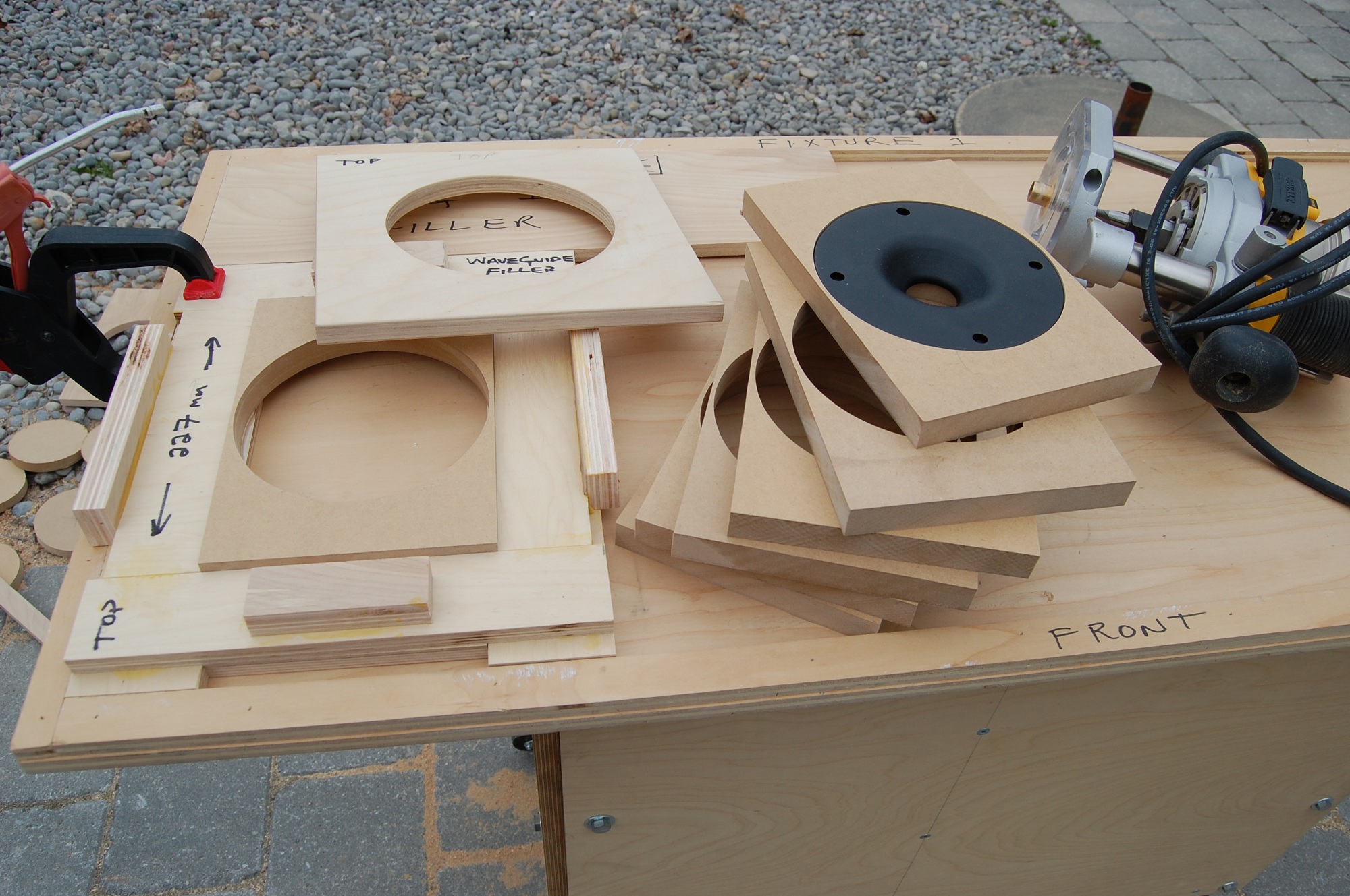

Some Waveguide fillers
Some one already mentioned it but think I'll try gluing in filler and then using filler around the edges. At this point I can level the the mdf and veneer over the front complete.
My fronts are 17.5 mm ply so have to recess Wg a little more into the sub front..
