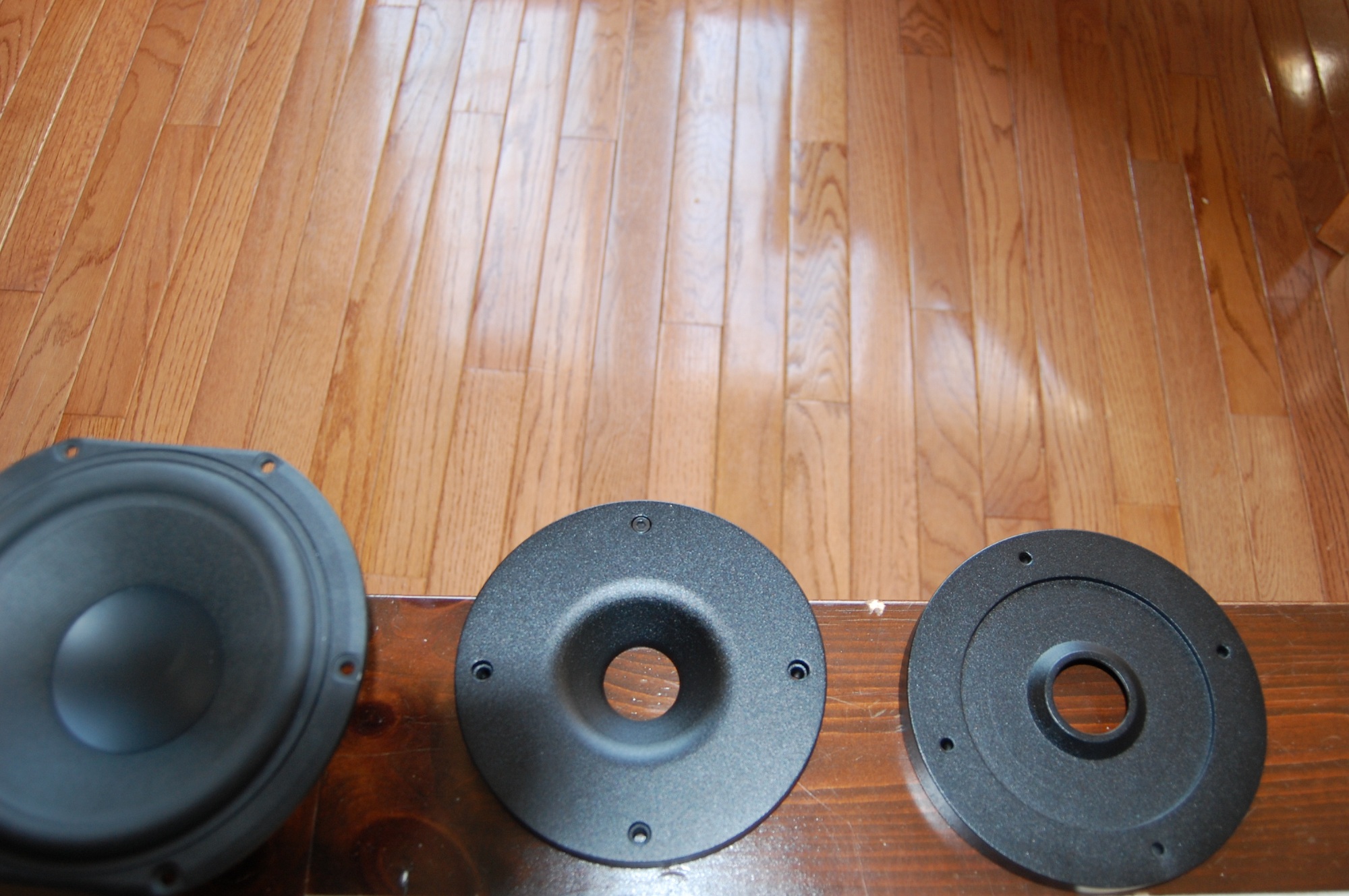

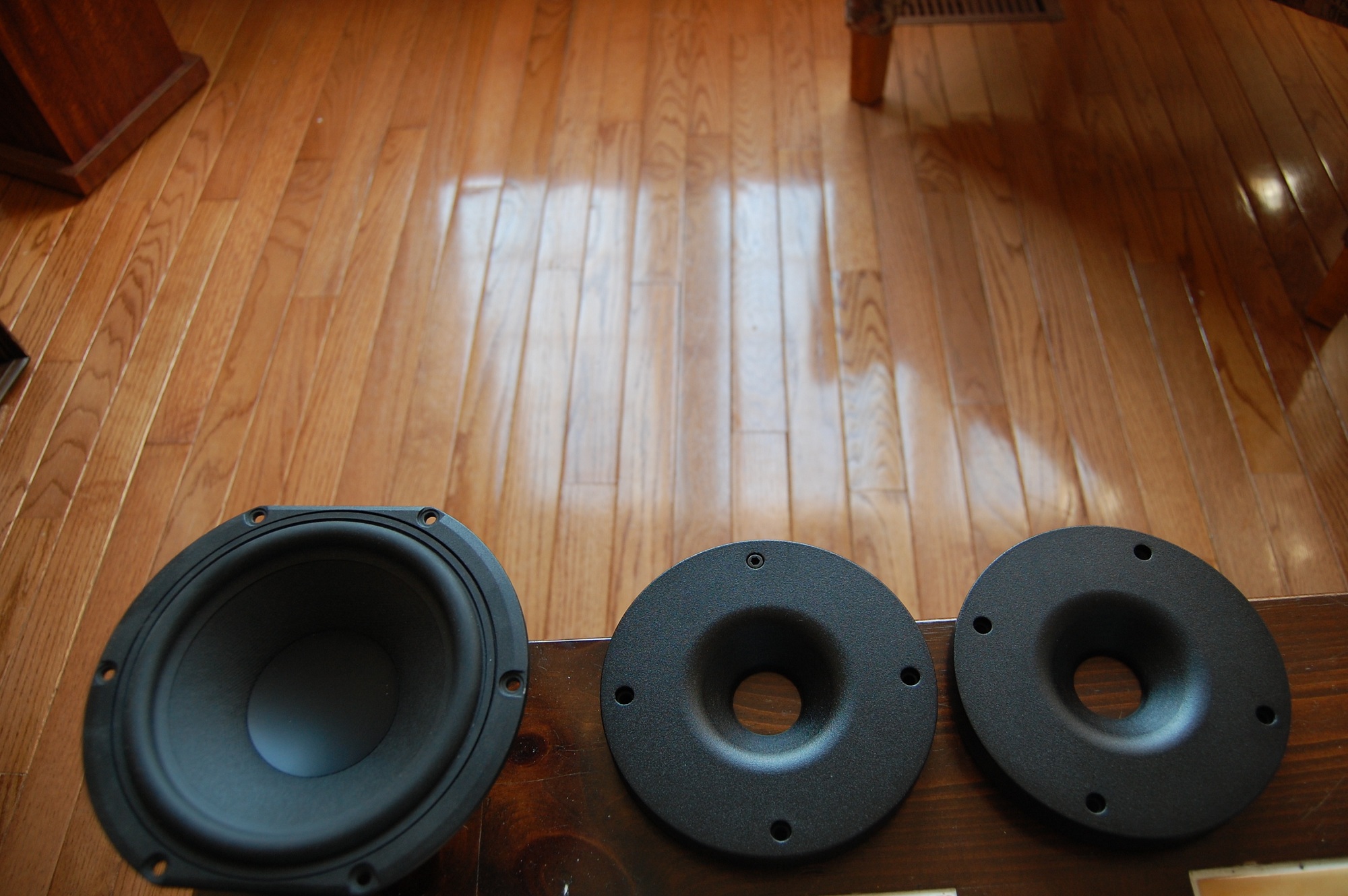

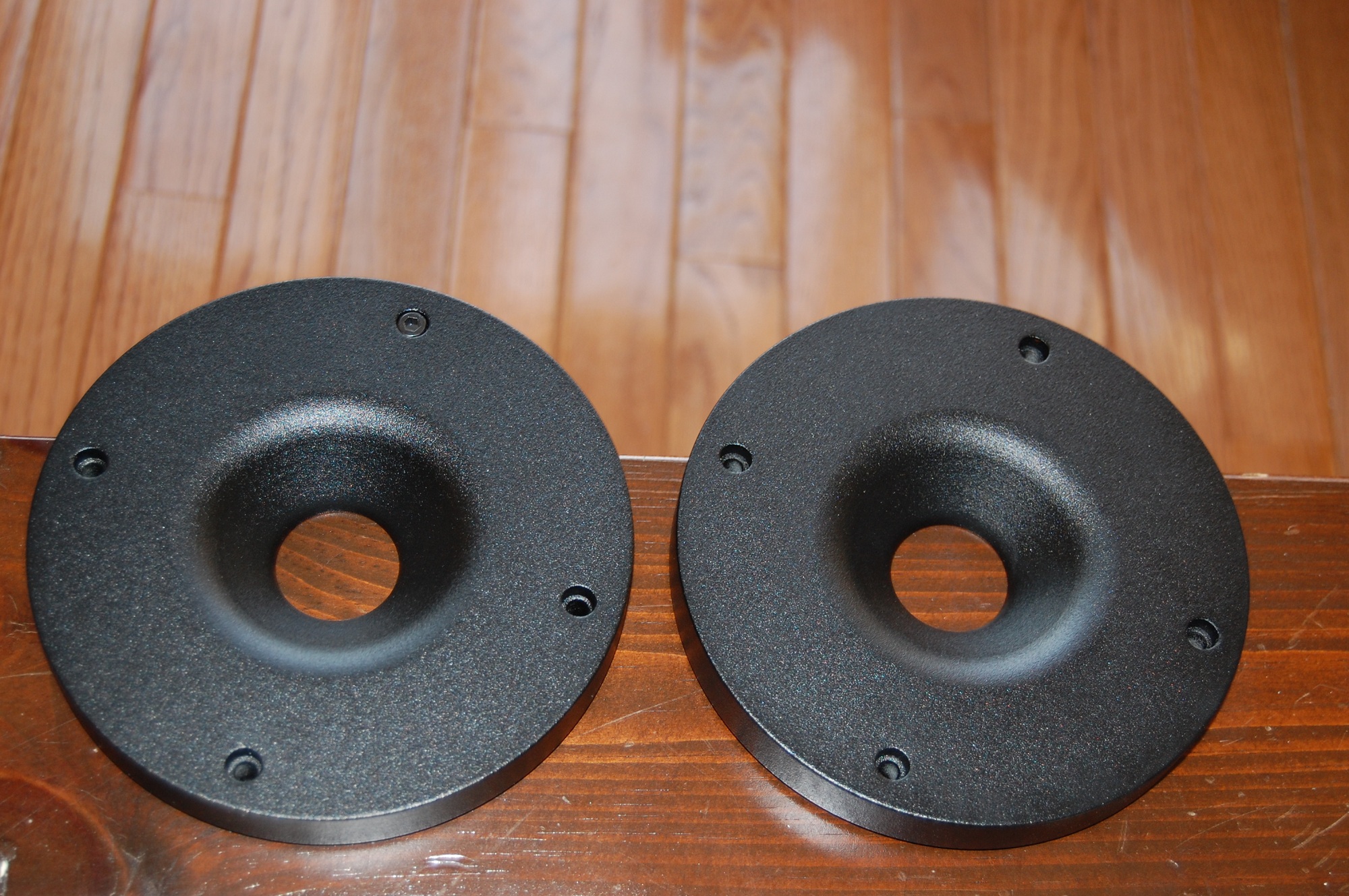

PAINTED WAVEGUIDES
I have to say they turned out rather perfect.

Joel,
The waveguides look great.
How might I fit them into a new build (assuming they are on offer)? Would I still need a filler board, or could I somehow flush-mount the waveguide in the top baffle.
That would look much better than the big rectangular cut-out that everybody has now (YMMV).

By the way: From the photos the waveguides don't seem to have the right depth. Are they 18 mm?

HI Lex
The thickness measured 18mm before painting. Painting has added .5mm so were at 18.5mm measured by eye.
I'm fitting mine without the filler. Veneering(raw veneer - .6mm) 18mm mdf should bring the waveguide close to flush on front. I'm using 18mm plywood that is 17.5mm so recessing the waveguide into the sub front panel can make it flush.

Thanks! I'm very happy with them. The pictures here show some light reflection that looks like a white speckle pattern but they're completely black..

Hi Joel,
At the risk of looking really stupid, I have a question:
Do the waveguides exactly match the mounting plate of the tweeter and does it have matching holes so that the WG and the tweeter are mounted with the 4 screws?
If so, that would be great.
How are the WG's finished? Are they black anodised?
