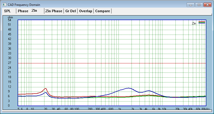

Let us take it one step at the time.

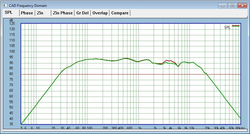

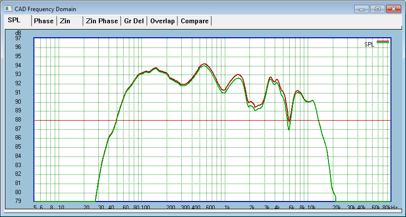

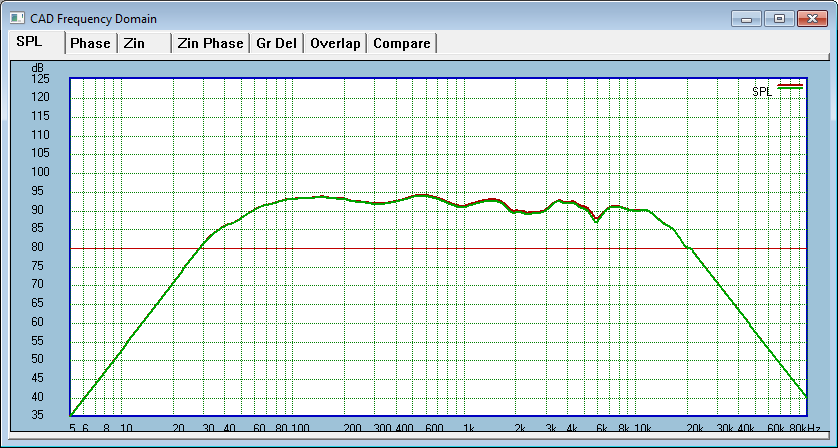

What effect will adding the 33R resistors across Voice Coils?
In fact very little difference in response. Take a look below, Red is without and Green is with.
Note this is 15 degrees OFF axis.
Note that there are two scales shown, my usual 5dB scale. The difference is easier when 1dB scale, but it looks uglier.
It won't sound brighter that for sure.

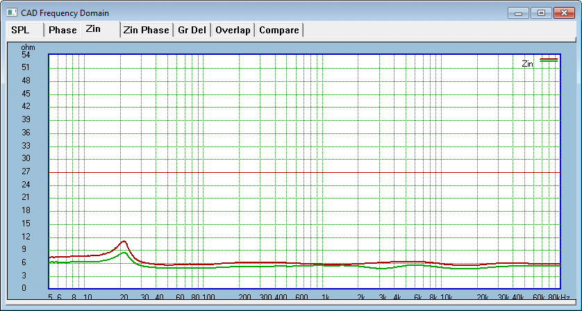

The end response will end up as per Bolser, but with a flatter Z and to me even more important, a flatter electrical phase.

Since you brought up the topic of retuning the conjugate for flatter(but lower) impedance, I thought I would mention our experience with it here.
As you posted, the measured frequency response was the same with the conjugate removed, or retuned. Only the impedance seen by the amplifier changed.

Fit the 33R resistors, you will need eight in all.
That might be all you need to try. The tonal balance will be more gently downward and hence less bright. But since excess energy is what led us in this direction, maybe the less averaged out energy above 1Khz will go some way to assist. No more required.
You can proceed to Stage 2:
This is now getting more complex.
1. Add 10R in parallel with L2 0.33mH
2. Add LCR series network across (in parallel) with MidBass drivers, values are 0.47mH, 8R and 3.3uF.
This will change things away from the "currrent" rule that parallel elements cause phase noise, whereas series elements has a chance to reduce it.
Please note that we are violating the earlier rule - but we will analyse what affect that may have, so please read on.
I may add here that I have an alternative design of the Elsinores here in operation. Everything is much the same, except the 6.5" driver is is less problematic than the HDS driver and the 4KHz exxageration is much smaller. But it also has dramatically lower VC inductance, in fact the effective inductance is near a quarter, so much so that the 0.33mH used in the Elsinores needs to be 1.5mH - so in what manner does this influence what is done here in Stage 2?
Because with the Elsinores, much of the inductance is internal (6.5" driver), the LCR and its affect on potential phase noise (we are talking about effects that will eventually be modelled correctly and hence we are guided by general rules rather than absolutes) with the 10R in parallel with L2, hence the added LCR is seen more by the amplifier (voltage source) than it is by the driver itself - its self-inductance acts as a bufffer. The alternative driver with less inductance, it becomes more problematic - but thankfully not here.
So the likelihood is that significant added phase noise is lower with the Elsinore HDS driver than in the alternative driver I have used in the alternative design.
What is also clear is that the High-Pass to the Tweeter and its Waveguide is left untouched. The much lower value series capacitor means much higher reactance between the VC and the voltage source. So around 3-4KHz, the Tweeter tracks the current better, even if the source is voltage. This I suspect is where any potential phase noise would have the maximum audible and negative influence. And this remains in place and I would say inviolate.
In summary, Stage 2 may well have a benefit that comes at a minimum cost.
Stage 3.

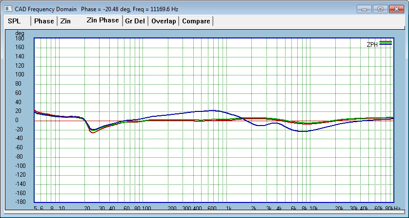

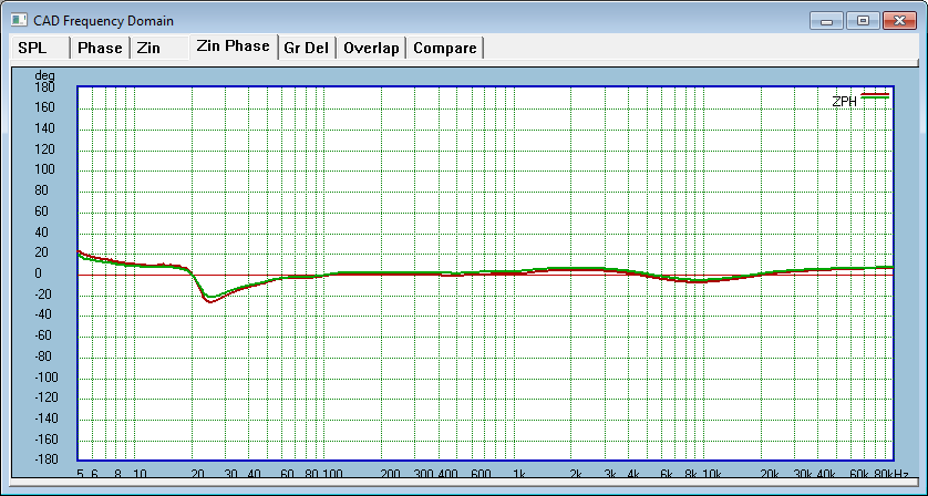

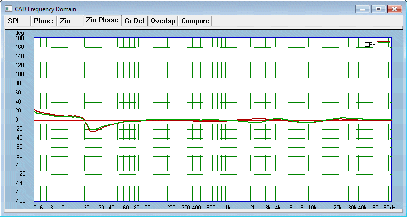

If Stage 2 is tried, then in my view the conjugate made up of L5, R3 and C4 should be changed. The values are:
L5 - change from 0.18mH to 0.10mH (a reduction that can be achieved by simply reducing the winding on the existing choke, but you will need a bridge to measure it).
R3 - change from 8R to 10R
C4 - do not change, but keep at 33uF
Next: See below as they will show graphs before and after.

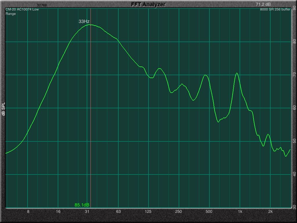

I wonder what results you,ll get for the port tunning using the mike and a low frequency sweep.
Probably something like this. :D
One is the left speaker and the other the right speaker. The calibrated mic is placed at the exit of each port. The audioTools FFT is set to average out pink noise for a couple of minutes (unweighted). I thought the pink noise worked a bit better than single/multiple sweeps. Certainly for establishing a consistent measure.
The configuration under test is with the standard 3 inch electrical coupling port extended by an additional 20mm. I first tried 10mm of extension and it did not take the tuning quite deep enough. The 20mm length might be a bit too much as I am calculating ~32Hz from the impedance measure. I am going to try out a 15mm extension and see how that measures.
For a nearfield measurement, that looks reasonable. The 500Hz/1KHz peaks are suppressed by the fact that the port is at the rear. Also, unlike sub-100Hz they are not emphasised by the room, so while they can look a bit disturbing, it's not that bad, seen a lot worse.
Of course, this tuning is definitely an area of experiment as these things interact with rooms etc, but overall response (2Pi) is meant to have Bessel like qualities as that suits a large number of rooms.
