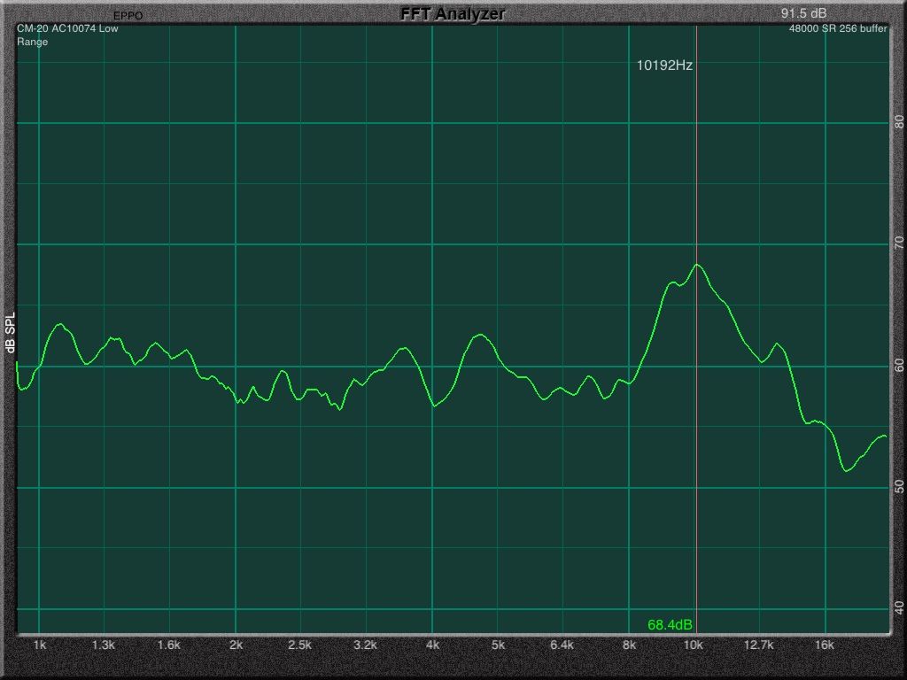

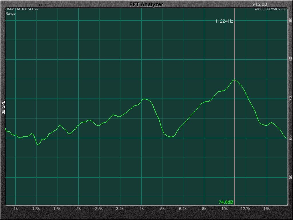

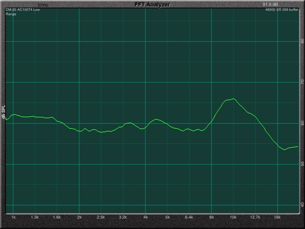

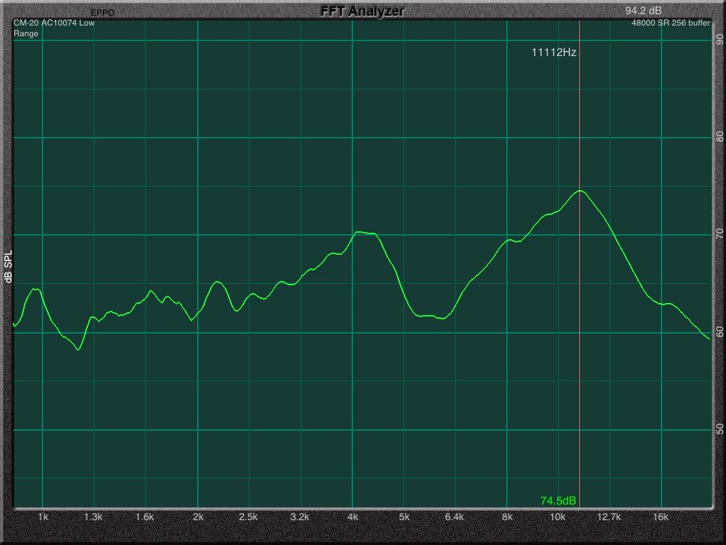

I would very much appreciate your opinion on another set of measures. While I am able to measure the excess energy at 4k that has been the subject of the past few pages, the excess energy in my build seems to be quite a bit higher. I am seeing excess energy around ~11k when measured with the speakers in position in the listening area.
The first two pics are measures of the left and right speakers respectively, with the mic at tweeter height, 1m back. Pink noise averaged over a couple of minutes. 1/3 octave smoothing. While the excess energy at 4k is present, it is greatly dominated by excess energy at ~11k.
The last two pics, which represent two views of the same measurement, one with 1/3 octave smoothing and one with octave smoothing, are taken at the listening area where I normally sit. This measures was taken with the mic above tweeter height (~1000mm above the floor or 180mm above the tweeter axis). The mic is placed ~3m back from the speakers and equal distance between them. The speakers themselves are ~2m apart and only slightly toed-in (perhaps a couple degrees at most). In this position, the 4k energy is a non-issue, but the 11k energy is still quite prominent.
Any ideas or thoughts on what might be causing this excess energy at ~11k? I am using 1.8uf at C1 with the rest of the components as specified for the Mk V crossover. Could this just be room effects? Associated electronics? Something else entirely?

I don't expect "room effects" give you a greater than 10 db peak in the treble range! Certainly not that peaky?
ARTA has a free demo mode, could you, perhaps do something like this?"
Place the mic about 3 inches away and take measurements at just low enough level so you are sure the mic is not clipping. Do that for the tweeters and each of the upper two woofers.
You could try both sin sweeps, and MLS measurements. Let's see what kind of peaks we see then?
energy at ~11k.
Are you using the calibration file for your CM-125 mic?
Many 1/4" condenser mics have a peak in the 10kHz - 12kHz range.
Perhaps that has something to do with it?
Do you have another loudspeaker with known flat response you can measure to see if the peak is related to the Elsinores or your measurement setup?

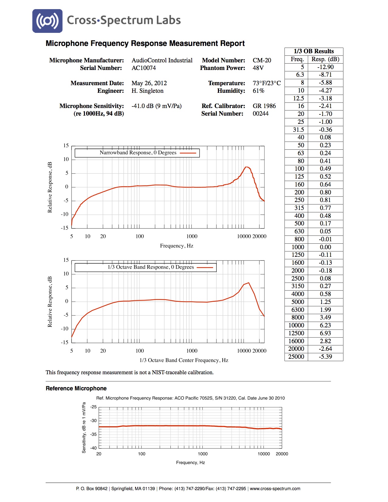

Yes, I am using the calibration file. That said, there appears to be a bug in the FFT software of audioTools as it is not appearing to apply the calibration file(s) to the measurement. I have taken the measures with the calibration file(s) enabled and disabled and gotten the same results. As bolserst has pointed out, the mic has a serious peak at ~10-12k. The calibration file would have applied a calibration offset of up to 7.3db over that frequency range using the 1500 point narrow band calibration file. So, something is amiss. I have filed a bug report with the software vendor. We shall see what they say.
Thanks again for taking the time to make suggestions. They really helped to refocus the resolution to the measurement process.
BTW, manually applying the calibration factor makes those measures look far, far better. :)

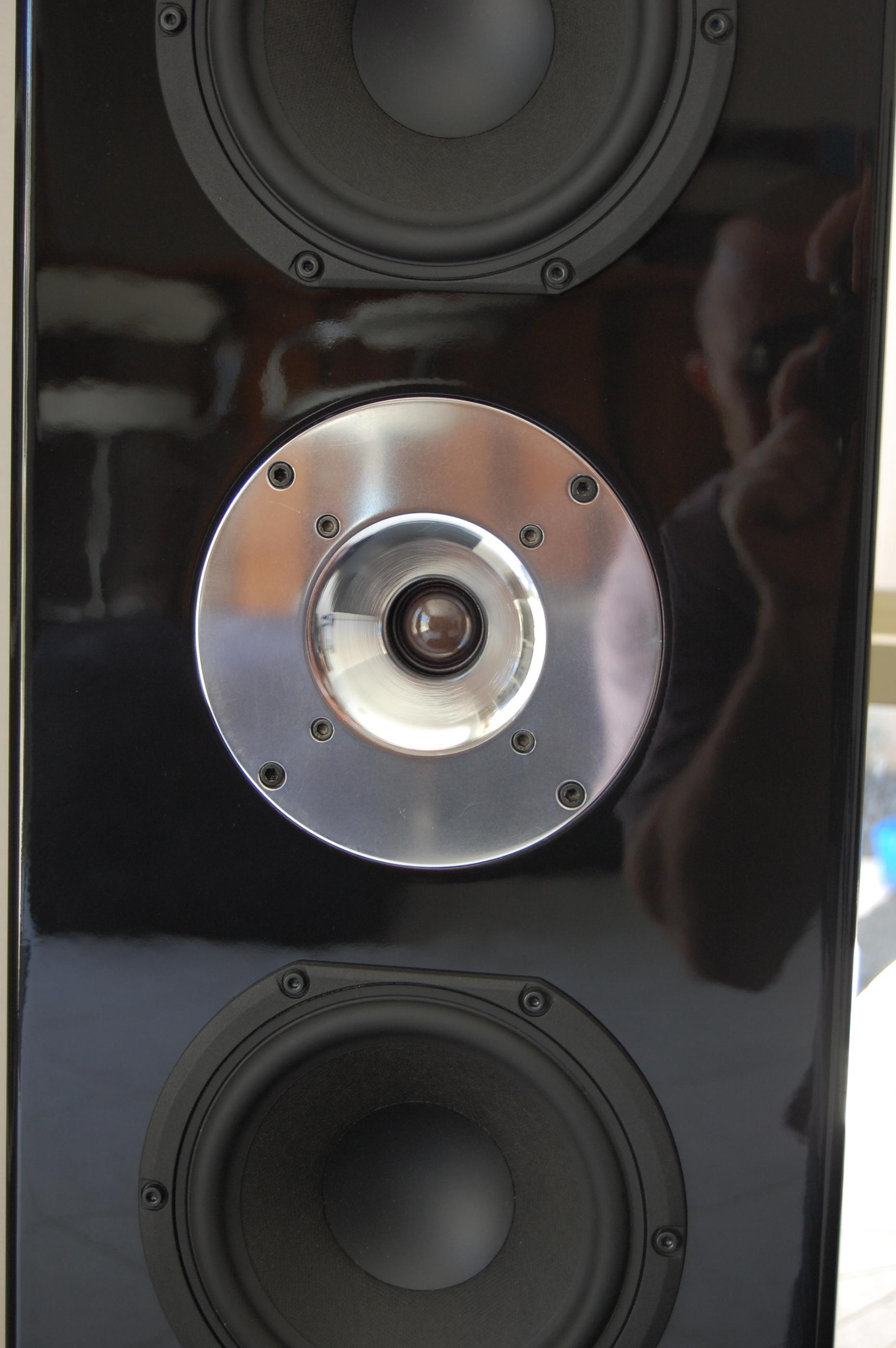

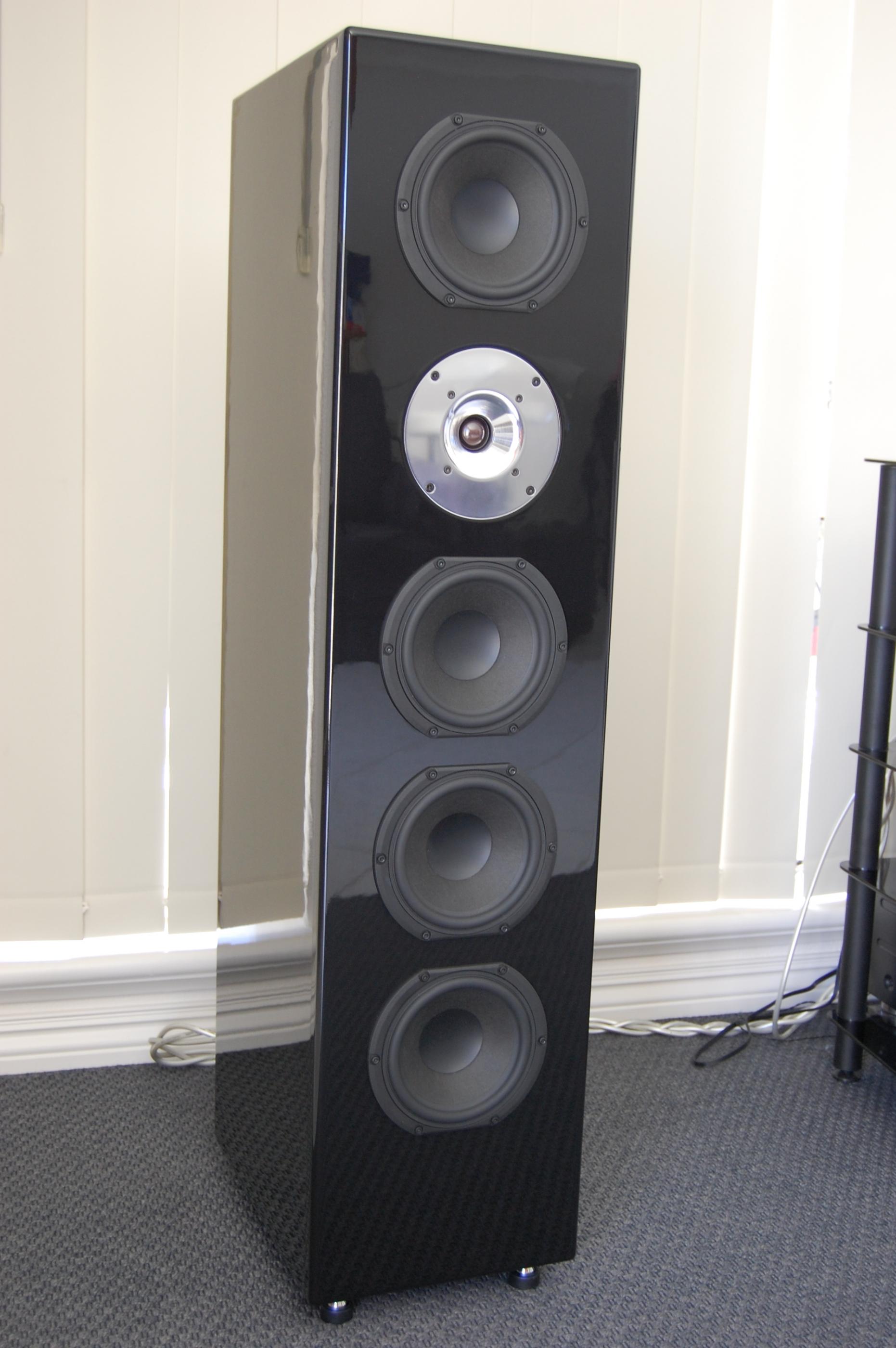

Back in Black......... 4 coats of black 5 coats of clear and polishing.
Lots of beers to hand polish the wave guides turned out good,thanks again Joel.
Stunning work spoonted! Absolutely beautiful.
Piano black speakers always have a certain elegance about them. They really turned out great.
I can only imagine the number of beers that gave themselves to the cause in the polishing of that waveguide! :eek:
WOW!
Wish mine looked like THAT!!!
Cheers, Joe R.
Thanks for the kind words guys.
