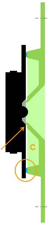

Working on the mold for the WG make me run into things. One about the gap some of the posts prefer. If, I say if, we design the WG in such a way that IF (but only then) the TW is mounted with a distance gasket (blue in picture - only shown as a square, but are going all around the beam directly towards the TW) there will be an opening gap (by the orange arrow) into a small "cabinet" (where the orange C is). This will make it possible to either fill the gap with another gasket OR don´t. If one don´t we have the possibility to play with the little "cabinet" and different fill within it (we are talking small). Anyone with similar experience?
Cant say I follow completely but maybe your saying start with a mounting gap and then one can move it in to touch and out as if prefered..
