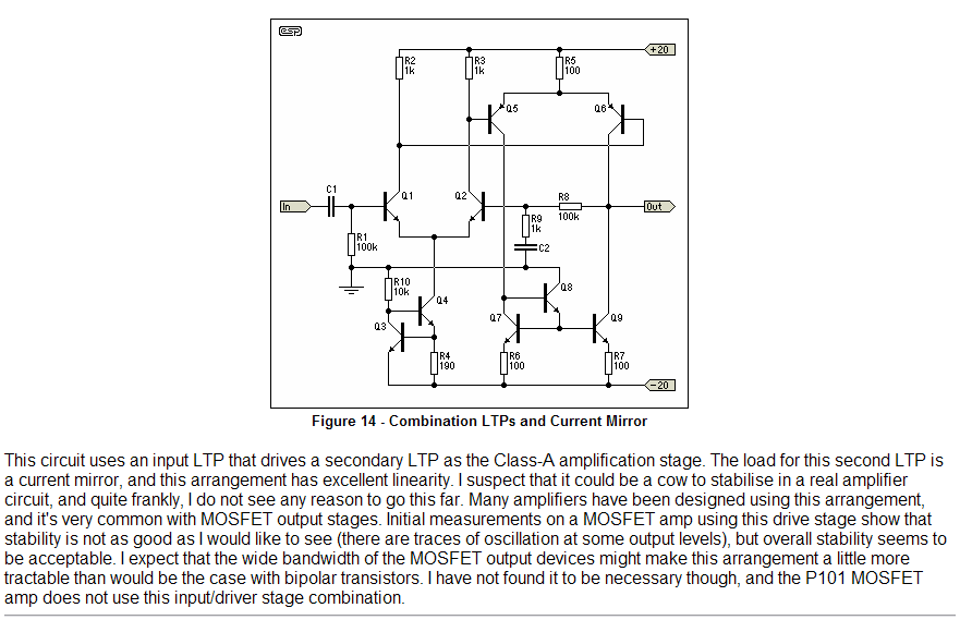

Funny, I don't see it on the Symasym 5.3 schematic.
Symasym, even with it's compensation, seems to be inherently unstable. I have tried seven ways from Sunday to tame it in my sim, but to no avail.
Here's what Rod Elliot has to say:
Here they are..MJL
I only used the symasym as a reference
design.
mike B. uses 330p/47k (gross compensation to reduce HF gain)
and only 1 Cdom (100p)at the "back end"
of the vas(that has the smell of instability.. doesn't it?)
I believe both Douglas self and rod elliot either
didn't want to put forth the effort or saw the design as too much
of a challenge for the average hobbyist as one can plainly see in both their writings.I notice R. elliot contradicts himself in his
statement saying it has better linearity but no added benefits
..what??? he fails to mention equal loading of the LTP , then
he says it "might " show instability with certain OP's
or at clipping (he describes all amps here) , but to contradict
himself again, he says stability would be acceptable with a BJT OPS.. .
Now on the other end of the spectrum ampslab's two "flagship"
amps (bi120/240) are impressive with a topology similar to
mine. Sim mine exactly,you will see no flaw (all the way down to
33pF Cdom/1.2Mhz UG) Below 33pF I see slight ringing but even this can be
reduced or eliminated by playing around with OLG
and phase.(ampslab "magic" LTP RC bridge)
