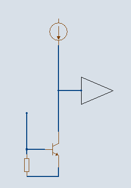

I have already spiced and optimized lineups suggestion,
removing the 10k and upping the emitter resistor on the CCS
to get 1.7ma in each differential.
What I found to be the case is that doing this decreases OLG in the LTP , so I replaced the 10k with 1K and decreased the emitter degen's to compensate.
Here is the unity gain curve of the FA1...
What is funny, is that C7 ,which is removed above..(15pf on the NFB , adds a
pronounced hump (like a 2 pole response) on the amp.
what is the use of it??? I have removed it from the "real world" circuit, no oscillation.
Another thing that is surprising is that balance can be achieved in the LPT, CM ,and VAS by simply manipulating open loop gain.
(without the diode)....
BTW , I now use 2SC2682 for my CCS (120V/100ma device)
Just playin' with a monster OP-AMP....

When you reduce LTP Current, you lose some gain. And also Bandwidth = speed.
To get much gain + bandwidth we increase currents.
But at same time increase Current will increase noise.
A good compromise is often 0.5 - 2 mA in each LTP transistor
Regards
Lineup

by- DX - I am searching for knowledge... you folks with all that passion will let something to me to colect.
I too, search for knowledge, the magical sound of the bootstrap
is next on my "hitlist". I will model the original DX amp to
steal the magic sound (not the circuit) of that little cap and
put it into the VAS of frugal 2 .
The unity gain plot is very interesting, every amp has its own,
like a "fingerprint". DX amps ,frugal, Quasi, all different. What
happens at HF affects how an amp behaves in the audible
spectrum and how reliable /stable it is...
Yes current for speed, but emitter degen +- resistors drastically affects OL gain in both current mirror and LTP.by lineup --When you reduce LTP Current, you lose some gain. And also Bandwidth = speed.
working on it now...
OS
yes, you are doing good progress
now you have good tools to evaluate before you start building for real
emitter resistors are both for good and for bit of sacrifice
-large value improves linearity and reduces distortion
but takes away a bit of gain
-smaller values or no emitter resistor gives maximal gain,
but will give higher distortion
... there are tradeoffs
current level is both for good and for bit of sacrifice
-large currents gives higher gain + bandwidth
but also higher current noise in transistor
-small currents give low noise
but not so high gain and bit lower bandwidth, slewrate
no global feedback, or lower global negative feedback
often have to use larger emitter resistor values to reduce distortion
and make use of less gain in each transistor
... so instead comes the need for more gain stages, more transistors
in order to get the wanted total gain
in a global feedback amplifier we can not use too much gain in input stage
because this stage will determine so much of the overall quality via the feedback
this is why often only like x10 to x25 is used in input stage
.. even if these transistor can have very high gain capacity
using resistors to reduce the gain to a reasonable level in input
gives high linearity and low distortion in the important input stage
but at the same time we want not too little gain in input
because first stage have a great influence of the total performance
while for global feedback amps the VAS stage can have very high gain with not very linear operation
gain here can be several times 100 or even max of the VAS transistors possibility
This is the art of making good amplifiers.
Making the right decisions. About what we can scarifice a bit of.
To get more of the wanted quality.

Using LT (but not believing in it fully) to augment the "real world"
can really make for good sounding amplification (and reliability).
Not linear, huh?? Model my amps, model everyone else's amps,
model "secret" amps that are IP (don't ask
Since we listen to the VAS, (OPS just buffers, except for CFP's)
this seems to be a very important aspect to good sound.
With frugal 1 tweaking the VAS (linearizing) is just gain/current/
compensation..
[red is output, blue/ green are VAS devices.]
I will soon update all schema's of frugal 1 threadwide to reflect
on a very good amp with absolutely no errata. (kicks butt
I had to play around with the bootstrap aka..BS "mystery", and hope to see the "magic" . A while back AKSA explained to me the
theory but I just had to know more. The bootstrap's natural "rolloff" in gain at HF is indeed interesting..
[This is the frugalamp with a bootstrapped current source]
After seeing this on my sim I pulled out the MJE340 and in
went 2 3K3's and a 100uf cap. The character of the amp's sound
changed , especially in the bass department.
Due to the very good design of this amp the highs were still
clear as a bell with no noise or turn-on thump.
All this was interesting, but I still wanted the better slew and
control of an actively loaded gain section.
[Again , Red is output - green/blue are VAS devices.)
That's why the FA2 (above) seems to be the "best of both worlds" . All the fuss about current mirrors, "secret diodes",
It's HOW the input stage is loaded that makes all the difference

It is not very unusual to see VAS like in attachement.
In fact, I guess you have seen plenty of them.
How linear is this VAS?
If it is linear, then it would work well as a no feedback standlone amplifier.
But .. at least me, should not want to use it as my amplifier.
Regards
Lineup

Seems like you do not agree with me. But you are not clear here.
My original thought was, that VAS stages can sometimes be very un-linear .. in global feedback amplifiers.
In contrast to the input stage,
where we can not temper with linearity too much.
Even if using plenty of global feedback.
