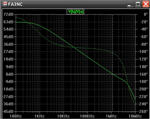

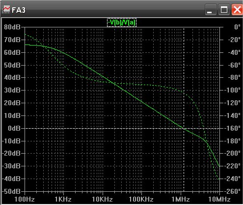

It sure seems faster, at least in simulation , as far as dropping
the cascodes, another $1 does not matter Fa2 had 6 VAS
trannies and the board was not to hard to layout.
With the cascode VAS Isn't faster, because that is mainly determined by Cdom capacitor
But , results show it is both faster and has 4db more gain..
First post shows response with cascode..
Second without...
square wave also reflects this change..
OS
No cascode..
UGP is 100Khz below first plot ....slower.
Overall gain is 62 vs 66 with cascode.. phase remans the same..

By wojtec - What if, after dropping cascodes, You decrease Miller caps to have the same gain crossover frequency?
Thats the funny thing, without the cascodes I can only
lower Cdom to 47pf before ringing on SW.
At that value unity gain is only @ 700k.
With the cascodes it stays stable to 33pf and does a 50k SW perfectly. The linearity of the vas is improved, especially
at HF. At this level unity gain is 1.15mhz.
In a third test I added the "magic resistor" 😀 (47R)
and used a 27pf for Cdom by lowering OLG a little.
So the effect of the cascode seems to be quite beneficial
electrically , as far as sound , I guess I'll have to build it.

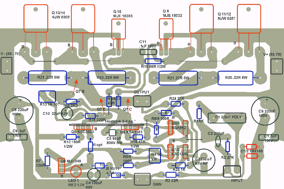

As promised to Danielwritesback (I keep my promises), here is
the FA1 COMPLETE DIY package.
Anything I do here from now on will be complete, WTF..
if you can only discuss it and not build it..it's not DIY,
just blah,blah,blah..🙁
It contains LTspice .asc, models used (ksa/m/njl),PCB and
parts layout (pretty board),BOM.. All triple checked for
accuracy. http://71.203.202.83/pdf1/Electronics/Projects/Audio_amp/Frugalamp/
Go to my "WWW" to get individual "works" and updates..
(or any of my other TB of stuff..😀
Direct link to frugal folder.. file is FA1_full.zip..
a preview below..
OS
Happy- happy New Year to all :Pirate: :Pirate:
