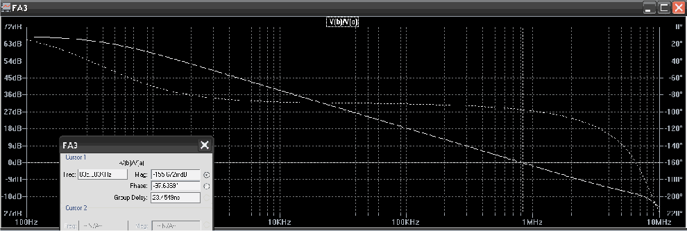

All done modelled KSA 700/800 Hfe -3500-10k..
here is the damage..
Gain is 5db more ,phase is the same...
but the balance is "SWAG"ed as B.cordell puts it..
By the way, most Ksa 1381's have a Hfe of 500+
(almost a darlington) I played with different Re degenerations
What is amazing is that the loop gain plot barely deviated
even with this gross modification.

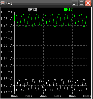

But this plot is the bummer.. the balance on the LTP is destroyed,
going from a few hundreth's of a mA to tenths..must be this
holman topology as the reduced load should not of done that..
I'll have to play around more.
unbalanced plot below...

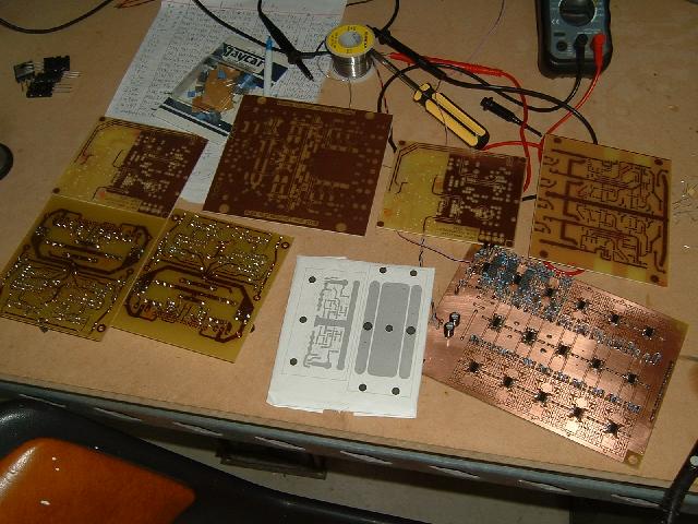

Just for my own enjoyment (but to the obvious distress of some) I’ve spent considerable time developing esoteric designs with performance in target areas to match the component count.
I’ve optimised these designs in sim, tested them on the bench and shared key aspects of the circuit operation here numerous times at length.
Documenting the construction of such designs here to any degree mostly has the effect of inciting presumptuous and resentful BS from pseudo-technical hacks and subjectivist whacko’s, so I don’t bother much with that any more.
BTW, I can assure you that there are plenty of PCB layouts and completed assemblies. In fact you can see some of the current production run in the pic below.

G.Kleinschmidt has attached this image:
BTW very nice esoteric board .. do you use the laser printer/
toner--HCL method as well??
OS

The boards are made with a UV light box and transparencies; printed on an A3 1440dpi industrial inkjet at work when the boss isn’t looking.
