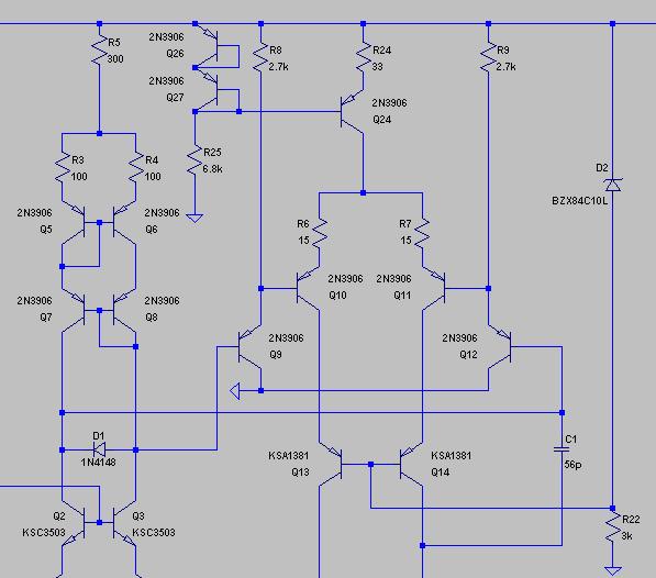

Heres the latest greatest, it sims better than FA 1...
I will make board tomorrow,
We will have balance....
OS

A few immediately obvious errors (as is is it won't work, so don't trust the sim too much).
There will not be enough voltage drop developed by the LTP current mirror to forward bias both series Vbe junction of the EF buffered VAS. Also, tail resistors are generally not bypassed.
Attached below is screen shot of a design of mine with a similar VAS. The LTP current in this case is 10mA. To get the required voltage headroom R5 is inserted. With this kind of arrangement the AC signals at each side of the LTP current mirror are not balanced. This is why I used a current source for the differential VAS tail; to avoid common mode distortion.
Clamp diode D1 is also necessary to limit the differential input voltage applied to the VAS when the amplifier is clipping.
This VAS arrangement requires a separate (higher voltage) supply rail from the output stage also.
I found that this arrangement (despite the odd look) works well with very low distortion. Have fun :spin:

Just an observation, but the voltage gain of the inverting side of the input pair is very low compared with the non-inverting side. because the dynamic impedance of the current mirror input is low, compared to the output impedance.
It will work, but you aren't really driving the VAS with equal / balanced signals.
Agree strongly, usual solution is to delete the CM, replace with resistors. Works very well providing stage current is well controlled and LTP base bias is equal both sides with good beta and impedance matching.
However, this will alter OLG of the LTP, in turn changing compensation by reducing fb factor. You will need to reduce the lag compensation to accommodate this change.

Lag compensation is a means used to pull back OLG by the pole frequency to avoid instability. Typically it's a cap between collector and base of the VAS device(s).
In your circuit you have used 47pF on one side only. If you dispense with the CM on the LTP, you will reduce OLG, and somewhat relax the compensation. I would be thinking about making it symmetrical, that is a cap on active AND drone side.
Try for equal values at first, then do some simming for lower values on the drone side.
Further, you should consider around 47nF instead of 470pF for C14 on the drone side....
Hugh
