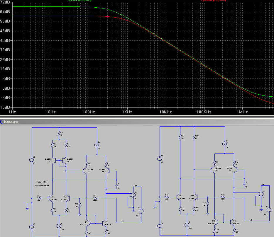

No it isn't right. With miller (lag) compensation increasing the open loop gain by decreasing the loading on the long tail pair does not change the unity loop gain frequency or stability – it decreases the open loop bandwidth.
Attached below is a simulation of two differential VAS op-amps (with the same 68pF miller comp cap in each).
Op-amp A (green trace) has the current mirror LTP. Op-amp B (red trace) has a pair or resistors instead.
So no, by getting rid of the current mirror you will not be able to get away with a smaller miller compensation capacitor.
If you wan't to get away with a smaller miller comp cap then you will have to reduce the LTP's gm by increasing its emitter degeneration. This is fundamental.

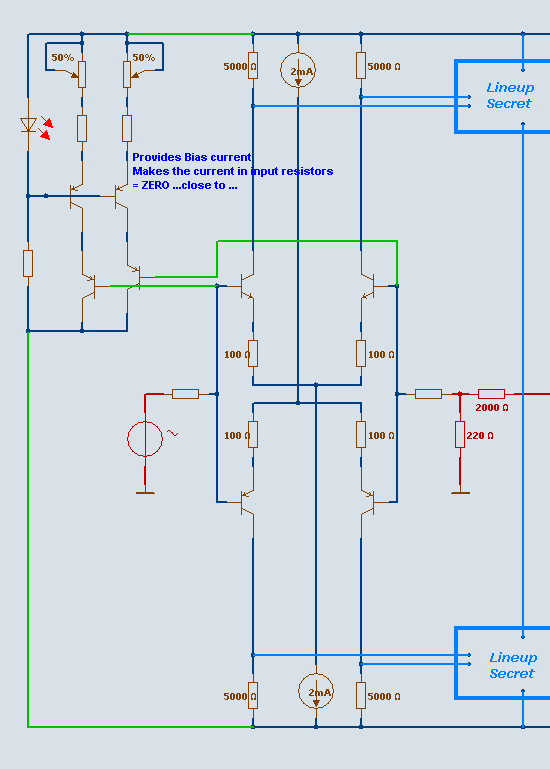

I see you use150R emitter for input pair.
At 2.2 mA you have drop >300 mV
If you read D. Self blameless input stage, you see he have 'only' 68 mV drop at one case.
This would be like you using 33R.
It is good to have a bit higher gain in input stage.
Because this is high quality gain = Fast transistors. low noise and good linearity.
Lower your emitter resistors from 150R to 33R / 47R
will increase Gain in first stage with a factor 3-4.
I am sure you studied my attach circuit very closely
but here it is again
I have 4 input transistors. Each of them is operating at a gain a bit less than x50. (5000 Ohm /100 Ohm)
As I run them at 1 mA, the drop across emitter resiistors is: 1 mA x 100 Ohm = 100 mV
I do not know if my input stage contributes 4x50 = Gvolt 200
Or if the contributed gain is only x50.
Glen, you can tell me, please. thanks

Thanks , vynuhl.addict, I'm building the sim now. Just to see if I'm in the ballpark.

ostripper said:Lineup, you mean MY emitter degens??? Put in 47R to give more gain?? I'll try it.
Ugh. Did you read my post 111?
If you change the emitter degeneration from 150 ohms to 47 ohms you will need to increase the miller cap pretty much proportionally (not "slightly") to maintain the same unity loop gain frequency (unless you increase the closed loop gain ~proportionally instead, which you likely would not like to do).
Glen

OK. I'm using a year old + version of LT spice (to lazy to update because the downloadable updates take tooooo long
