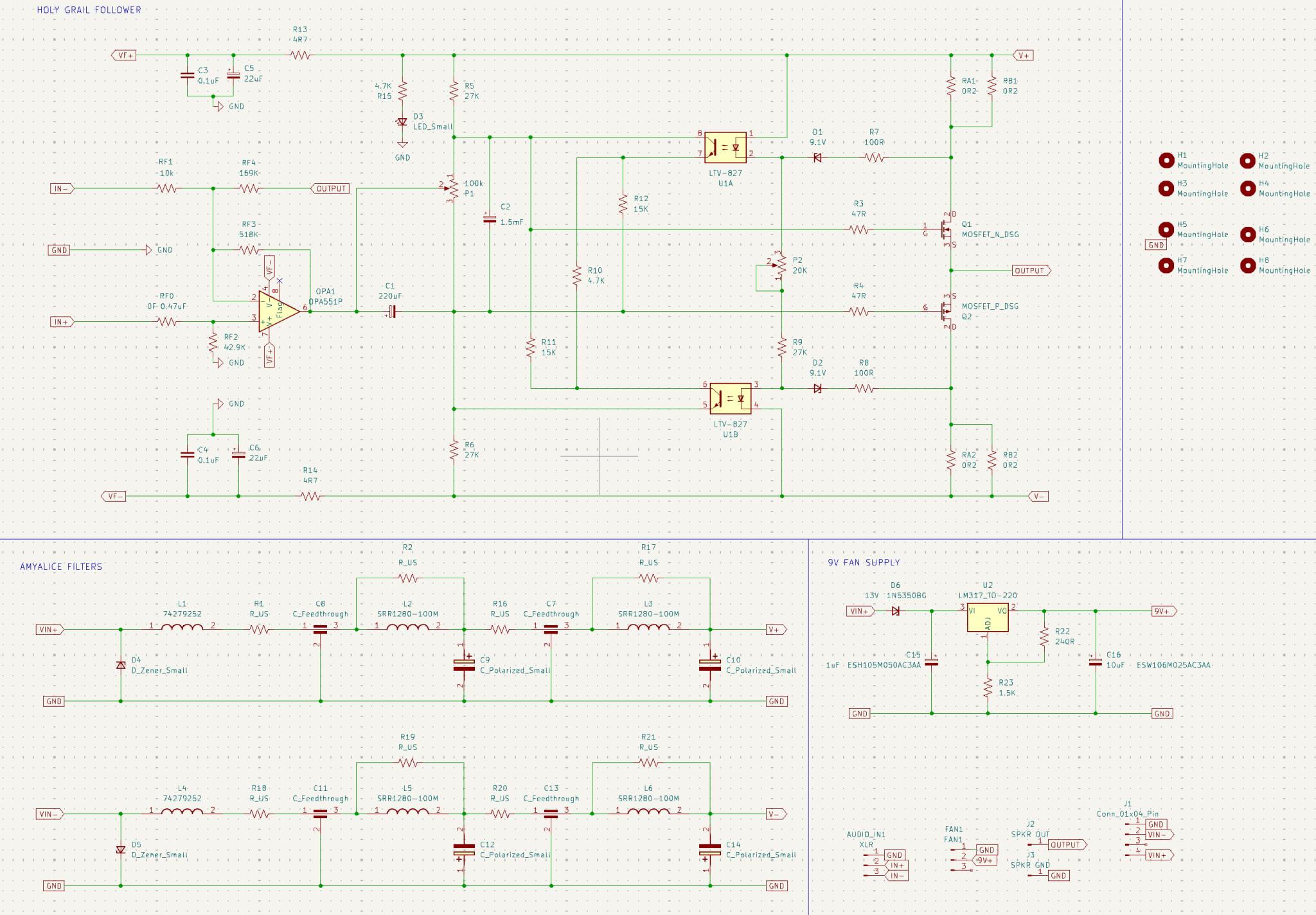

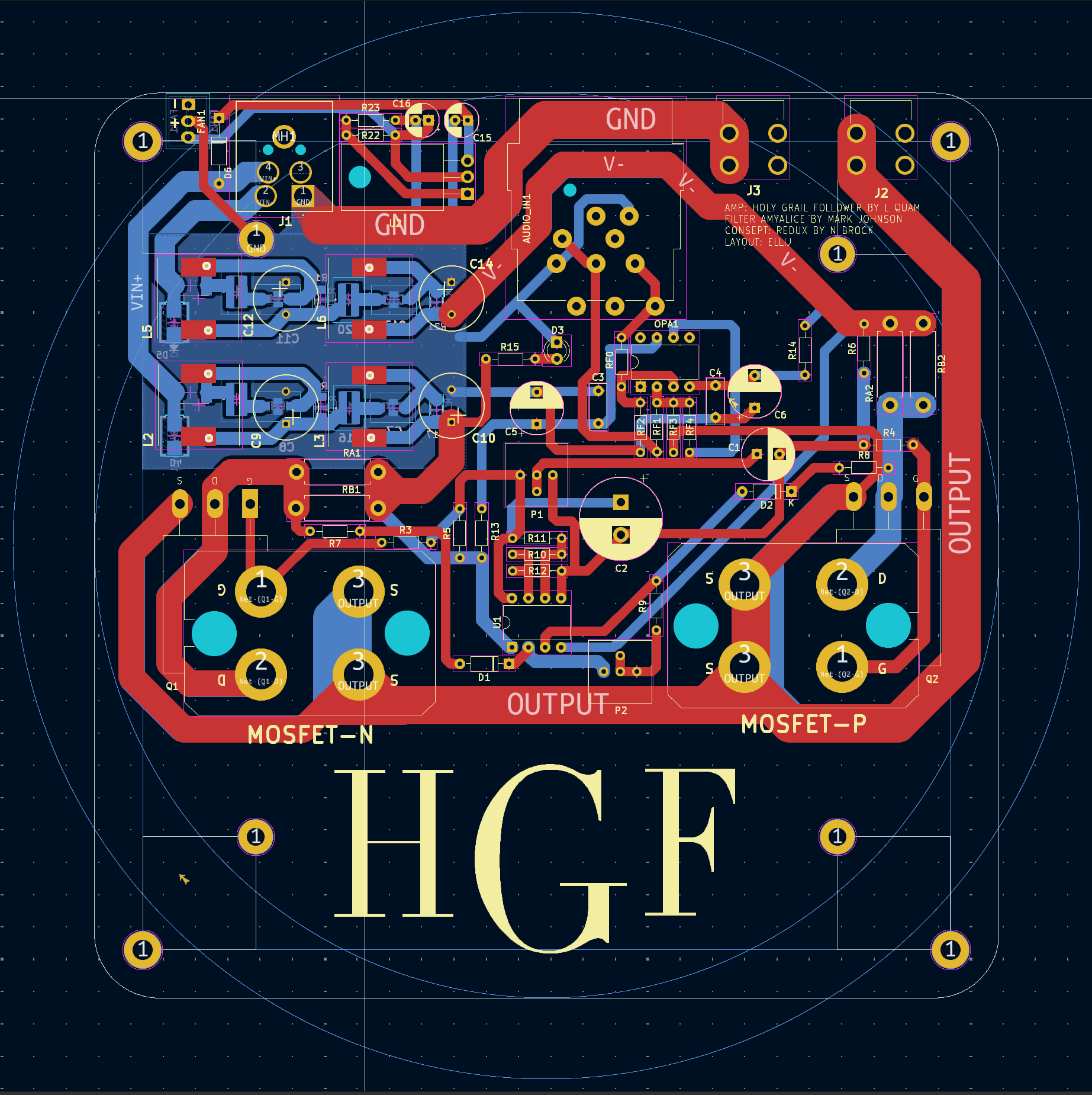

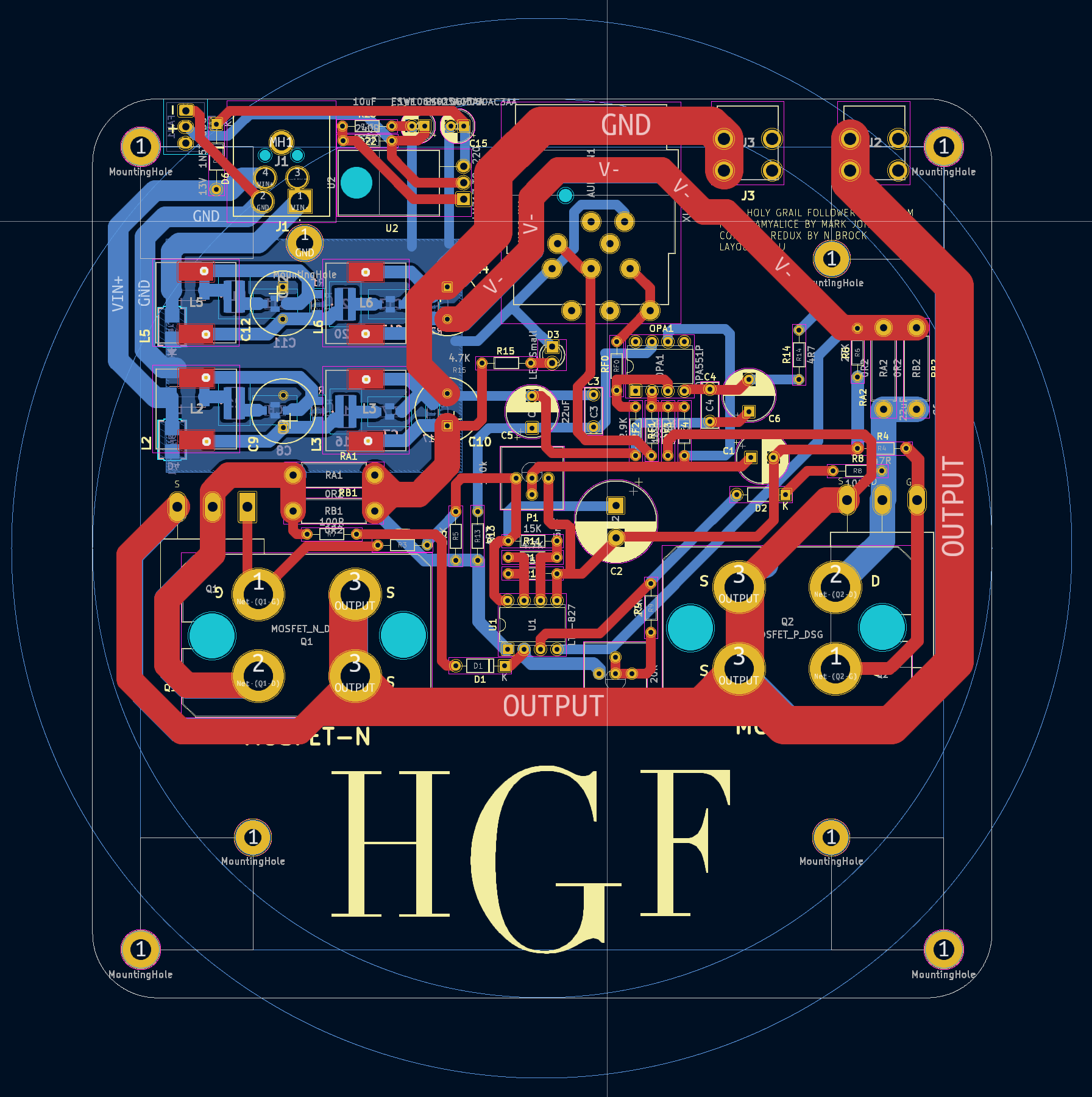

COPYING everyone's hard work I came up with this PCB. It has many compromises to keep all the sockets at the rear. TO-247 or SOT-227 mosfets fit. 140mm or 160mm diameter heatsinks could be used, 160mm fans are hard to find but have the same mounting hole positions as 140mm. Not sure what is the best way to get 9V for the fan, used a zener and an LM317. This is a work in progress.
The two blue circles represent 140mm and 160mm heatsinks. If anyone can do a better layout I would probably copy that too.
The 9V circuit is simple and can be optimised to the input voltage. Could squeeze a pot in there too and make the fan speed adjustable.

Hi ElliJ,
Looking at your pcb layout, I see that you have incorporated the AmyAlice power supply filter. I have a suggestion as to the implementation of the Ground.
The power from the external power supply into the filter is assumed to be not so clean, and as the current flows through the filter it becomes cleaner. The output of the amplifier power supply is at the output of the AmyAlice filter, where the power is the cleanest. The best place to connect the amplifier circuit ground, or audio ground, is at the output of the amplifier power supply, which is at the output of the AmyAlice filter.
I also suggest that the external power supply ground be routed with the external power supply V+ and V- to the input of the AmyAlice filter. That keeps the loop area small and also keeps the "dirty" ground away from the clean ground.
Going for the 160mm I see, just had to one up me huh?
Keep up the good work!
I used a small DC-DC converter.Not sure what is the best way to get 9V for the fan

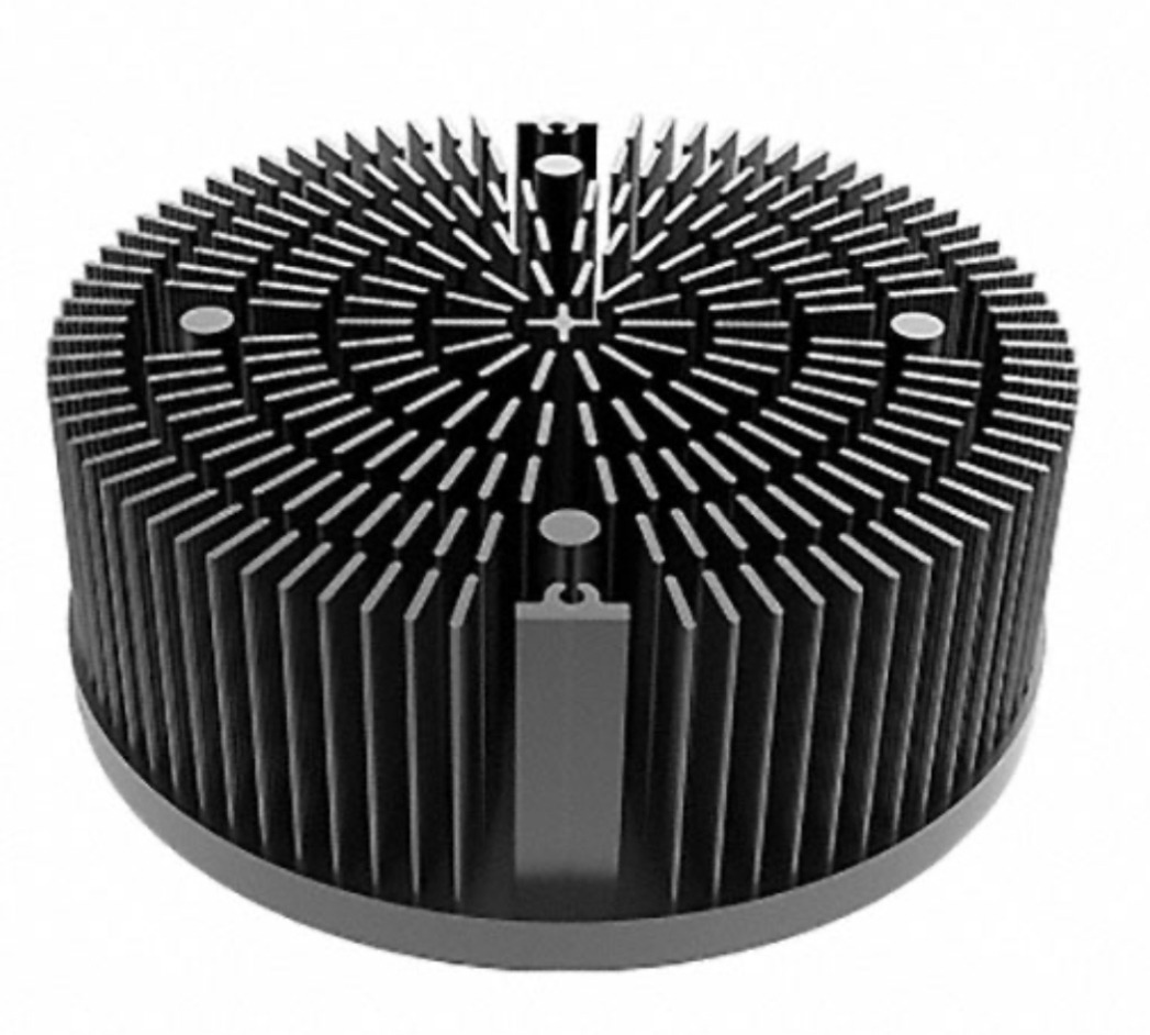

@N Brock, it’s not the size that matters (I hope). There is only one fan that is suitable I think (Google SF-160 fan). You could put the same fan and heatsink on the F5m Redux with no changes. I don’t have a temp switch, my 9v supply is untested and my layout has lots of compromises so will be happy if it sounds good. I am going for pucks, +-30v supply, skinny standoffs, wafer thin PCB and a slightly different type of heatsink. Fingers crossed for no magic smoke.

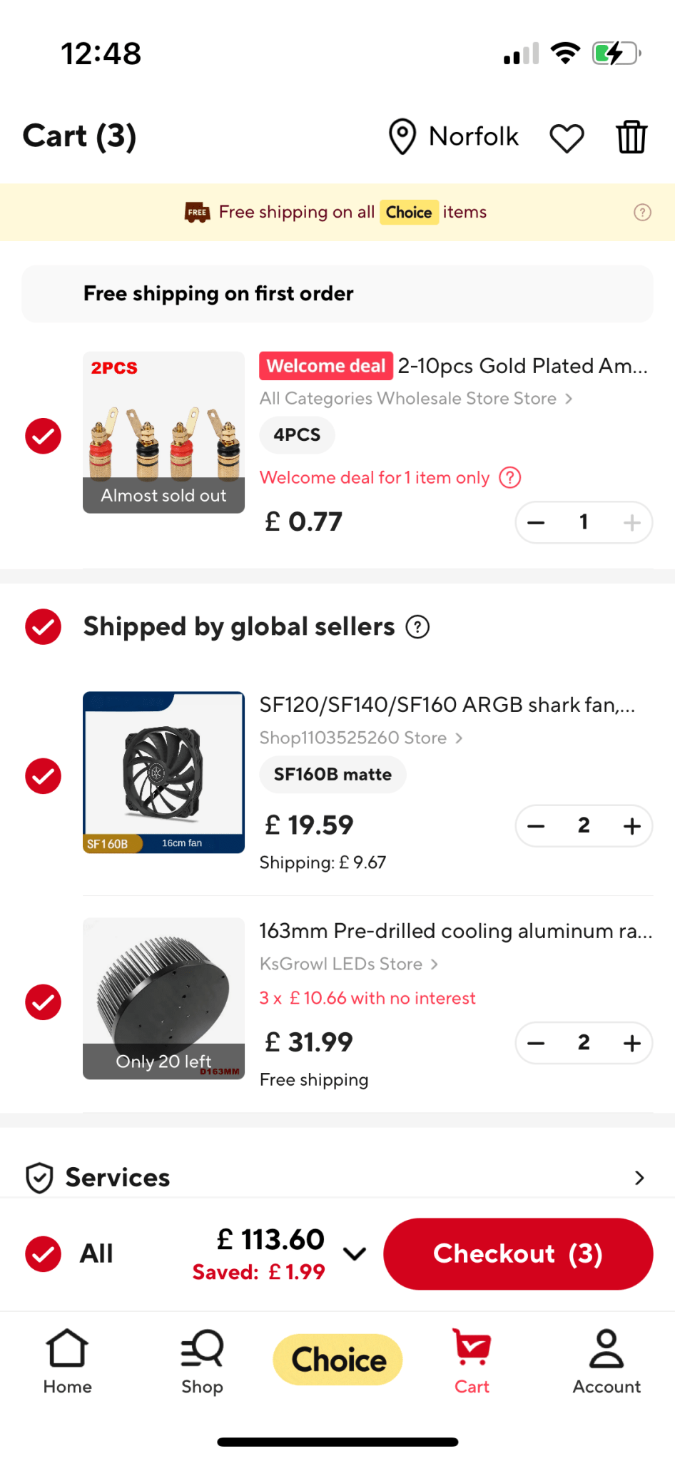

I ordered some heatsinks from Aliexpress but they told me there is no stock, but there was when I ordered. I went with D165mm H80mm from digikey £45. Fans were on Aliexpress £19 each.
PADLED-16580

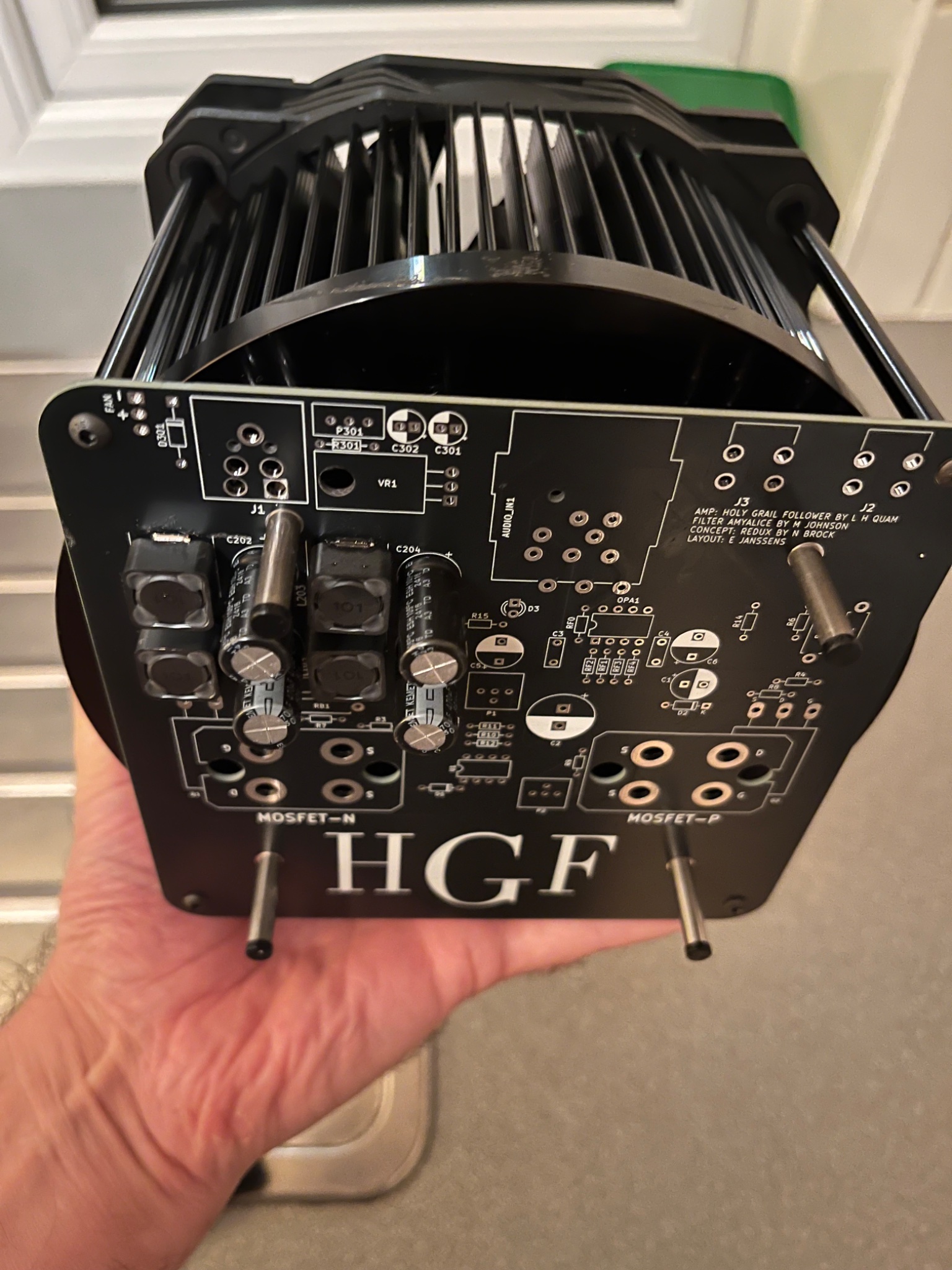

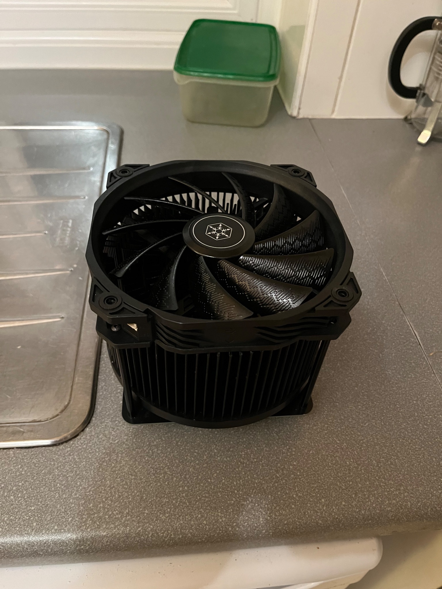

I have not had much time to work on my HGF. Had some trouble drilling the heatsink, I kept snapping bits. I have drilled a few heatsinks in the past and not had issues, the metal of these is really soft. Finished tapping one and the SMT on one PCB too. I assembled an amp to see how it will look, not quite as good as @N Brock’s, but not too bad either. Have to lots of uni work at the moment but will try and finish them next weekend.
Are you using a drill press? What about aluminum cutting fluid? Both of these will help with drilling and tapping hole.Had some trouble drilling the heatsink, I kept snapping bits. I have drilled a few heatsinks in the past and not had issues, the metal of these is really soft.
I was using a drill press but not cutting fluid. The drills were not getting hot. I even got some Bosch hss bits after breaking a couple. The metal seems softer than normal. I will take your advice and use some cutting fluid next attempt.
Found time to finish drilling the heatsinks and with some oil I had no problems. Thanks for the good advice.

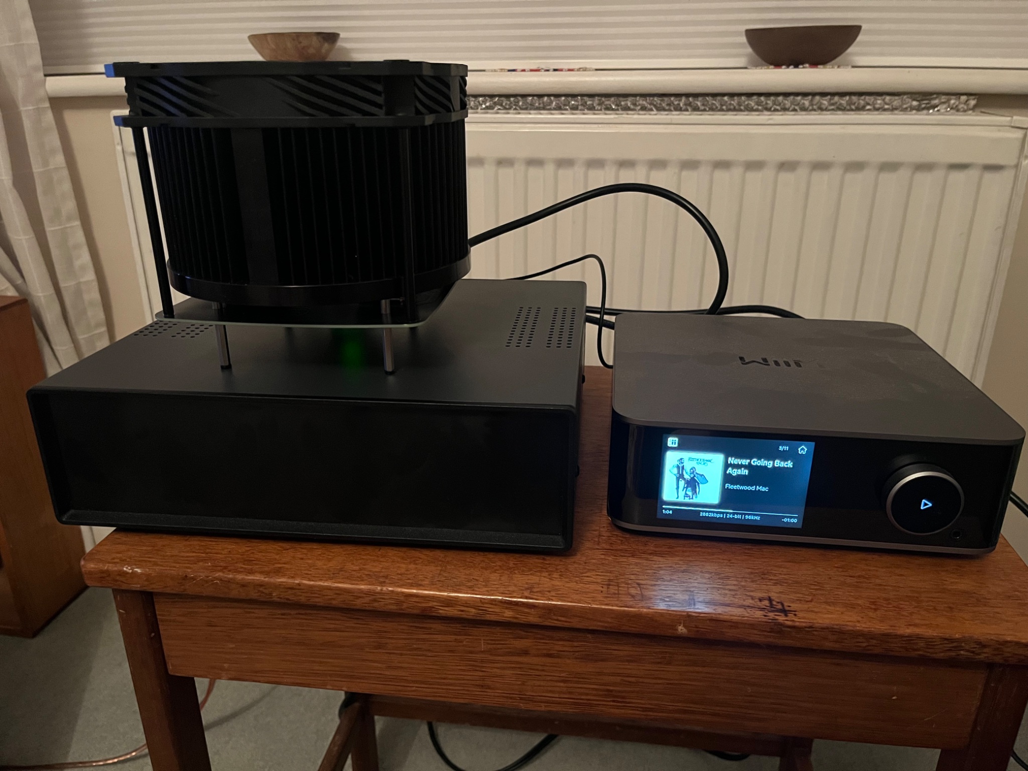

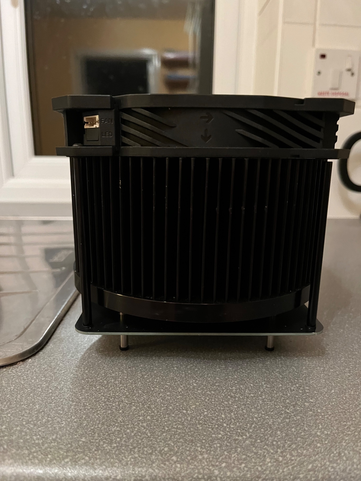

Had time to finish an amp and the power supply. It didn’t catch fire and is totally silent. Not sure how good it sounds as I am testing it with some bookshelf speakers (Q Accoustics 3030i) in mono. The trouble is I’ve never heard the speakers before, it sounds smooth or even Yamaha’ish. That will change when it is stereo, 30V, higher bias and on some proper speakers. Normally I use Celestion Ditton 25 speakers but I don’t have the room right now.

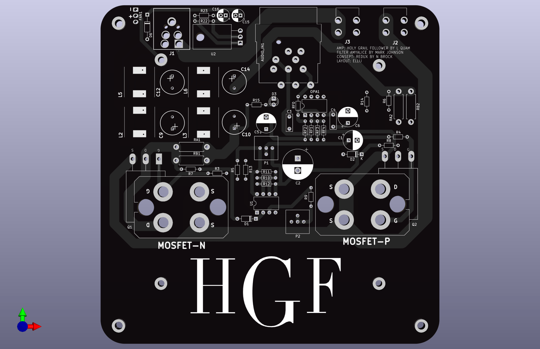

There was a mistake on the silkscreen, RF3 and RF4 were the wrong way round. The fan plug does not have enough room but I bent the pins a little and got it on. The other thing I didn’t take into account was the xlr socket and needed longer standoffs that are used for feet. The diode for the 9V power did not fit the foootprint, it was miles too big!
The psu worked out ok. It has a SS relay for the 12V trigger and a trigger bypass switch ( which needs replacing as it is always closed). I used two LRS-200. The KPPX plugs were a bit fiddly to assemble.
It needs chunkier standoffs as it looks odd.
The fan works really well. The heatsink got to about 60c without it and feels cold with it.
Just used the room correction on my WIIM Ultra and it now sounds much better. Not sure what to think of these 3030i speakers, without the room correction it sounds like there is something smothering it slightly. I will drag out my Celestions on the weekend and have a proper listen.
