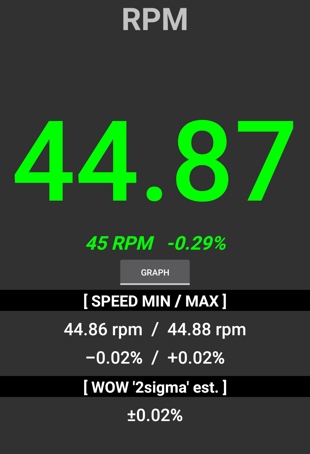

Those speed measurement apps are usually inaccurate for obtaining absolute RPM, but the RPM deviation is typically very accurate, depending on the quality of accelerometers in the measuring device and how well the device is centered on the platter. Its also important to verify the TT is perfectly level.Those pots do not do that. I have said more than once, your app is not accurate or repeatable, you should stop using it,
It is possible your turntable was perfect until you "adjusted" it.

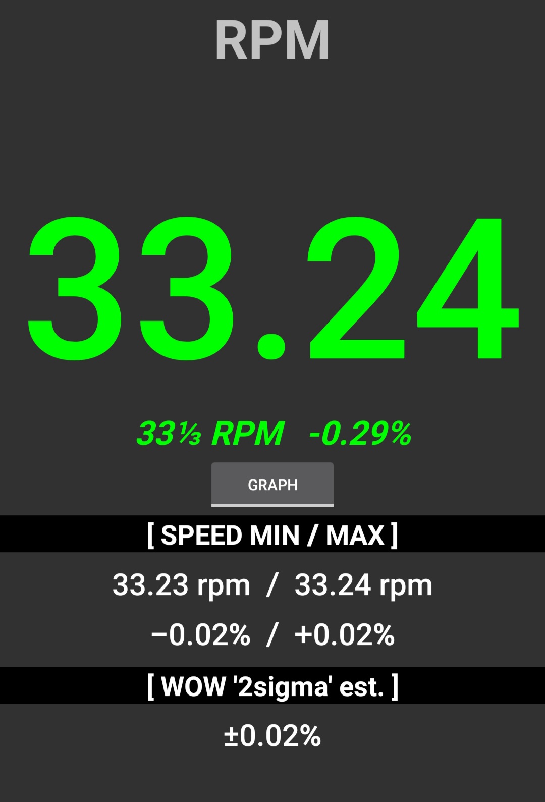

Below are measurements taken by my Samsung S9+ on a freshly restored 1200MK2 using a generic app.
The motor on this TT was optimized to have exactly equal drive current through all 3 phase groups of drive coils. This was done by reinforcing the PCB traces to the coils and installing 0.22R resistors in series to dampen each coil. The cap values were slightly changed to optimize the detection coil lowpass signal. The best W/F to expect from a PLL controlled technics DD setup is about 0.02% p-p.
