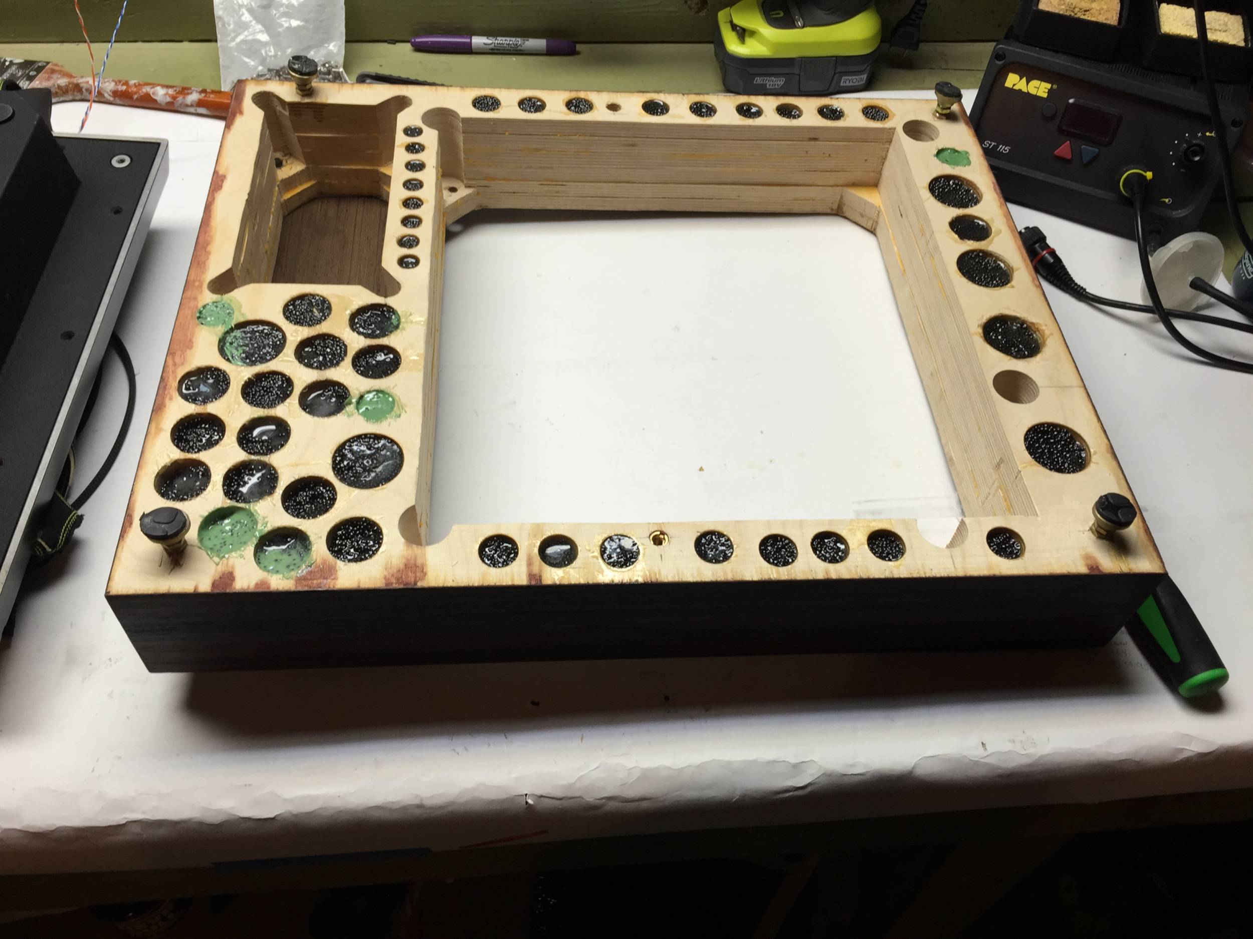

After talking to a few people who've been down this road, I realize I need to just plain make the plinth heavier. So, the big drill bit comes out and Swiss cheese ensues.
"Each tuned to a different frequency. "
(One of my favorite audio marketing BS phrases...) Anyway, the green epoxy is a 3M product that never dries totally solid. The rest is just cheap 5-min.
Mass has been increased by at least 2kg. Maybe a bit more.

I am curious about the lead shot pockets in your plinth. I see that many of these shot pockets have been infused with the green epoxy you allude to. Is there any reason in your planning to use the epoxy?
The reason I question this is that my understanding of the reasoning behind including lead shot pockets within a plinth design is to actually promote the interaction of the individual lead shot with one another as vibrations flow about within the plinth. The idea being similar to using a sand box where the individual grains of sand intereact with the flow of vibrations. It would seem that inclusion of any epoxy, which solidifies the shot into a single mass, would prevent this. Therefore, I presume the entire reason for including lead shot is simply to increase the weight of the plinth, is this correct?
-Steve
The epoxy is deep enough to secure the lead in the hole. Nothing more. I used the green (fantastically expensive) stuff because I ran out of 5-min.
Yes, it's heavier.
No, the shot is not completely infused with resin.
No, it's not "tuned to a different frequency", well, not intentionally anyway, I'm saying that tongue-in-cheek because a certain British TT manufacturer claims that for the 3 identical feet on the bottom of their plinths, because as each supports a different amount of weight, they all resonate at a different freq. ... LOL

Back 1-1/2 decades ago the group that started out as a diy turntable group but morphed into three different manufacturers, Teres, Galibier and RedPoint. In that group it was generally considered that shot pockets of #9 lead shot should be prepared in one of two ways; 1) dry and loose or 2) loose but filled with thin viscosity silicon lube. The argument in favor of the silicon lube was that it served to induce the lead shot to interact with vibes passing through. But it was necessary to make the pocket liquid proof. Which was easy if your material was acrylic or some other resin.
Since then I've used loose and dry #9 lead shot pockets in various plinth projects. To some observable benefit, imho.
