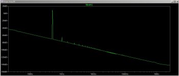

So, when I finally twigged that the circuit on page 8 of the Cookbook was the exact same design a couple of days ago, I became very excited indeed. In fact, I immediately simulated it in Spice and it's good enough that I will be building a replica. Because CURIOSITY, that why. This is the amp of legends, and legends have to be either killed off or made to live on in glorious perpetuity.

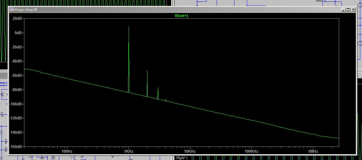

Code:
N-Period=1
Fourier components of V(out+)
DC component:-0.0044678
Harmonic Frequency Fourier Normalized Phase Normalized
Number [Hz] Component Component [degree] Phase [deg]
1 1.000e+03 3.943e+00 1.000e+00 -0.14° 0.00°
2 2.000e+03 3.102e-03 7.866e-04 19.59° 19.73°
3 3.000e+03 1.979e-04 5.019e-05 96.54° 96.68°
4 4.000e+03 1.879e-05 4.764e-06 -166.62° -166.48°
5 5.000e+03 7.499e-06 1.902e-06 -178.26° -178.12°
6 6.000e+03 6.563e-06 1.664e-06 179.87° 180.01°
7 7.000e+03 5.624e-06 1.426e-06 179.96° 180.10°
8 8.000e+03 4.921e-06 1.248e-06 -179.92° -179.79°
9 9.000e+03 4.369e-06 1.108e-06 -179.94° -179.80°
Total Harmonic Distortion: 0.078826%(0.078815%)

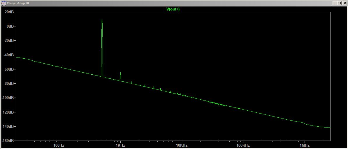

I spent the evening fiddling with parameters in the Spice simulation, since the designer didn't have the benefit of such equipment. The THD (at 1 kHz 1 watt) is now between 0.008% and 0.019% depending on one configuration option. That's an order of magnitude improvement over the original.
As I suspected, this has the potential to be a great amplifier.

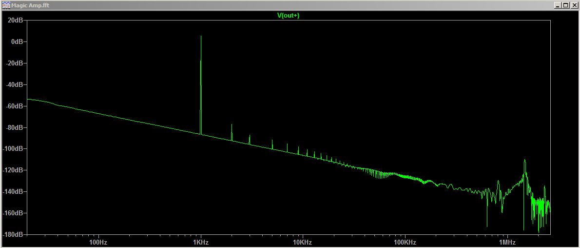

I've finished the redesign using modern parts, and ordered enough to build a couple of these amplifiers. With the mails the way they are I'll probably start seeing parts arrive in about six weeks, so that should give me sufficient time to lay out a board and send it off to be made. Since PCB manufacturers generally use couriers the boards will probably get here at the same time.
Could you please increase the shunt cap to 10mF to reduce the noise floor?
Then we can see the precise peaks of the odd orders..... but this profile is very good, as good as I've seen.
HD
I did that Hugh, made zero difference. Hey, do you have an AP down there in Gotham City? Might come in handy to measure this thing properly once I get it built.
Oh hang on, are you talking about the feedback shunt? Sorry, I was thinking power supply (it has been a long night!) Interesting idea, one sec.
1 kHz 1W with 10mF shunt. Naah, that's almost identical too.
Thanks. The peaks are evident with the high fb shunt cap, that was what I wanted.......
Looks OK but the odds are higher than the evens, indicating symmetrical topology.
Does look promising, no question.
No, I don't have an AP. Even years later they still cost many thousands.
HD

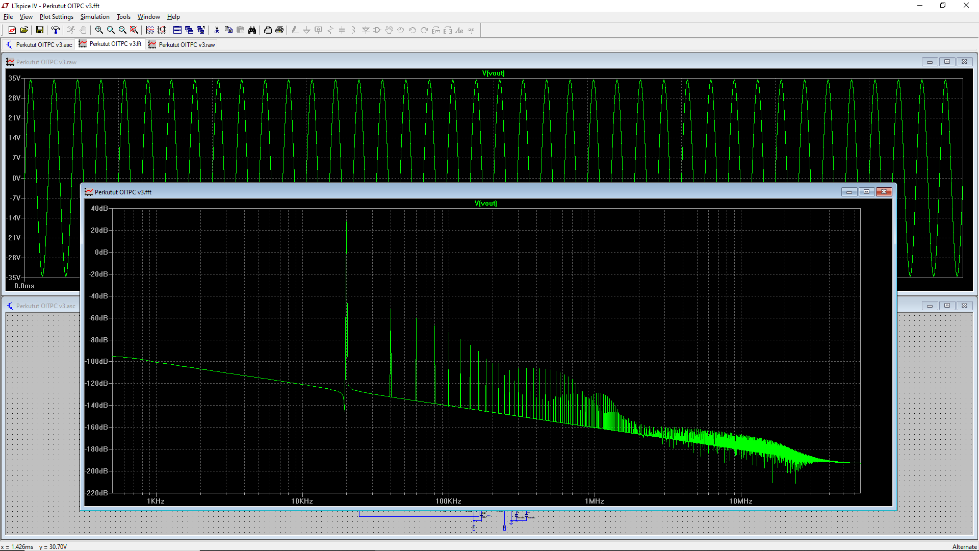

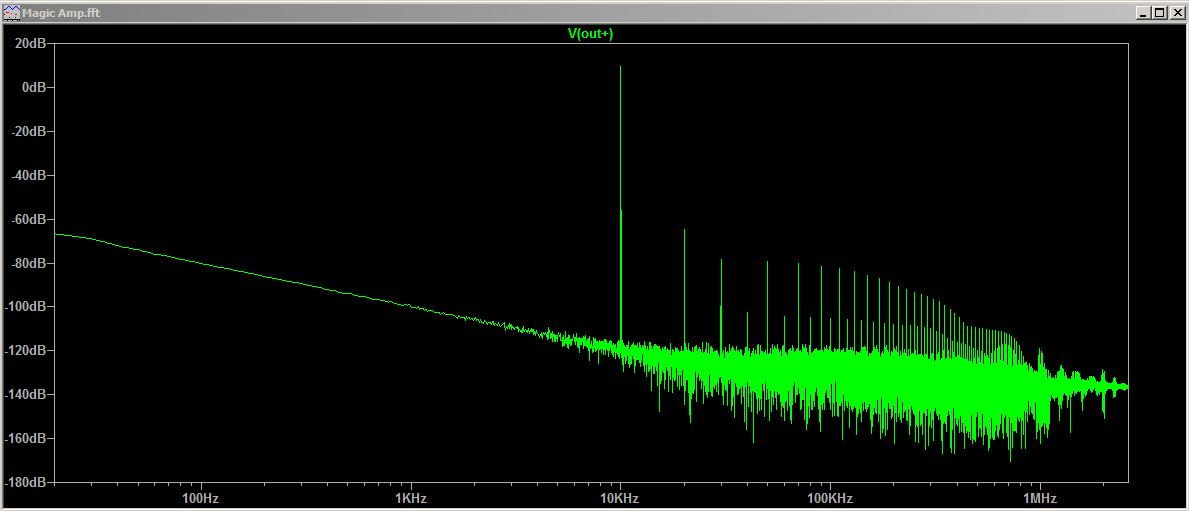

Monotonic harmonic profile as Mr. Hugh Dean (AKSA) suggested is very good. But I want to make THD small as possible with monotonic harmonic profile. It is easy to achieve with class A amplifier. For class AB, monotonic harmonic profile is difficult to achieve at high frequency.
In this simulation, I can achieve monotonic harmonic profile at 20Khz using class AB, but THD is higher to my taste. But at low power, THD much lower. To achieve it, loop gain must be flat at least until 100kHz, but loop gain can not be too high (around 40 dB). It is VAS with resistor bootstrapped and with OITPC compensation.
AP’s? We don’t need any stinkin’ AP’s! We got REW!
Howto - Distortion Measurements with REW
Here is a measurement using REW of Hugh Dean’s ALPHA power amp:
Pray tell, what does the schematic look like? The suspense is killing me.
You'll just have to get hold of a copy of Allen Wright's (copyrighted) Tube Preamp Cookbook.
I like the harmonic profile of the “magic amp” but alas, many SE Class A amps have a profile like that.
Sure. The difference is that this one doesn't idle at 3 amps.
