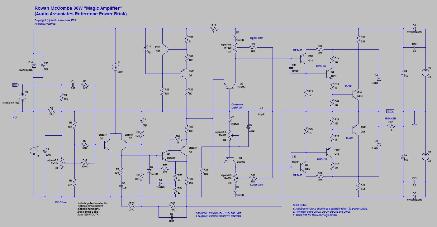

I had a long think about this and it seems to me publishing the circuit as shown in the book couldn't do much harm. Neither Rowan nor Allen are with us any longer. The caveat is that the heirs of either one could claim copyright, so a notice is included.

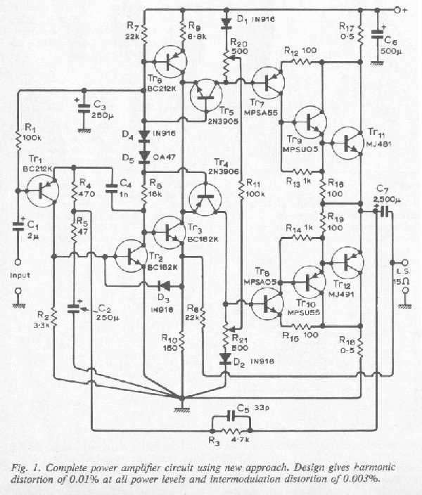

It should also be noted that the basic circuit was first published in EW+WW 1971 and the author of that article had a patent application in progress, so there's that as well. Voltage rails for these output parts should probably be lower than the 45V shown, maybe 35-40V would be more appropriate.
Thank you for posting this. I agree, no harm done of copyright notice is applied and this from 1970’s.
The trick is Q7 being driven only from one of the “long neck pair” (LNP). Sort of like the Aksa Lender front end used in the ALPHA amp above which also achieves dominant 2nd harmonic output. This asymmetry is key to removing the typical behavior of a LTP front end which is usually dominant third harmonic.
The front end from the Alpha does not need to drive a 1.3A idle bias current output stage. Could also be usual Class AB with say, 80mA quiescent bias current. It just won’t have the same Class A smoothness but the harmonic profile would be similar.
There are a number of errors in the circuit as drawn by Rowan. R12 has no value associated with it, and the zener and associated cap will go bang if they are added as shown. The transistor types Q1 to Q7 are selected from what was available in LTSpice, and are not the originals which were in the BC series. The output transistors are from the original EW+WW article and are clearly not what was used in the reference brick.

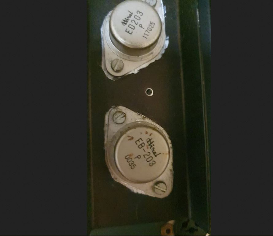

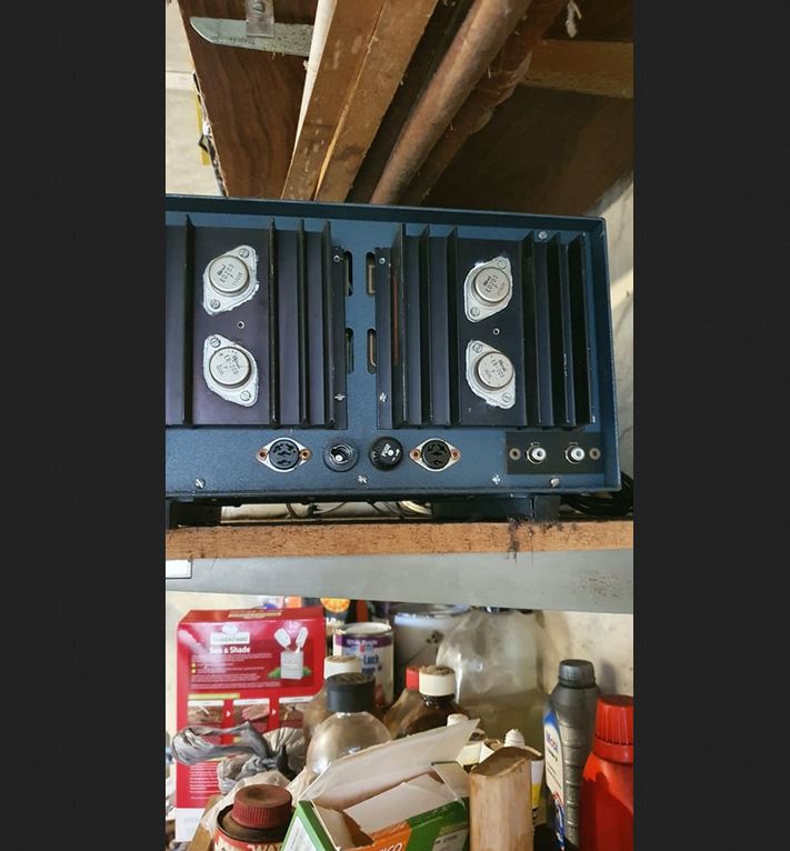

The plot thickens. The owner of the only Magic Amp in Australia, previously identified as Peter M, sent me some old photos showing the power transistors. He thought this might help in my design efforts but in fact it has not. The photos show two pairs of transistors made by a company called Hiral Semiconductor, a company of which there seems to be no remaining trace. The name Hiral is of Indian origin and there is a Hiral Jain working at NXP but that's a long shot.
The part numbers themselves are likewise untracecable. My 40 year old transistor equivalents book shows no such parts as EB203 and ED203. Pics attached.
According to some reading on Australian hifi sites, the Hirel ED203/4 was the NPN device and the EB203/4 was the PNP device. The specs are roughly 20A, 200W and 200 MHz. They were used by Peter Stein in his ME-100 amplifier in 1976 and by several companies building PA systems around Sydney, notably Jands. The company was a boutique manufacturer based in Tokyo and are no longer in business.

The interesting part of this design is that the crossover distortion and output device balance parameters can be tweaked to suit the listener. I believe the alignment process was a bit of a bear, since these guys were both consumate perfectionists.

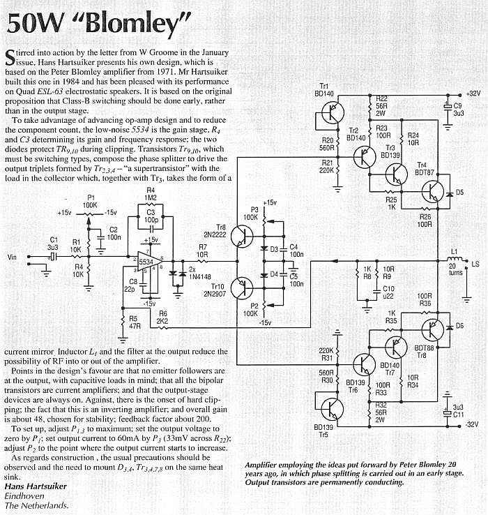

not really a new concept as it was discussed somewhere else already:
https://www.diyaudio.com/forums/pass-labs/262821-class-ap-amplification.html#post4077413
https://www.diyaudio.com/forums/att...103312011-crossover-distortion-hartsuiker-jpg
https://www.diyaudio.com/forums/att...over-distortion-blomley-amplifier-vcc-60v-jpg
I don't believe I was claiming it as a new concept, since the amplifier in question was designed in 1975 and I've already stated it was loosely based on EW+WW 1971 (Blomley's circuit).
