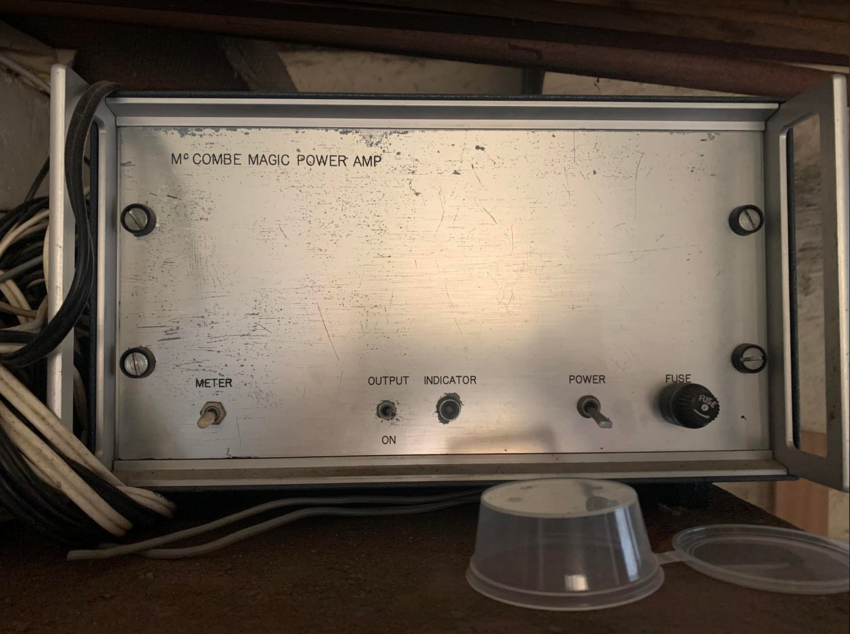

Sorry but there are no gerber files. I have been waiting for the original to be shipped so that I can verify the circuit before making a replica. My friend Peter's son didn't ever get around to shipping it, and Peter himself was in Sydney a few weeks ago on a short visit and didn't send it either. He did send me a photo of the front panel though ...Hi Haiqu,

Hi Haiqu,
Thank you for the picture.

Hi Haiqu,The gerber file for the Blomley is in a completely different thread. In fact I had some PCBs made.
No, I haven't built The Magic Amp yet. Like I said, I've been holding on to get the original so that it can be accurately copied.
Thank you. I found the picture in the Blomley Amplifier thread.
