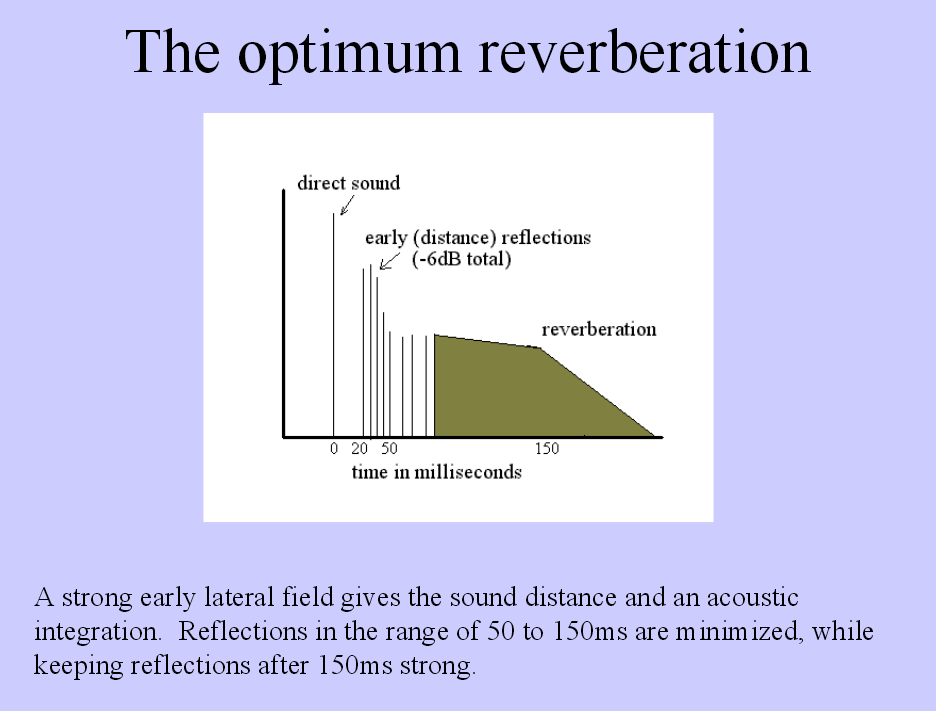

After playing several movies over the last few days I'm convinced a bit of reverb on the ambient channels may create even more atmosphere. I only briefly played with it a long time ago and it showed promise. I'll have to revisit that idea. But how? Probably using convolution to be able to optimise it. Just a tiny bit can go a long way. I don't want it to be too obvious. You shouldn't even notice it, except when it's turned off.
The above picture will be a good guideline...

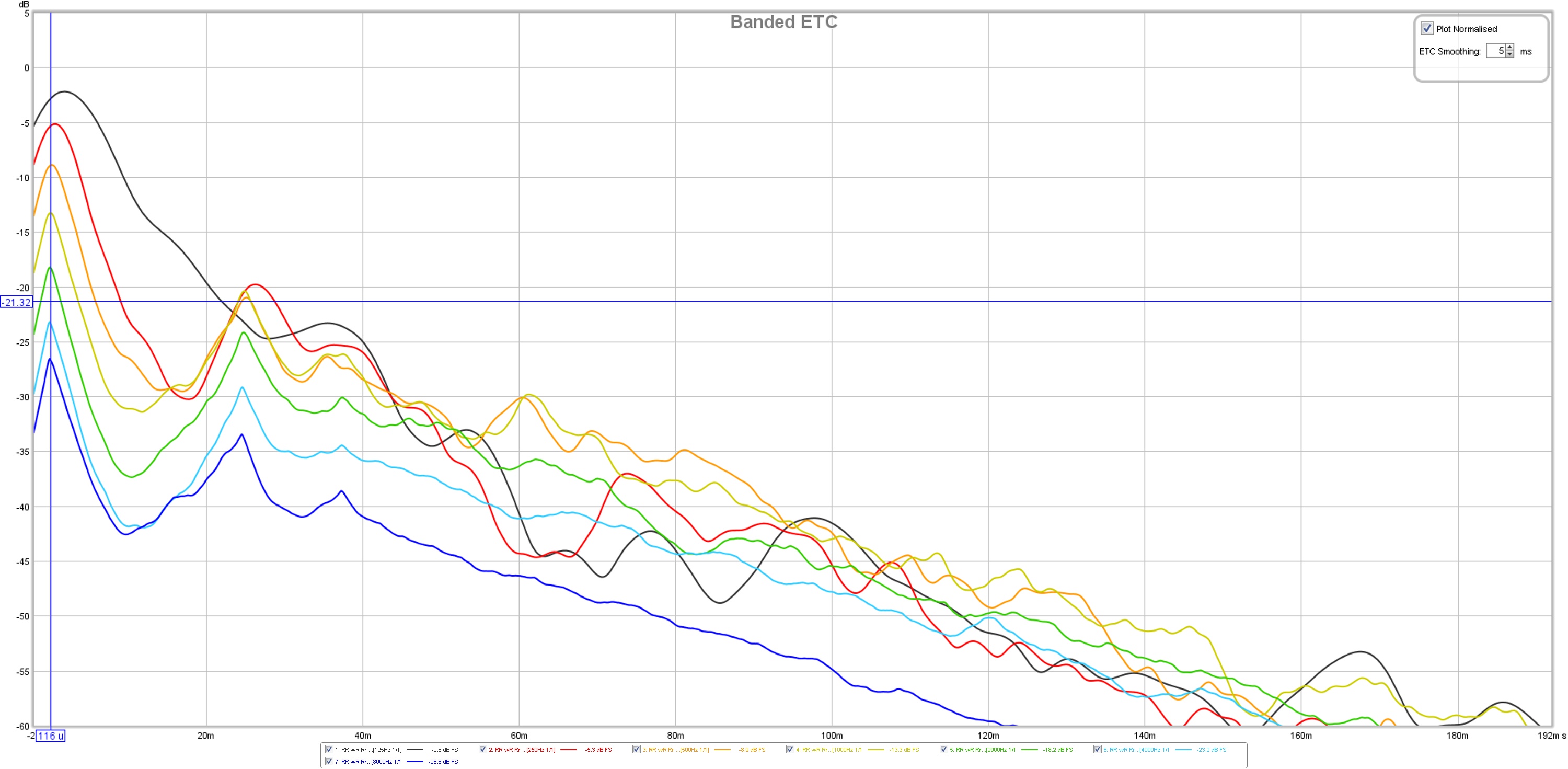

As a suggestion, I wouldn't rely too much on a full range ETC as an ambient gauge. Its too frequency biased. Instead, consider 1/1 octave banded ETC.
For a proper ambient effect, the bandwidth must be considered, both in magnitude and temporally.
I also have another thread where I am talking about this sort of thing: https://www.gearslutz.com/board/studio-building-acoustics/963767-artificial-haas-kicker-tail.html
Thanks Jim, I know the usual IR shows only about ~4 to 8 KHz+ info. I'm pretty used to use the filters on that tab to find out what's really going on 🙂. I want to test APL_TDA with the ambient channels engaged one of these days. The ambience signal will show up as bumps above the noise floor.
