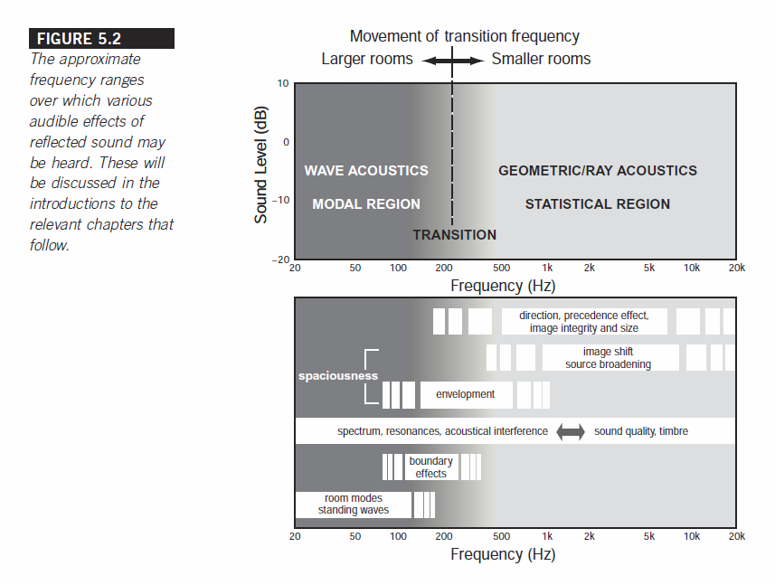

Nice work! You have more tools to work with than I do. I am jealous. The thing I am seeing is your extending >150ms, but also 50-150.
As I understand things, the frequencies <1K are the ones of interest for envelopment.

Judging the reverb alone, from the RT tab that envelopment region is exactly what I am targeting. Useful graph! Thanks for posting that. I'll have to work on my Haas kicker first, then try to optimize the reverb. It did show promise! I loved what I heard. But I've got to love it over a long time to be convinced.
But as each parameter can be changed, it will take me a while to find optimum settings.
And the one above 1khz are for sharp image/stereo.
But it will still have the properties of that large room.
More than the high roll off it is the way the hall algorythm deal with the 'space' between reflections creating reverbs ( a bit like the spread of mode in the low end region: more spaced=more enjoyable) and the way they are 'spread' over the room to be simulated.
