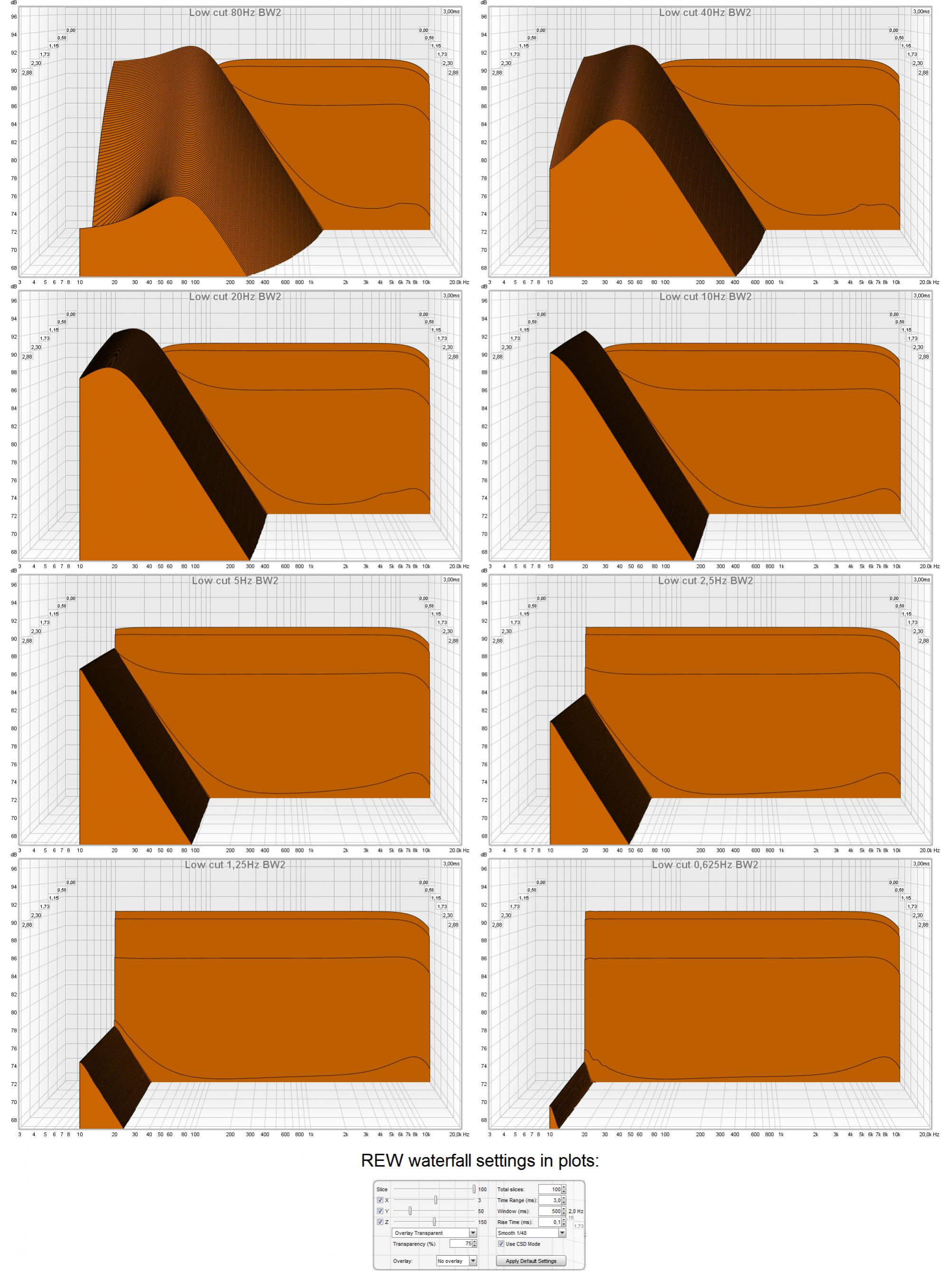

Cut of sharp below 30 Hz? I did try that for a while, I noticed I stated missing a lot of ambience queues, more felt than heard though. I roll off more gently now and ~17 Hz could be called my -3dB point. Steeper roll of below that though. The atmosphere it can bring is wonderful (if it's in the recording of coarse). Definitely word trying at least once!
There's not a lot of loud tones or sound below 30 Hz, but there sure is a lot of added atmosphere there. If a note would be played at full power there I'd run out of excursion quick.
There's only a few songs that I stumbled upon that made me worry.
"A Perfect Circle" with "Lullaby" comes to mind. Can't play it too loud. (while the highest peak is at 35 Hz, there's still a lot of energy at 24 Hz and lower)
.....make them acoustically flat down to 30HZ (with a fast rolloff below that), which sounds really good to my ears.
These comparison graphs think support wesayso's experience if we can trust REW waterfall, in below it seems target as low as possible 15Hz or less, it would pay back with first slices of direct sound not affected of booming delayed tail coursed by system high pass filter and clear up also into area of mids. Below being fullrange without any XO point as with wesayso's arrays, adding IRR XO point in low frq area to below example will add quite some new slices of tails unless XO is created or corrected somewhere with FIR filter.
Bob i also play electric guitar and below makes sense a situation i had in past when comparing a FENDER Super Sixty top verse a Fender Bassmann top driving same dual 12" celestion speaker box. Having both amps voiced close to same tonal balance they sounded nearly the same except all notes on deep E string and chords where Bassmann top was superior in resolution and details in lows, now looking at below plots think it makes sense that in being a dedicated bass amp its high pass filter frq point is set lower and makes a difference.
