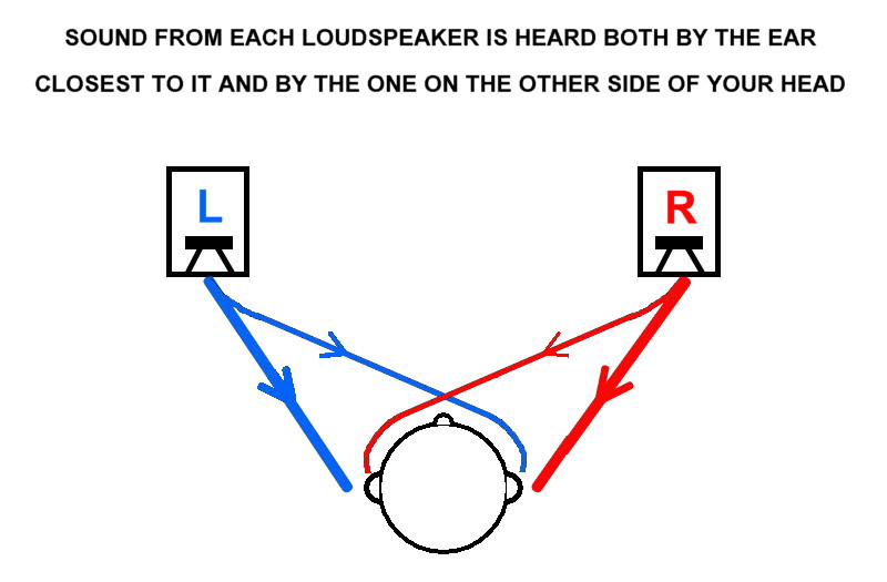

Back to reality... the Phantom Shuffler, what is it and how does it work? That question intrigued me so I went on a crusade to figure it out. It all started with BYRTT posting some Dirac pulses summed with a slight time delay.
That triggered me to start investigating what it was that I liked about the shuffler. If you want to see what I tried, follow this link...
I'll try and explain what I think is happening... First we start with a picture of what cross talk is:
(picture "borrowed" from Steve Hoffman forums)
The thick red and blue lines are the direct sound. They will arrive at your ears first. The thin lines cannot be avoided though, sound from the left channel is going to reach the ear on the right side and vice versa. There will be a time difference between those two sounds. Depending on how the speakers are setup and even your head size plays a role.
If we listen to phantom information both our left and right channel are playing the same information. But we saw above that sound also travels around your head reaching the other ear. That's where the sound will interfere and will cause comb filtering to happen (oh no, not that again
So what does it look like, you may ask. If we stick with an average delay of 0.270 ms we can figure it out.
Sound travels from the left speaker to the left ear, the wave continues and reaches the right one 0.27 ms later. But that particular ear just received the same info as the left if the content was panned to the center. This is where the combing starts. If we assume a Dirac pulse, arriving at that right ear we would get the delayed content of the left ear interfering with that pulse 0.27 ms later.
On to REW, we take 2 Dirac pulses and delay one of them with 0.27 ms. This will give us a view of our comb pattern:
So we get a first wave front, free from combing and 0.27 ms later it starts combing (at both ears) and creates the above pattern at our ears.
It actually fitted my experience, I've told you guys I cut 2 frequencies in my mid/side processing. Guess what they are!
One cut is at 3700 Hz, Q = 2.5 and gain = -1.4 dB and the second one is at 7270 Hz, Q = 2.5 and gain = -1 dB. Those settings were a "left over" from my earlier cross talk cancelation experiments. I found it cleared up some center panned vocals that were harder to follow without the cuts. It's in this thread somewhere.
Good fit right? If you look at the summed Dirac comb filter pattern it makes perfect sense. I even cut a tiny bit in the sides signal to fine tune my balance. But it wouldn't/shouldn't be absolutely necessary.
Now why does the phase shuffle work? What does it do to the above situation?
To find out we start to sum the shuffler IR instead of that perfect Dirac pulse.
Again we offset one of the pulses by 0.27 ms and look at the comb filter result.
Red trace is the shuffler called "Rephase Shuffle-2.wav" from Pano's thread. Purple trace is the Dirac again to compare.
Do you see the difference? By alternating the phase, which is what the shuffler does (see a couple of posts above), we move the dips to a different location. We created a phase difference at ~2000 Hz between both channels of 60 degree (or slightly more).
The signal still sums, but the dip is moved in frequency by that subtle phase turn. Because the phase is opposite on the other channel the result at the other ear will look different.
Here's a view of both results. One trace would represent the left ear signal and the other one the right ear:
Now we see the magic! You either get that Dirac comb pattern at both ears (without shuffle) or we get the above combing, slightly different for each ear but together creating a better balance. Remember, we already heard the direct (non disturbed) wave front for 0.270 ms before this happens.
So the choice is to listen to the Dirac combing at left and right ear, screwing up our balance or use a shuffler to shift the dips and get a more even balance to process in our head.
Let's look at an average of the shuffler combing and the Dirac combing as we get to process it in our head:
See how most dips are filled in? This actually brightens the phantom center. Making it sound more real. The dips eat away less of the signal arriving at the ears. It even gave me more sense of depth. Earlier I quoted material that told us boosting at 2 KHz gives more sense of depth. Care to guess why that is if you look at this story?
Now why would it only work on the phantom center material? If you look at the sounds panned hard to the left, they don't have an equivalent sound wave comming from the right channel to interfere with the left channel sounds that's leaking to the right ear. And if we combine the left shuffle IR with a delayed left shuffle IR we end up with: the exact same shape as the Dirac comb pattern. So for panned sounds we get some cross talk, possibly coloring what we hear but not the combing, eating away at our wave front.
In other words: no change to the left or right panned sounds, only a perceptual change of the phantom center. Except for the possibility of hearing the small phase shifts we introduced to the signal chain. Some sounds will be a bit early (by about 0.16 ms max) or late (by the same amount). I'll have to admit, I couldn't hear that difference.
![comparedshuffle.jpg](https://www.rsr-concepts.com/diyma/comparedshuffle.jpg)
![left%20and%20right%20ear%20summations.jpg](https://www.rsr-concepts.com/diyma/left%20and%20right%20ear%20summations.jpg)
![sum%20at%20ear.jpg](https://www.rsr-concepts.com/diyma/sum%20at%20ear.jpg)
I was more in awe of what the shuffler did for the phantom center!
I hope you guys like this theory, it's the best I can do right now
