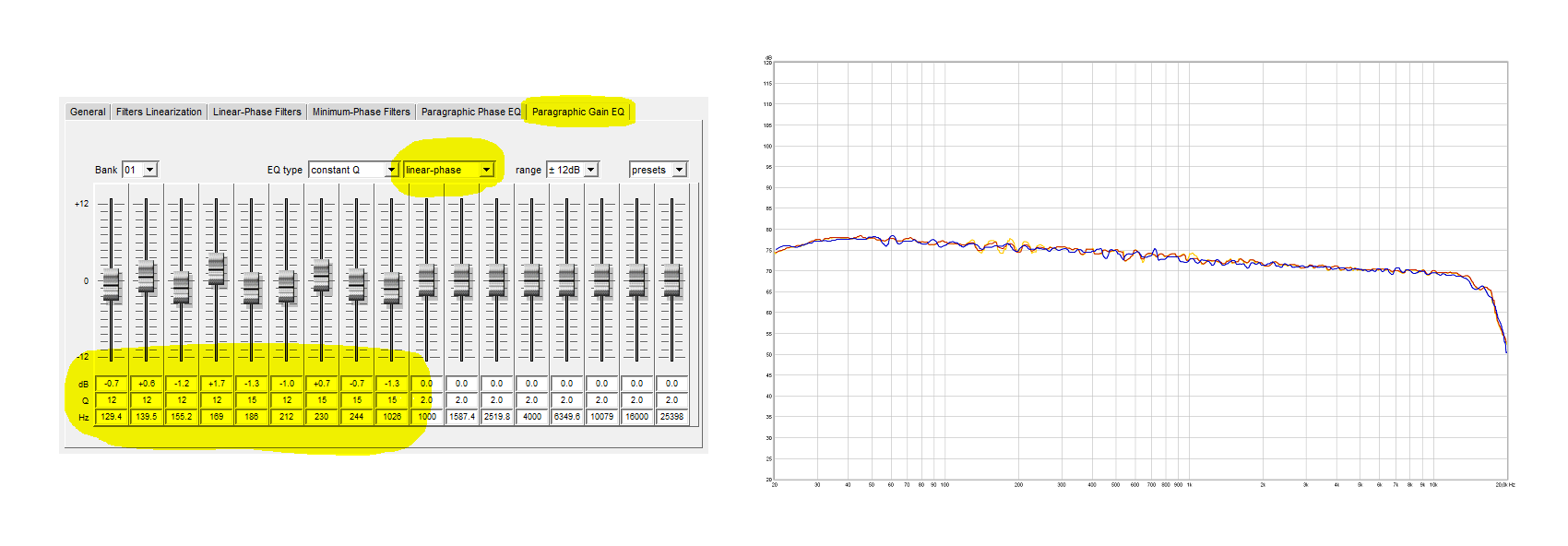

As I now have found an easy trick to combine FIR filters I figured to EQ my phase too. Really only fine-tuning it as DRC has done the hard work already.
Did you post about the way to easily combine FIR filters? Don't remember reading about it...
Ah... I wish my phase looked like that! I guess I have way too many reflections in my concrete room.
Right here: http://www.diyaudio.com/forums/full-range/242171-making-two-towers-25-driver-full-range-line-array-219.html#post4694469
I've been using it extensively ever since! If you need the peak to be exactly at the same position, the hardest part is to edit out the silent, that I fist add to the beginning and end of the file. I suspect it only to be of importance if you run more IR's simultaneously though. Like I do with my ambient channels.
