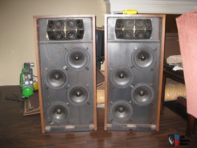

I wonder if having two tweeters, horizontally arranged, maybe 6 inches apart, on each side, might do something similar to what the shuffler is trying to do? One tweeter has a problem with two ears, so two tweeters might have either twice as big a problem, or possibly almost no problem at all (?) My brain keeps telling me "math overload"... Too busy with too many projects right now to handle the math of such a thing.

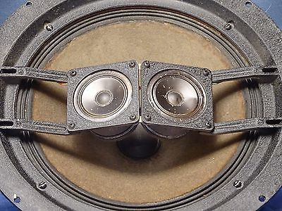

Bozak did tweeters something like that back in the 1950's, but with 2 inch cone tweeters horizontally adjacent and aimed slightly outward. I tried that in one speaker system I built back in the 1970's and thought it sounded good (no obvious comb filter effects - but I wasn't really listening close for center image clarity).(this is the wrong thread for this, isn't it?)

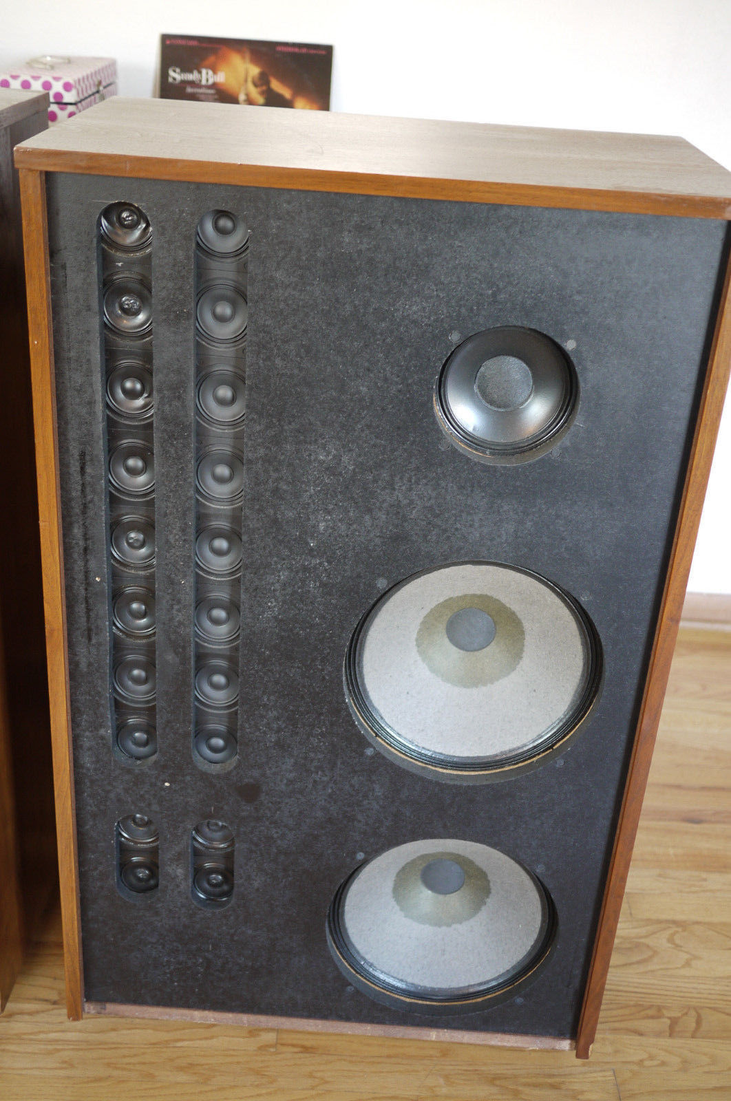

If I look at this one:

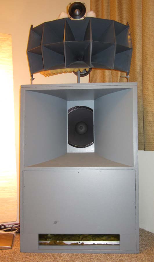

It sort of reminds me of Pano's Altec setup:
We know even that one needed a shuffler, so I think this wouldn't help.
