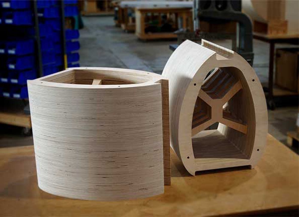

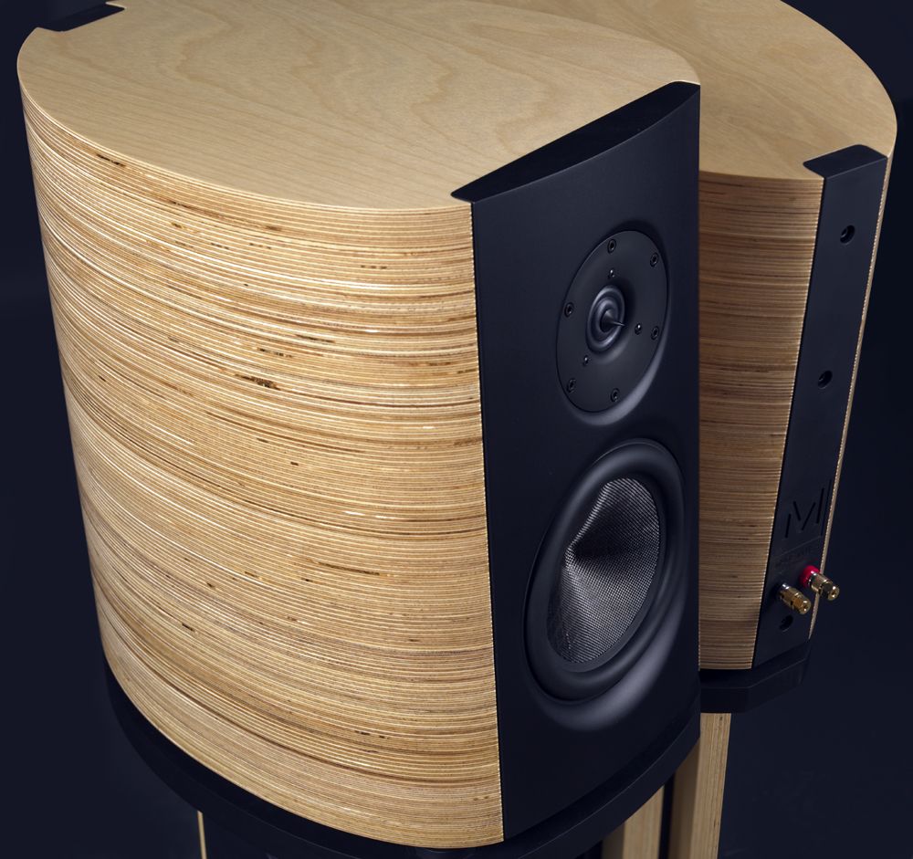

I had a reason for every step I took, and have no regrets. I liked aluminium for the baffle as a material for it's rigidity. I wanted to make a durable product. I took the steps needed to damp the aluminium and believe damping it is crucial. Corian like materials should work too.
After I started my project and cut the first few pieces I stumbled across the Magico Mini speakers. I swear I had not seen them before making my own decisions, but took note on what they did and how they did it after finding them. They have some cool features in the Magico Mini II enclosure. I like how they connect the front and back with tensioned rods. That way they can have an uninterrupted stack of ply and still mount the baffle in a sleek way without hindering the expansion and contraction of the wood. I doubt it would work with a big stack like mine though.
Magico went to an all aluminium enclosure after this one, but optically for a mini monitor (of huge proportions) I still think this one wins the price. But if the Sonics rule....
I am more than pleased with my enclosures, they seem to be the only part in my living room that's completely inert when the music is blasting. You can lay your ear on them and not pick up any sound or movement while the music is blasting full force. I used at least 5 different damping techniques to get there though. I figured every detail counts.
Perceval already went over the reasoning behind the wavy shaped interior. One is to disrupt the back wave (though one has to consider wave lengths to determine how successful that can be) and the other reason to vary the wall thickness was to prevent it from being one big resonating surface.

The Magico Mini was actually part of my inspiration. I heard it once and it was terrific, I liked it better than the current aluminum body Magicos. The baffle mounting is indeed interesting but may be a bit ambitious for my first project!
