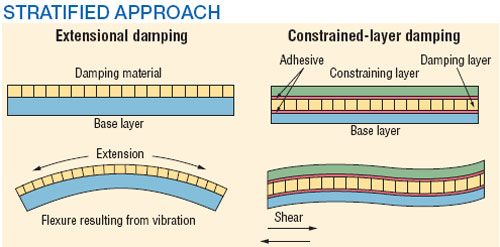

Constrained layer damping is using 2 rigid materials with a flexible layer in between, sort of like this:
It's common practice in Car Audio to use constrained layer technique to damp the outer sheet metal of doors with damping matt made from butyl with an aluminium layer on top.
For thicker materials you'd need a bigger flexible layer between two more rigid outer shells...
In a way my front baffle, made of 2 aluminium pieces with butyl rope pressed in between is a constrained layer construction, weighed down even further by a layer of mass loaded vinyl on the back side of the inner baffle, with neoprene behind that to seal against the enclosure.

Somehow this part did not sit well with me and stayed on my mind....
Consider a pressure build-up in a speaker, Now place a double wall at the outside, with a flexible layer glued between them. Once the pressure wants to move/vibrate the inner wall, the flexible layer is holding it back due to the shear load on the flexible layer:
![constrain.png](https://www.rsr-concepts.com/diyma/constrain.png)
Like the situation at the right of this picture I posted earlier:
![568566d1473287450-making-two-towers-25-driver-full-range-line-array-stratified-approach.jpg](https://www.diyaudio.com/forums/attachments/full-range/568566d1473287450-making-two-towers-25-driver-full-range-line-array-stratified-approach.jpg)
Now picture the Birch ply stacks, with a gasket in between and the same pressure build up in the closed back chamber, again trying to move/vibrate the wall:
![gasket.png](https://www.rsr-concepts.com/diyma/gasket.png)
You could still call it a shear load, but do you see the difference? The gasket itself is under load and the pressure build up will try to bulge the walls, including the gasket. Only the vertical pressure on that gasket is holding it in place. (and the glue of coarse) It will still damp somewhat, depending on that vertical pressure, but it would also mean the pressure being different due to humidity changes (wood contracting or expanding).
So I wouldn't call this a constrained layer construction. You might have figured this out already, but it didn't sit well with me, I had to mention it...
