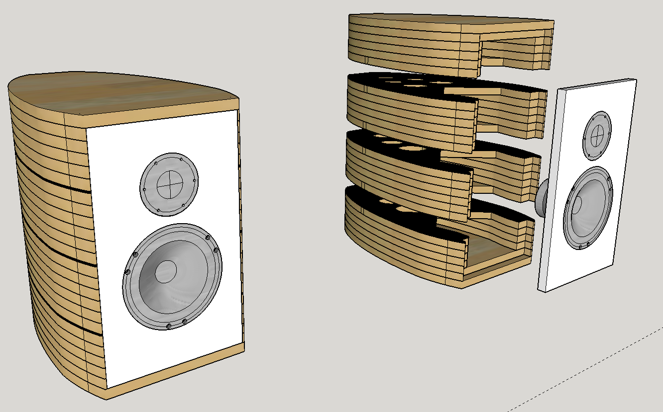

Alrighty, I have dug deep into SketchUp (thank you Ronald for that recommendation!) and I have my first design exercise to share.
This is the translam design that I've mentioned, built in four sections with a 1/8" neoprene gasket between the layers. There will be 6 1/4" rods bolting it all together (maybe I should do 8?) It's a pretty big speaker due to the 2" thick side walls. but I like the dimensions. Thanks to the wonderful area measurement tool, I was able to get the internal volume to .94 cu ft, just slightly off of the .95 specified for the kit. I'm still not crazy about the top piece. I want to hide the bolt heads, but include the top piece in the bolted sections. On the bottom, I can just recess the washers and nuts, but the top remains an issue.
I still need to layout the mounting for the baffle. This design will require the baffle to be screwed at a perpendicular to the plywood face which I really do not want to do. I would much rather bolt it in, but that would require a parallel back surface to the front mounting area which would require compromising my wall thickness or widening the front baffle -which I do not want to do. I'm probably going to do a 3/4" Corian for the initial baffle. Ultimately, I would love to do two aluminum layers, perhaps a 1/2" each with a gasket between, similar to Ronald's design.
Since I will ultimately move toward electronic crossover, I think I'm just going to do the crossover externally and have a pair of binding posts go directly to the drivers on each speaker..

A word of warning that neoprene most definitely shrinks over time. So beware if you are planning to make it flush with the outside of the enclosure as eventually it will pull in. You would be better off intentionally set it in a small amount as a design feature. This caused a real problem with a project I did with JBL after they discovered that the neoprene they had die cut for the front of an enclosure was shrinking back and didn't look right. Expect to need to re-tighten the compression bolts after some time. Nice look though, this has become a classic shape at this time.

I'd like to add that though it might look good to have the baffle sit 'inside' at the top and bottom, I'd worry about the difference in expansion rate of the enclosure and front baffle. That's why I liked the Magico Mini, that baffle is totally independent from the movement of the wooden enclosure. The wood is able to contract/expand without affecting the baffle.
