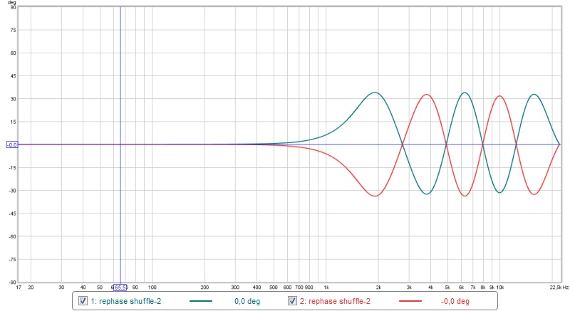

Ok, lets go, one track, two versions. I chose a song by Anne Bison. Clear central voice, some spoken words even, generally a good recording.
Both have been extracted in a similar way to minimize side effects. If you like the song, go buy the record please.
Disclaimer: this song is used for a test, it is not my intend to break any copyright rules by providing this song in this way.
Taken from a CD version:
Camillio-A.flac
Camillio-B.flac
(please right click and choose save target as... or any other way to download before actually playing the track)
The only difference is one has it's phase shuffled. The average SPL levels still match, wav length is the same between the two, flac shows a little difference in size.
These two tracks are meant to be judged at ~2.5 to 3.5 meter distance in the exact sweet spot. That's where the difference should be the most obvious. Preferably in an environment without significant early reflections in the first 10 ms. It's also important that the FR curves of the left and right channels are a good match. You guys decide for yourself if you comply to these guidelines. Martin already showed us proof he does comply
It won't work as well to take this test in a reflective room with (many) early reflections. Stereo is a must.
Can we:
- hear a difference between the two tracks
- If there is a perceived difference, how does it present itself?
- do we prefer one over the other?
I meant to take the test myself, by playing the two tracks in random order as I obviously know which one is which. Sadly I ran out of time to do it. My house is taken over by my son + friend
. I'll try and take the test on Monday.
Hope to hear from you guys...

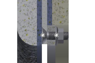

Hi guys. Sorry to switch topics, but I'm rolling along with my designs and could use some feedback. Still working on my translam 2-way sealed box design. I am working on a re-do without the constrained layers, I am taking the advice given and plan on just gluing all of the layers together. I am also working on a bit more interesting shape.
I could use some advice on the baffle. I have some really cool faux-marble Corial material, just enough for the two baffles. However it is only 1/2" (12.7mm) thick. I also have some 1/8" (3.2mm) aluminum sheet. Would this Corian work or is it not thick enough? Would layering the Corian and aluminum work well? I think the aluminum would provide a nice rigid base for the driver bolts, but I wonder if the total baffle thickness of only 16mm is enough for the cabinet. Also, would you just bolt the Corian and aluminum directly together or add a layer of neoprene or another constraining material?

It would largely depend on what you want to accomplish.
I'd probably use a CLD layer glued between the two. But I'd also use a (damping) seal between the baffle and enclosure.
What I wanted to accomplish was a bit different from your proposed baffle/speaker construction.
I wanted to have the drivers firmly bolted to a stiff aluminium plate and have that entire construction "float" between two (CLD) damping layers without direct contact to the enclosure. So any vibration in the drivers would not make it into the enclosure, at least that was the idea behind it.
How are you going to mount the driver to the baffle? And the baffle to the enclosure? What are the goals of this construction, other than having a firm baffle?
3.2mm aluminium is very thin though. How about bolting that directly to the driver, have a neoprene layer on both sides of the aluminium and clamping both between the Corian front and another similar material behind the Aluminium? It's still thin though, for that function...![xeye :xeye: :xeye:](https://files.diyaudio.com/forums/images/smilies/xeye.gif)
I can see using it as a part of a constrained layer like the thin alu foil on damping sheets for the metal in cars.
I'm guessing you want something that would avoid having to use bolts in the Corian front? At least for the drivers...
You're proposing to work with 2 dissimilar materials. That's not a bad thing in itself. But it's hard to predict what it does once you combine those two. As both are relatively stiff materials I'd go for a constraining layer between them.
But this still leaves you with the question how to mount the driver. As the driver frame will have it's own set of resonances.
Adding weight will push resonances down, making it stiffer will push resonances up... where do you want them
. Both have been done before.
Just thinking out loud by the way... I have no real useful answer for you here...
I hope the translam will work out. No idea if it will hold up, like I said before. I can't advise you on how to do that either

You might make it way harder than needed, yes...
Just to entertain myself I did make a picture of what I proposed (lol)
Way too complicated of coarse, the blue (3mm) parts are neoprene or sorbothane, the front is the baffle, the alu is bolted to the driver frame and another sheet of 10 mm "something" is supporting the back. The 3.2 mm alu would support M5 as the biggest fastener.
What about a Corian baffle, double up with birch ply with neoprene in between.
Mount the driver to the Corian (flush of course) Or to the Ply (inset with filleted hole in the Corian). Simple, effective...
So the drivers recessed into the 1/2" Corian followed by a layer of neoprene and then a 3/4" layer of Baltic birch and then another neoprene layer and mount this whole baffle structure to the cabinet. I like it! The advantages of the constrained layer baffle, nicely rigid at over an inch thick and much easier to work with than aluminum. This is what I'm going with. Thanks Ronald!
