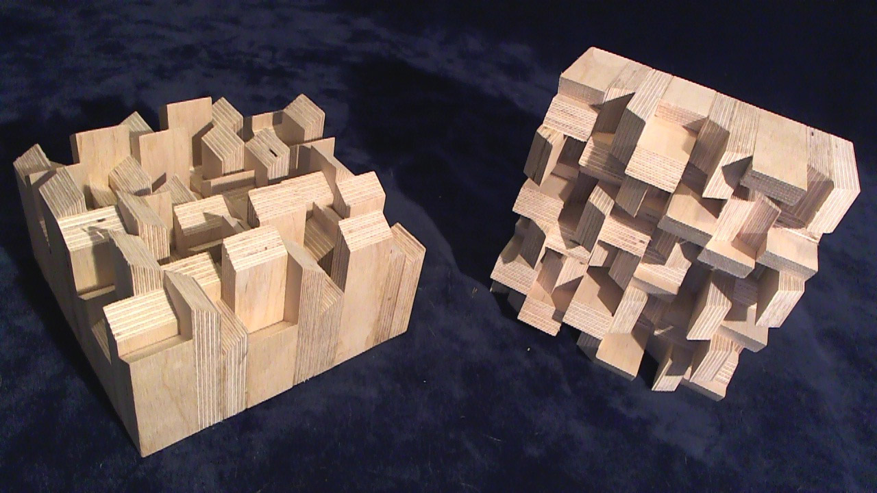

Artsy,
I tried myself to link to the page and as you found the link doesn't work correctly. I purchased this material more than 20 years ago and things in their catalog do change over time. I really don't remember there being a Kraft paper layer on either side of the glass, I know for a fact it was not covered with a foil layer which I would suspect highly would be very reflective at specific high frequencies.
Anytime you change from one material to another such as glass to air to glass you will have a wider bandwidth of absorption but how significant would depend on material changes and volumes. The real difference between one 2" layer and double that thickness would that the thicker section would just have a slightly higher absorption over what I would suspect would be a narrow band at the lower frequency limit of the materials properties, I wouldn't expect an across the band increase in absorption,
I would never consider that any of these materials would be great at the lower frequency range, the bass range as the wavelengths are just to long for any type of material to really have a great affect. Most of the commercial bass traps are really not bass traps but truly I would call them mid bass traps unless you would want to look at the properties of stuffing a long tube and the length of that tube, it is not the transverse distance that would absorb bass frequencies, they would basically pass with little effect.
I agree with osterhammer that a combination of absorption and diffusion is the best solution to use. Add some uneven reflective surfaces with panels and I don't think you can do much better to help a room. A bookcase with books of varying depth could be used as that reflective surface or anything else that has a varying depth to scatter the sound.

I wouldn't want to use diffusion panels or otherwise in my room for one simple reason: it's just too small! But only removing the strong reflections leaves enough diffusive energy in the room. The ambient channels have the added benefit to help to get the RT30 plots in REW look more evenly spread across all frequencies which helps stabilize tonality.
Just look at the room jim1961 build where he uses diffusion to re-route the energy, letting it arrive later in time at the listening spot. At the present he is experimenting with ambient speakers and a Lexicon device to simulate the parts you just can't have in a small room.

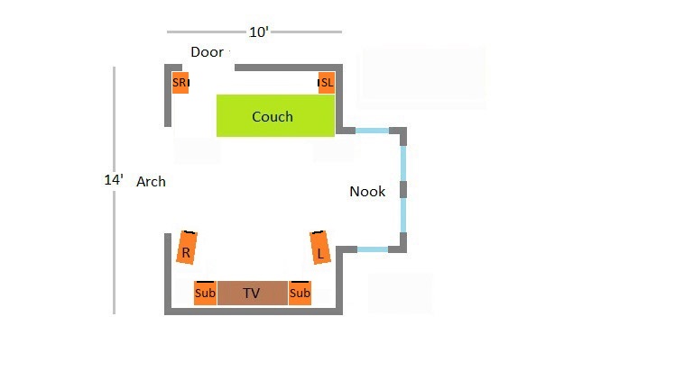

I included a drawing of my room. It is 10 by 14 feet. Small, but as You can see, the bay window and archway into the next room helps a lot. My initial thoughts would be to either:
Do the front half of the room all diffusion and the back half all absorption.
Or do the front wall diffusion, the front side walls absorption; and the back wall absorption and the back side walls diffusion.

You don't have enough room to place the speakers away from walls. So use them to strengthen the bottom end, but at the same time avoid as many reflections as possible.
I wouldn't use diffusion on the front wall or back wall in a room of this size. Its actually quite similar to my room.

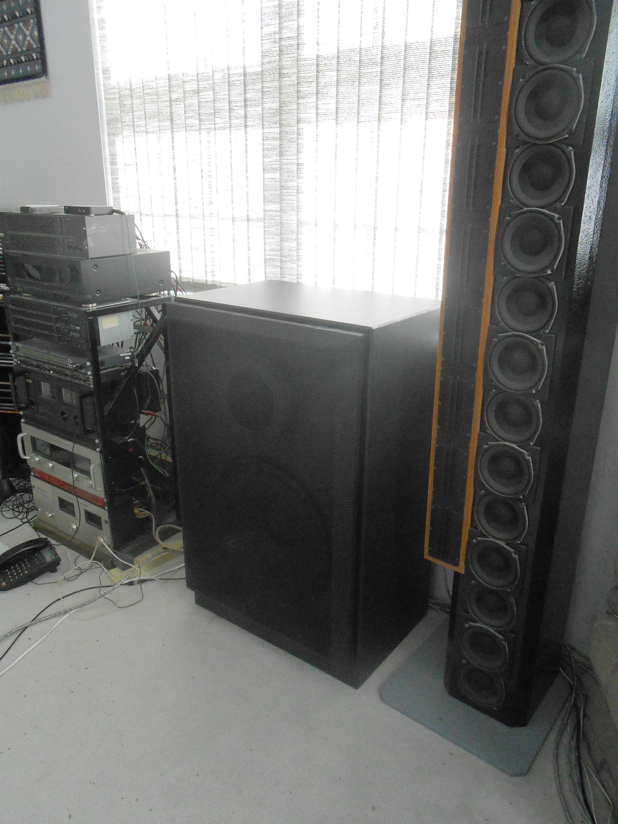

Hi Wesayso
I have just discovered your thread, which has obviously been in progress for some time. Your build quality and I'm sure sound quality is jaw dropping. I too am convinced of the virtues of line array design. I have built 84 inch tall cabinets with 16 drivers each, 5 & 1/4 inch diameter. I choose 16 drivers to present an exact 8 ohm load to the power amplifier. The diameter was selected to extend the low frequency limit.
I am surprised that your drivers are providing full range coverage. My design philosophy was to provide HI FI performance at Rock concert levels. I have built 2 (sub) woofer cabinets that are driven by a modified 1000 wpc Crest CA-18 amplifier.

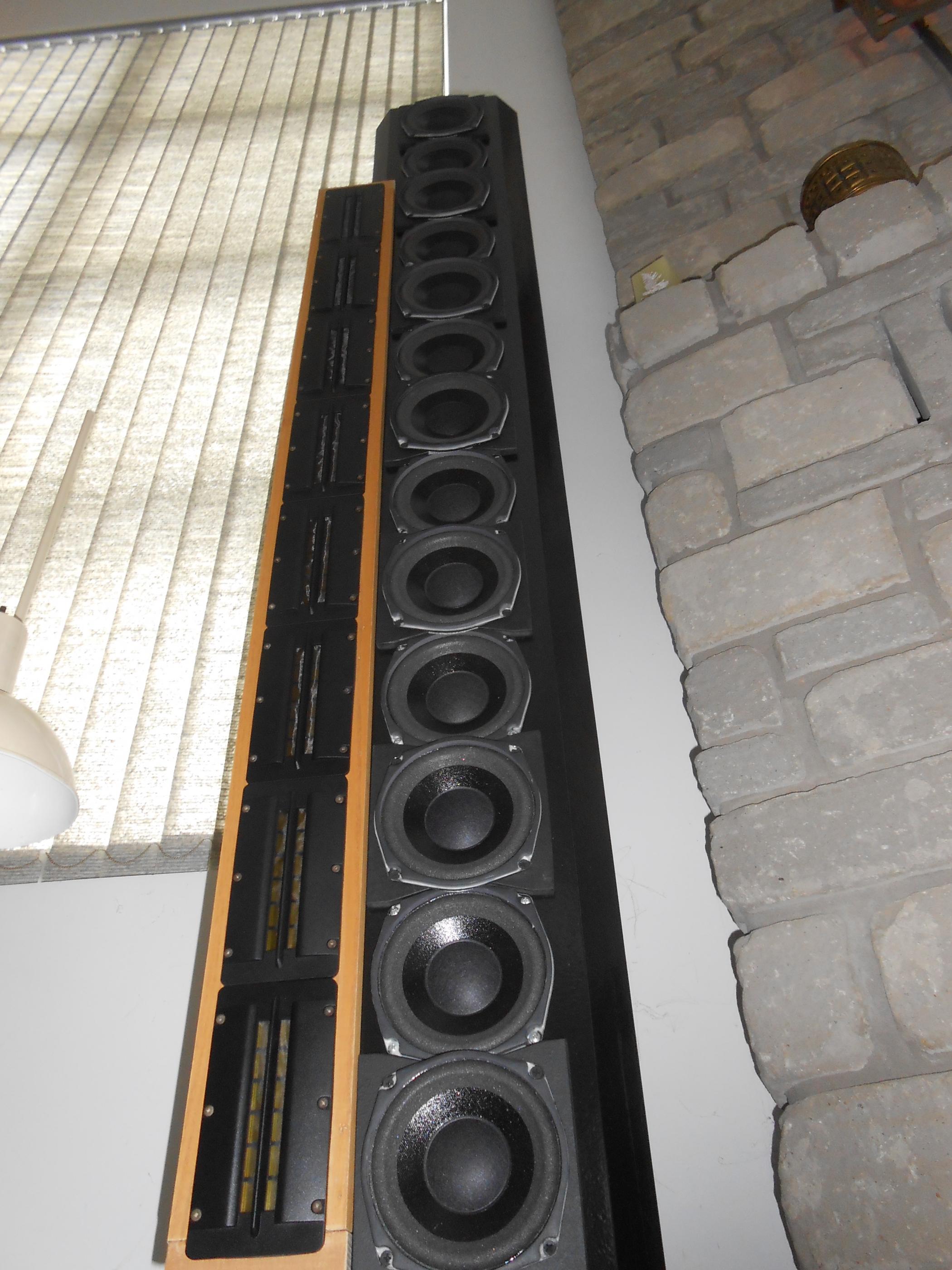

I wrestled with the positioning of the Plannar Tweeter Array. See Attached Photo. I believe that there could be some interference issue between the MF and HF arrays, But I am very pleased with the sound. I am toying with the idea of a (32 db/octave slope) active cross-over to replace the 24 db/octave unit I am using. Your thoughts? My project appears somewhat crude, in comparison to your line arrays, but I was very interested in getting started quickly!

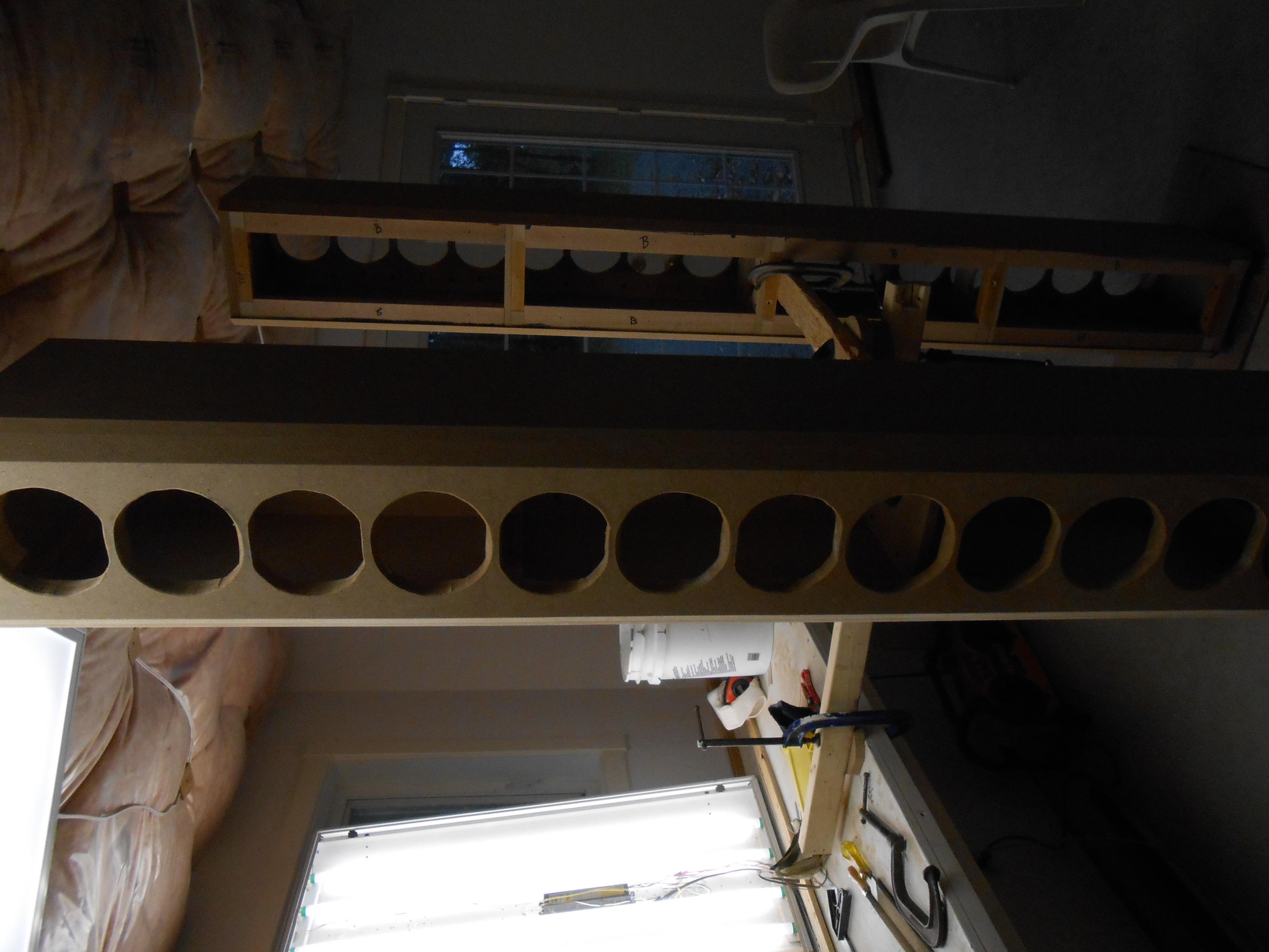

Hi Kindhornman;
I believe your were referring to my line arrays. Although not the prettiest solution, I thought it was clever to overlap the drivers, for two reasons. First; to reduce the centre to centre distance of the drivers. My research told me that when the driver spacing exceeded half the wavelength ( C to C ), the drivers act as individual sources, with the corresponding interference patterns. I believe this to be far more of an issue than the 3/8 of an inch that the drivers had to be staggered, to reduce spacing. At 2 kHz, 3/8 inch is a small fraction of a wave length.
