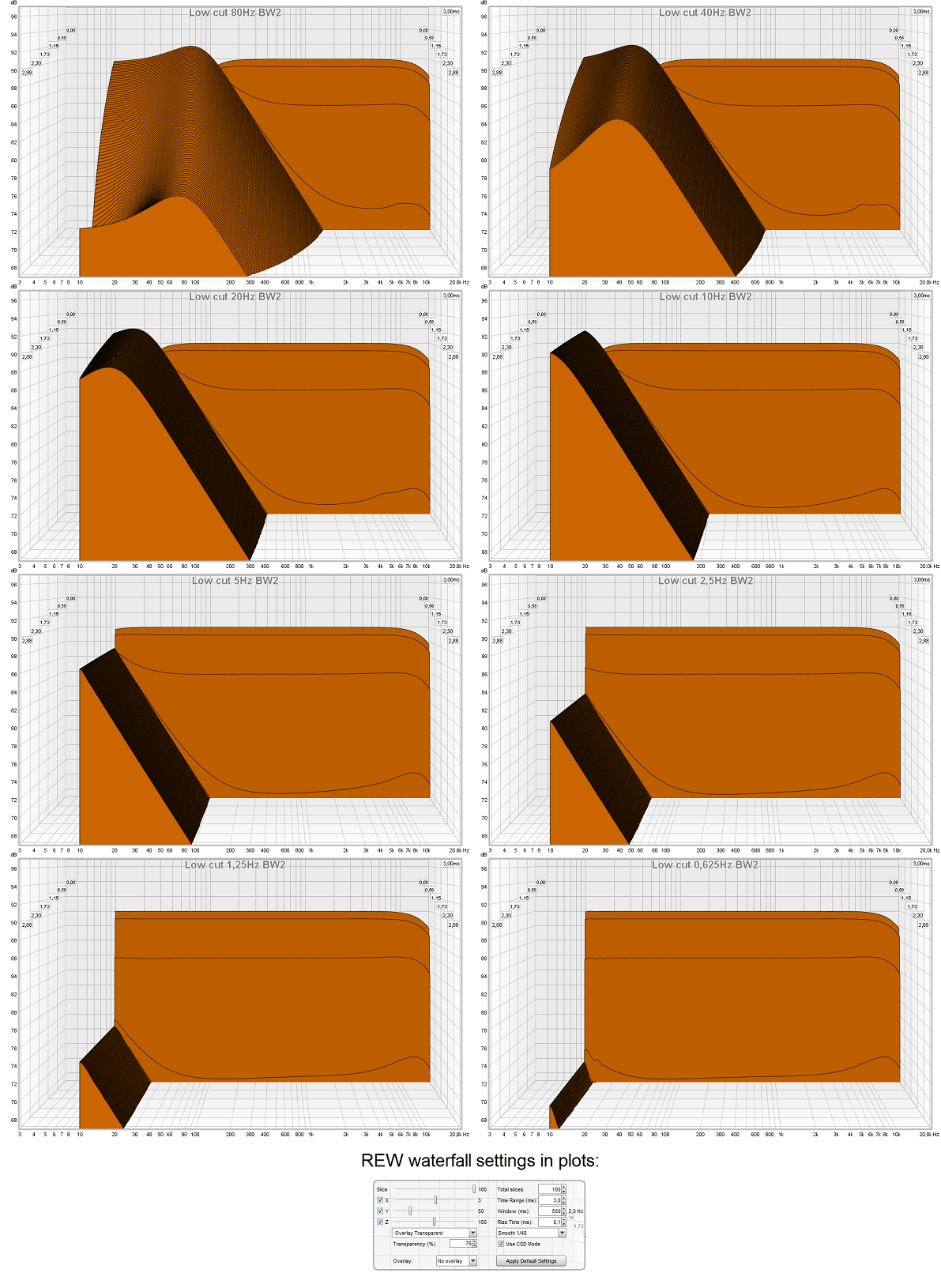

This plot within REW has always made me wonder:
I'm always puzzled by it, how does it get/interpret that graph. To me, the APL plots make more sense (here centred at 23 ms).
Here's the APL measured plot of my DAC. that makes so much more sense to me visually than how REW presents it's graph. I can compare that to what my arrays are doing...
The REW plot always makes me wonder from which side I'm viewing the data. For it being a straight edge all the way down as in your lowest cut-off does not relate to the APL plot of my DAC. That one shows a gradual build up at bass frequencies on one side and the drop off on the other side.

...The REW plot always makes me wonder from which side I'm viewing the data. For it being a straight edge all the way down as in your lowest cut-off does not relate to the APL plot of my DAC. That one shows a gradual build up at bass frequencies on one side and the drop off on the other side.
If I understand correct then expect your first APL_TDA plot is a perfect impulse DC to lightspeed probably created in Rephase, and second APL_TDA plot is a DAC loopback. If that is correct it makes sense because both sound card input and output have delay because of AC coupling capacitors and that delay is the ridge curve swinging to right side in low frq area, so what happens to right side of ridge is what we look at in REW waterfall but inverted, and with that i mean in REW low frq are at left side and high frq is at right side but if we go stand at right side in APL_TDA and face wall we will get low frq at right side and high frq at left side.
Does this sound right or have i something wrong about plots, will have to leave 1-2 hours and get back.
No, the first plot is a measured result of my DAC by routing it's output to my soundcard's line-in with APL_TDA.
The second APL plot is a measurement with mic in sweet spot of my arrays with APL_TDA. As can be seen with the little stuff being upset in my room on the right side of the graph.

Back again and see was wrong reading your plots, which else suited my logic to interpret and explain
