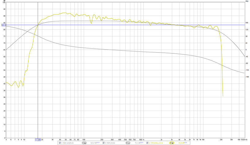

Here's where the 17 Hz figure comes from:
This is how my EQ is set. Notice a roll off at the low end. I have made the mistake of not looking at that roll off carefully enough.
Hope Mayuri doesn't mind but I will take his graph as an example:
See how the EQ is set? With a big bump at 10 Hz? On ~98% of recordings he will be fine. But I bet he will get a scare sooner or later if he keeps that graph like this. Listen at 88 dB to 92 dB average and all of a sudden you think: what was that! Especially if he leaves the door open.
As far as i know the the softer the roll off filters for a given band-pass (read audio band) the less errors as ringing tails and better the timing is, therefor could we roll off 1. order as with OB or improve on 2.order BW as sealed box perform to a Bessel 2. order that is little softer roll then it would be preferable. In below have traced above TC9 lines curve overlaid with approximate B&K curve band-pass 17Hz BW2 - 20kHz BW2 and they cross actually at 17Hz for B&K -3dB point. Up in HF how real roll off slope are we probably can't conclude further without have to sweep with much higher sample rates and maybe needs better microphones too.
Do you believe in softer slopes improve on sound stream quality and what is meant about "mistake of not looking at that roll off carefully enough".
Agree that realism improve very much having real amplitude down at very low frq and good timing although sometimes think about the timing thing that it would probably be even better we had exactly same slope and timing including excess phase from XO's as a given track was mastered to be in close to same audio situation.
By the way talking low frq rumbling or DC thumbs the track we auditioned on TC9 lines and that sounded crazy good "Stephen Stills - Treetop Flyer" seems has a lot of that low end when looking at my woofer.

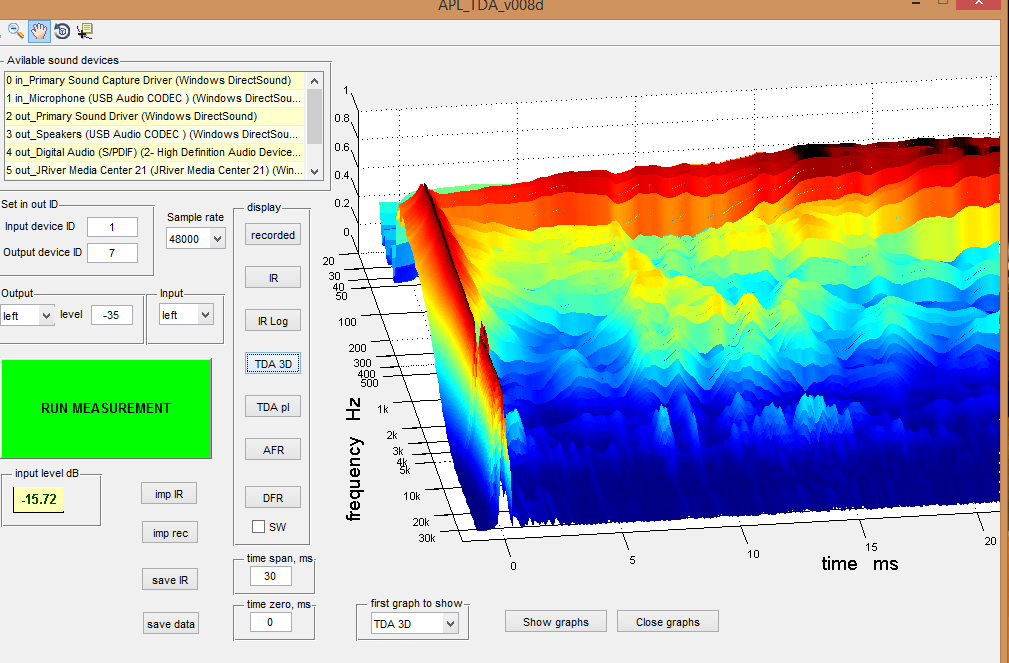

That makes sense. Now these graphs are starting to connect to something I can understand. These reflection drawings come to mind:
Sensible Stereo Recording
I will try some treatments between the side corners and the speakers. I will see if I can dig something up this week end...

By that I mean that having the slope too gentle on the low end can really byte you on some material. It could cause wildly flapping cones if you're not careful. The slope has been made a little more steep to avoid such behaviour. That's done without too much phase changes as I do have that choice.
I kept the shape of the frequency curve up till 17 Hz, but deliberately went a little steeper lower than that as that could damage my setup (it would need more cone area and/or x-max than I have to offer, as well as amp power)

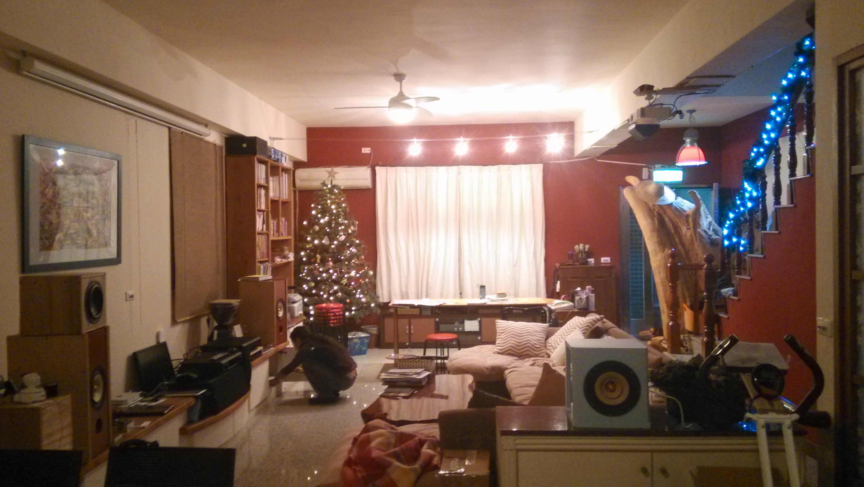

Just so anybody else feels good about their not so horrible rooms, here's mine, which is the living room... a complete audio nightmare.
It is roughly 5m x 9m. three doors leading to a bathroom, a kitchen and a mall room, plus a staircase right behind the couch... like I said... horrible.
I don't have any other options, so this has to do for now, until I change my job or my house!
I have a MAJOR reflection from the back wall (not shown in this picture) which is cement, about 1m behind my couch. There is no possibility of adding an absorption panel there, so I have to live with it. For this measurements, I stacked a bunch of pillows on the wall behind, so that huge peak is not showing. But it is a red spike at 10ms and 10k... and located in front of that other mountain at 1k and 10ms.
Also, the other reflection in the middle at about 1k is from the ceiling. After testing, a little like wesayso and his foam/fiberglass pads in the picture above, and moving them around, I found that it is indeed from the ceiling... again, nothing much I can do there.

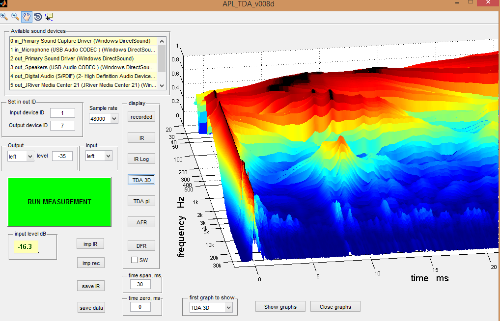

First picture is the ported box, second is the dipole. 3rd picture is the dipole with a sealed sub playing right under it. Seems it was interacting with the corner sub...

It gives me no clue why that sub is turning up that late in your APL plots. Or am I looking at it all wrong. The 2D plots make it easier to see what part is played at what timing, it's no surprise that room is messy with the hard surface. Though improving the timing might help clear it up some.
Hard to judge what we're looking at though. That last graph shows a build up of low energy that seems to peak at 30 ms or more, That's not the sub, is it?
If it is, the distance to ear is almost similar to the distance to the speakers, why would it be that late. The other plots are harder to make out. A flat 2D view might help.

Ceiling is flat cement, a small ceiling fan in the middle, in front of the right speaker (when looking at them). Big cement beam going front to back between couch and dining table, 25cm wide, 50cm high.
I don't expect a miracle. This room is a nightmare for reflections and bass escaping through the staircase.

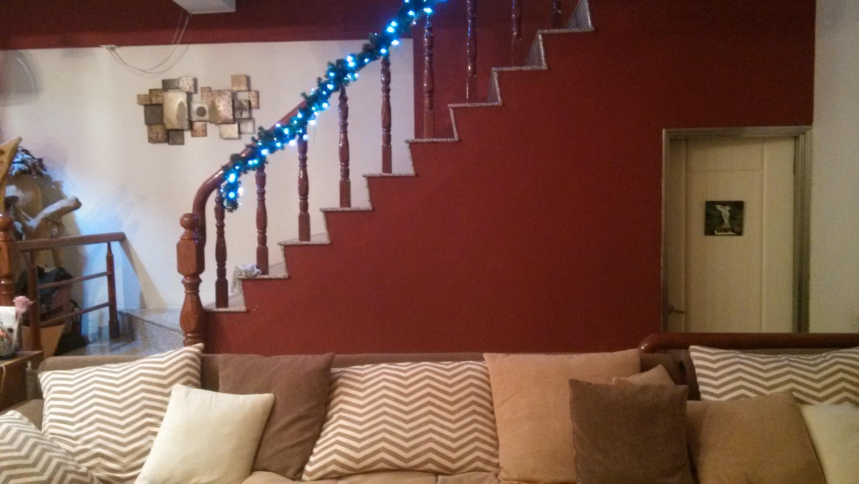

The issue here is not even WAF related.
That wall leads to the bathroom the students are using here. Kids LOVE touching things and if I were to put a dampening panel there, it would get so dirty so fast...
Plus, the wall is opened to the staircase going up, it's not a nice flat wall.
