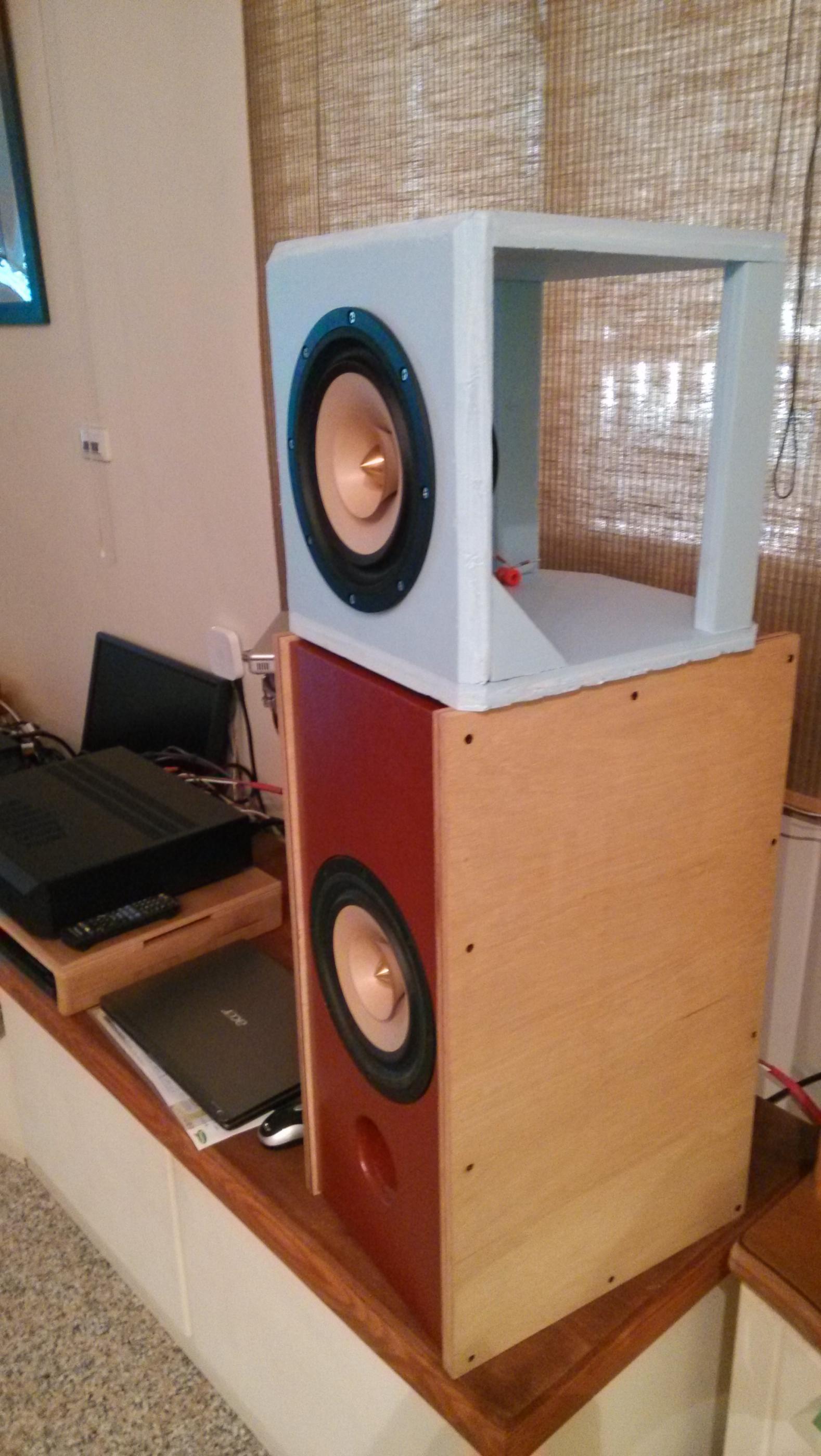

To come back to the previous post, I had a small test with one W8-1772 in a ported box, and another on an OB mounted on top of the ported box. Guess where I got that idea?
It was special and gave me back some of the spatial cues I had with my previous line arrays. So, I'm doing a stereo setup. Sounds nice, but there's something different I have trouble to pinpoint. It's a bit weird, it's got more spatial clues, more ambience, more 3D like, but at the same time, it is more accurately centered...

Here's what I'm playing with... but measurements will have to wait one more day.

Yes, a mega Brio Trio! I like the sound. It's spatial and focused at the same time. Plus having two 95dB drivers each side makes for a seriously sensitive setup!

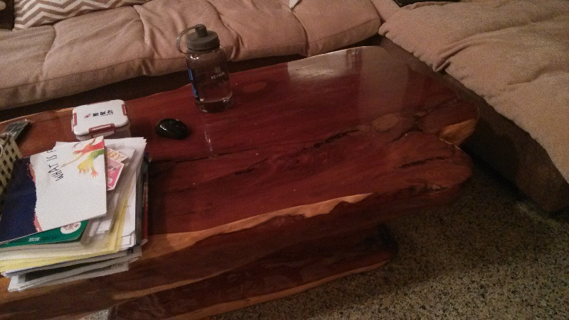

There's is a reflection off the "coffee" table, but it is second to the reflection I get from the back wall.
Lately, I've been moving the speakers off the wall and a little closer together, about 4 feet off the back wall. It sounds nice.
But, it's only for occasional listening, most of the time, they have to be back on the shelf closer to the wall.
As for the "coffee" table.... it's not going anywhere soon.... It's a solid piece of camphor wood. That thing is as heavy as it is expensive! It was given to us by father-in-law. He used to make tables and vases from camphor wood. We have another gigantic piece of wood in front of the main door to the house, as a Feng Shui thing.
Like I said, this room is a disaster for audio duties, but it is what I have.
![586671d1482164816-making-two-towers-25-driver-full-range-line-array-coffee-table.jpg](https://www.diyaudio.com/forums/attachments/full-range/586671d1482164816-making-two-towers-25-driver-full-range-line-array-coffee-table.jpg)
