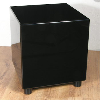

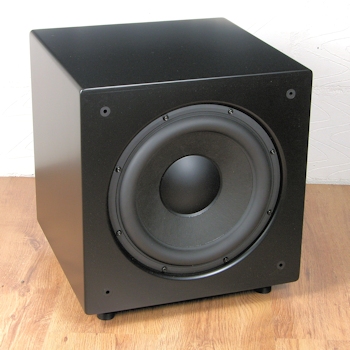

Down firing subs don't show, wives love that!
I've looked at the XXLS400 subs for inspiration, both models I found,
the normal configuration:
And the down firing one:
I'll probably cover them up with the current fabric, mount the woofer like I did on the arrays.
