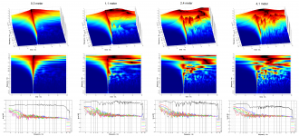

For grins here is one APL_TDA plot.
Its not a living room but a hobby room in cellar full of spread out furniture and strange tools standing all over place and no room treatment at all. Speaker is FAST system 10F/8424 with 10 inch German Kevlar woofer and XO is LR 8th order linear phase at 355Hz. With both L and R channel from stereo track routet to same speaker while it sound fantastic with nose on axis at 0,3 meter will take some huge work and care to get anywhere bit near to what acoustic performance wesayso show.

We've done this back and forth a million times. Why is it so hard to believe a measurable difference can really be perceived as a difference. Do that APL plot. (even said that before)
It might scare you how that looks at the listening position.
One more thing, I never used APL_TDA to clean up my measurements. I only used every TAB in REW. I had to hunt down what I was looking for. The APL plot was just me running that demo. I wish I had it available when I was fighting my room. I know were every ripple in that plot comes from, bizarre right? I was devoted to it to keep my sanity in one of the lesser periods in my life. Just to learn.
