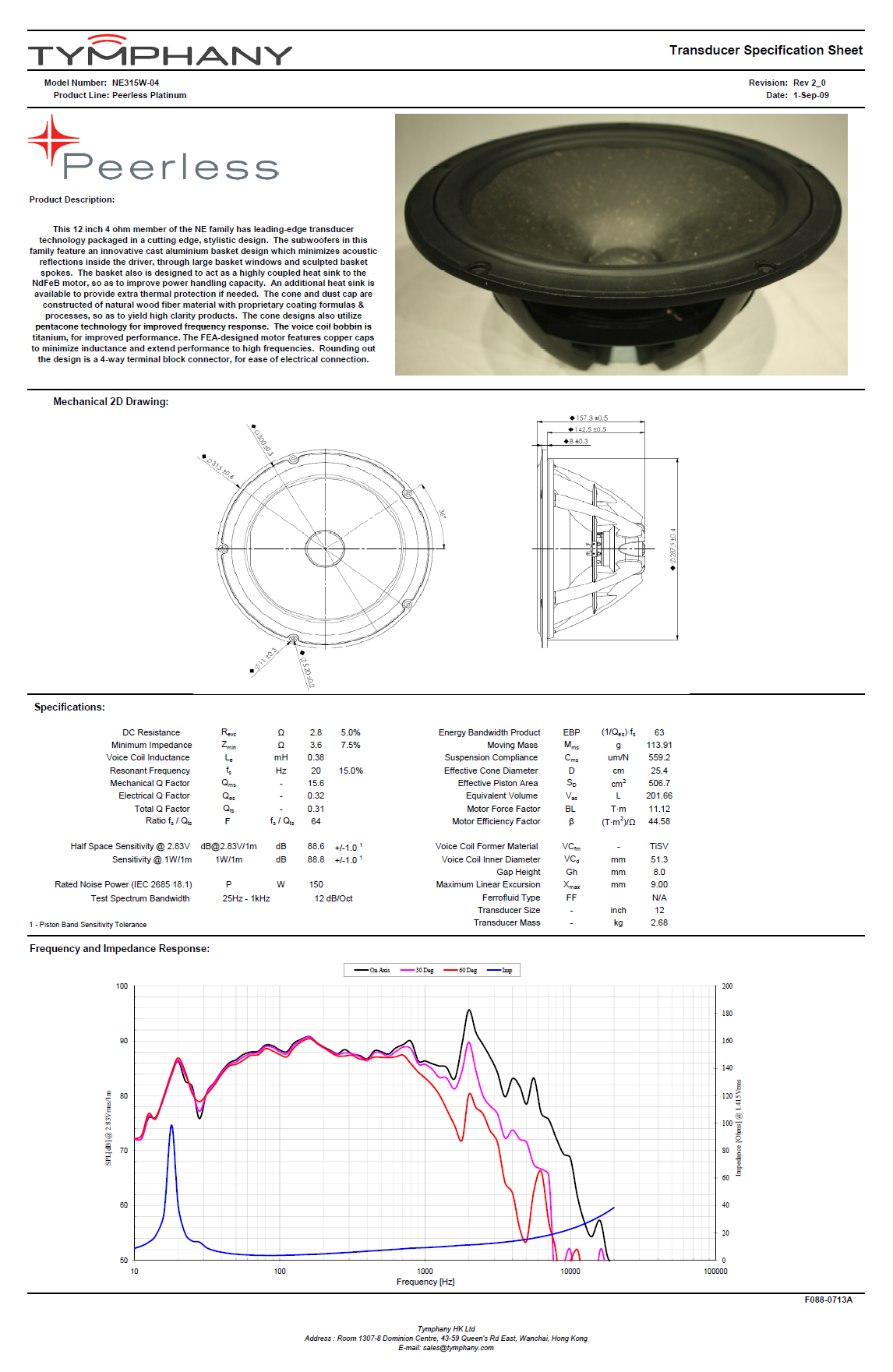

Where are you getting those cheap 30W's? I thought the Peerless would be cheaper?
Price range of most SS 30W are around € 225.00, cheapest found at € 207,10.
Price range of XXLS is around € 250,00/260,00, cheapest found at € 221,30.

For that price I would get the 30W.
Definitely leaning that way. But I still have time...
Yes I did look at those. They don't have a clear advantage for me over the 30W/XXLS.
Meaning they would cost about the same over here as the 30W/XXLS.
I found some very convincing data on the 30W in several places. Not seen comparable plots yet from the Dayton, the Dayton Audio RSS315HF-4 12" Reference HF Subwoofer is the one that caught my eye. If I could shop at US prices I'd buy one immediately, just to try the theory.
Don't want to sound like I disapprove of them, all I did see were a lot of favourable comments. In a separate HT room I'd add 4 or likely even more and be done with it.

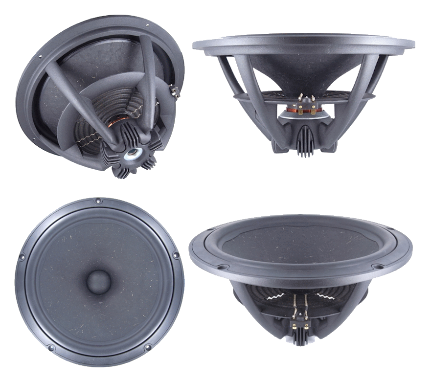

Wesayso, been doing some research for you....
What about a pair of these:
TIW 300 - 8 Ohm
MMS 92g
BL 16.5
Nice FR.....
TIW 300 - 8 Ohm
MMS 92g
BL 16.5
Nice FR.....
