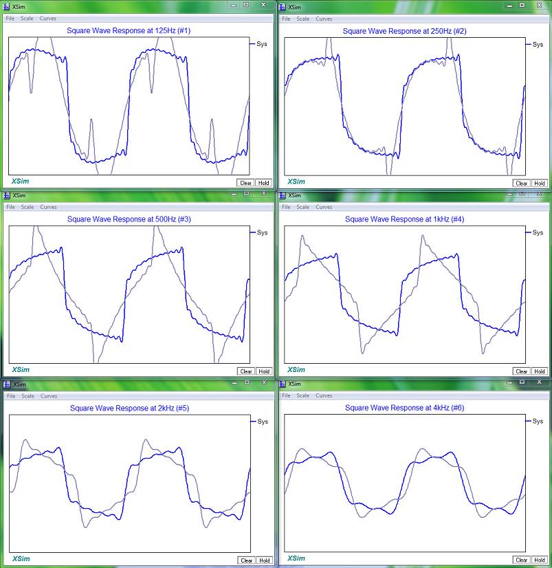

🙂 guessed for your 48dB/oct IRR XO it is LR at 80Hz and adding that slope gives below plot in the middle regarding timing target in APL_TDA:
attachment.php
Into XSim blue is tracing of Ronalds system response same as lowest plot above, and grey is same system response plus IRR LR8 XO at 80Hz:

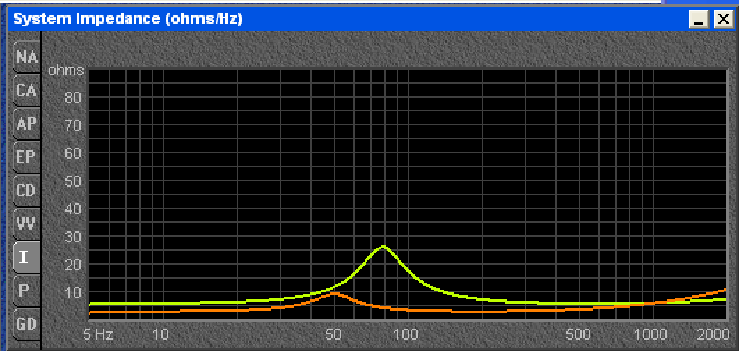

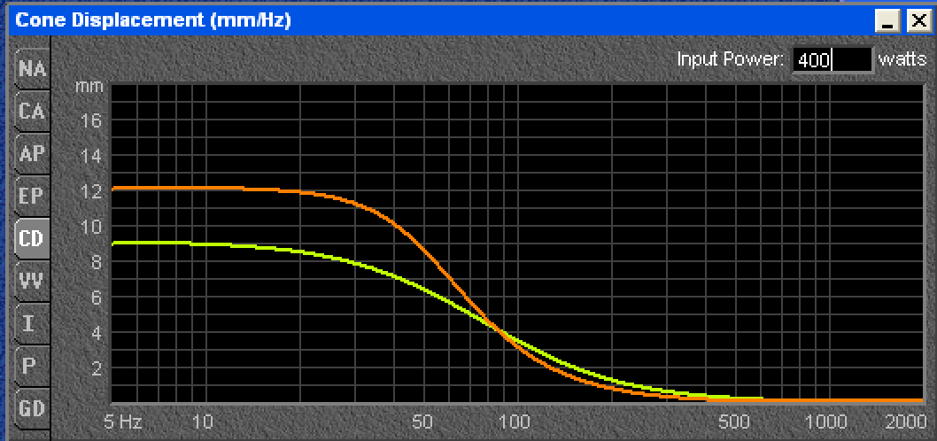

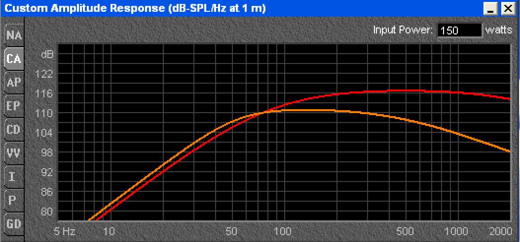

Bassboxx Pro Sim of 12s305 vs 30W
I wanted to see what the difference between the BMS12S305 and Scan 30W would look like so I ran them through Bassboxpro as they are both in the library. BMS is green Scan is Orange.
attachment.php
attachment.php
attachment.php
attachment.php
BMS could be a candidate for a conjugate network to take out the impedance bump.
BMS specs are optimised for vented enclosure so when it is sealed it wants a smaller box just under 17 litres.
The Scan is optimised for a closed box and wants just over 21 litres.
The BMS is much more efficient and is a pro driver that has a greater thermal limit at 800W, it will be harder to use the x-max of the Scan driver without running into thermal limits. Sims are run at 400W without x-max being reached but Pe is only 150W.
I would think they could be EQ'd to be very similar in Frequency response.

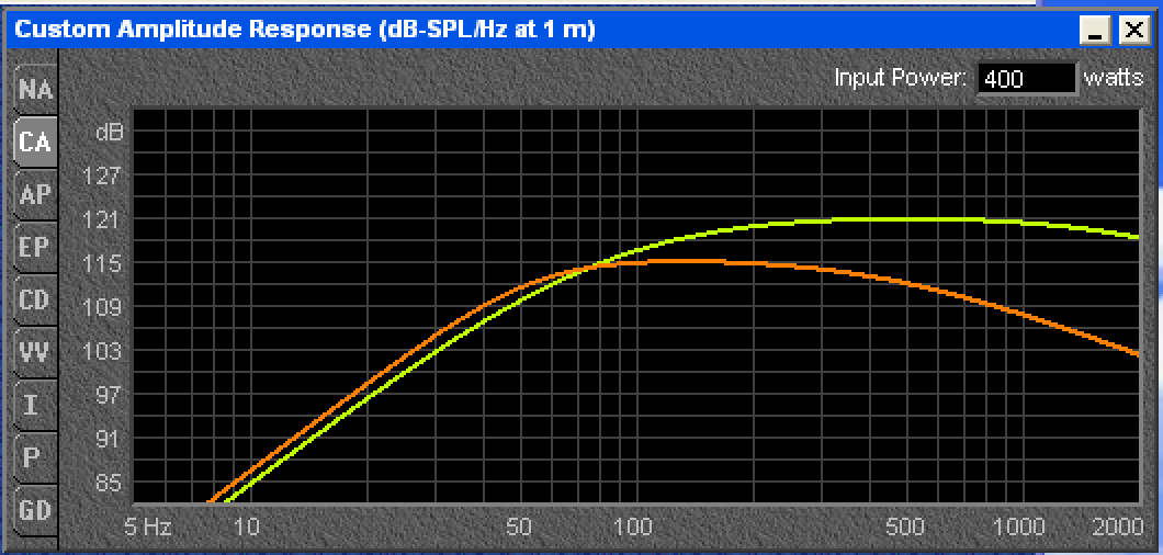

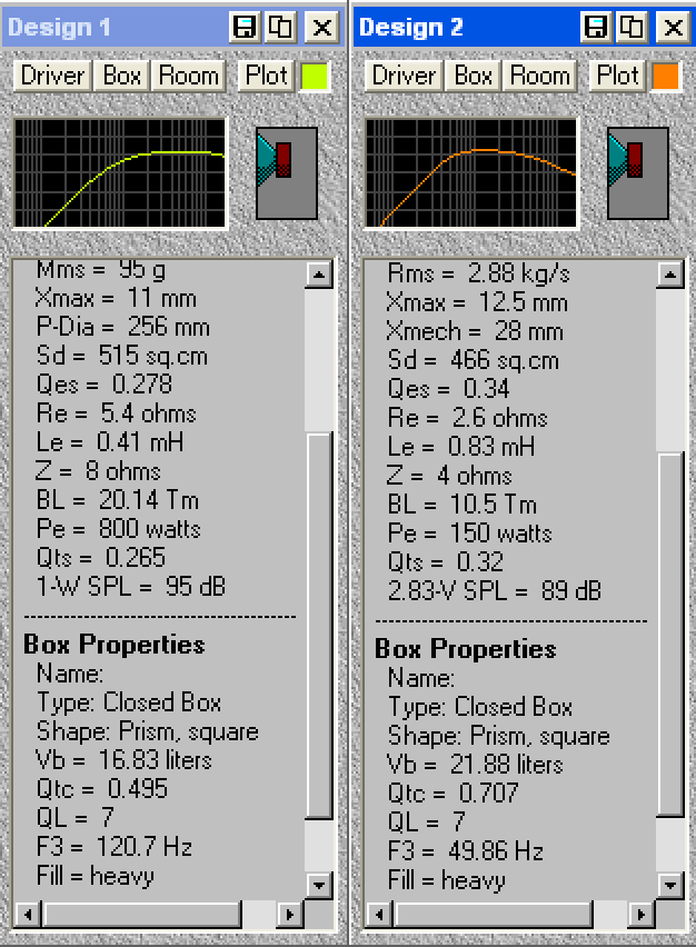

attachment.php
attachment.php
attachment.php
attachment.php
Thomann can source any of the BMS drivers and their shipping is very cheap at least it is to Australia!
This is interesting 🙂. You are very right to bring up the thermal limits of the 30W. That BMS sure would need a powerful amp! So does the 30W, but that one can't handle it for long. Easier at 4 Ohm to find that power cheap (but of good quality) though.

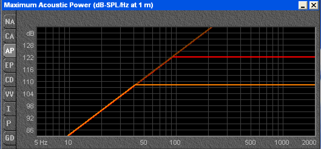

Screen Shot 2017-01-02 at 10.27.01 pm.png Screen Shot 2017-01-02 at 10.30.35 pm.png
The AP Graph shows maximum output and below 40Hz they are almost identical, the BMS has much more headroom above 40 Hz as shown. The BMS will also use less cone travel to get there. You would get very similar output from either with the same power amp but the BMS can take a bigger amp if you have it or need more SPL. As soon as you use a linkwitz transform to boost the bass the maximum spl goes down, Jeff Bagby's woofer designer is good for simulating that.

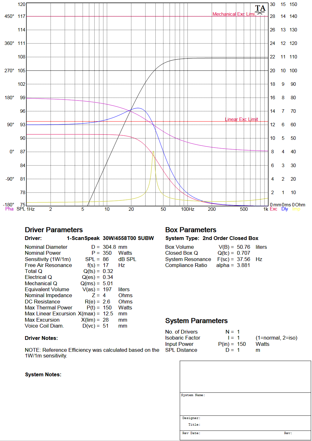

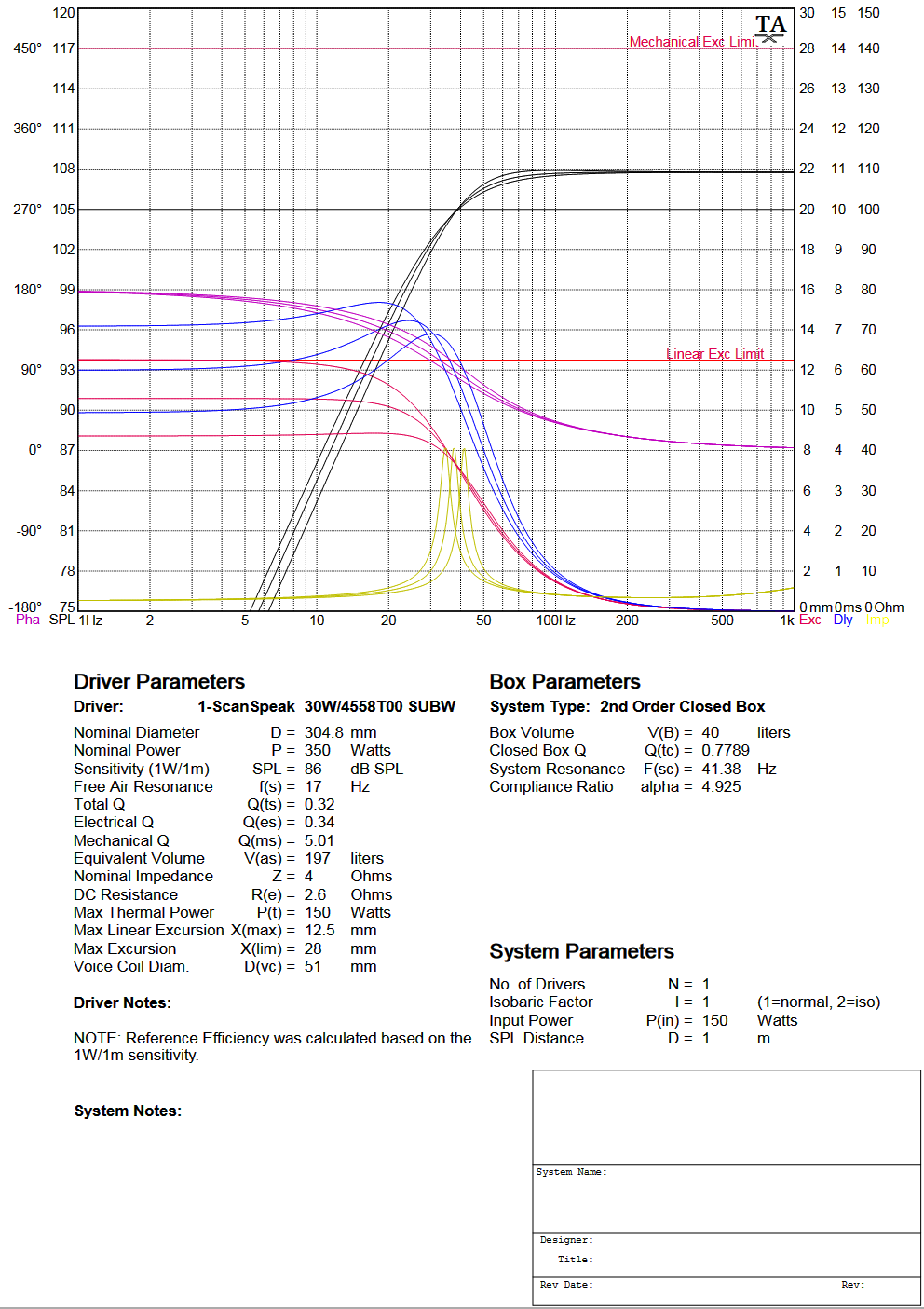

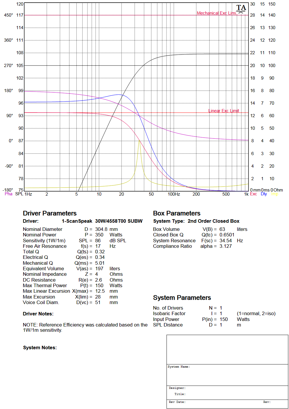

Hi fluid can you help me understand box size for 30W/4558T00 where you optimize at Qtc 0.707 / 21.88 liters / f3 49,86.
My software package is WinSpeakerz v 2.5.2 by John L. Murphy TrueAudio and asking for Qtc 0.707 means 50.76 liters / f3 37.56Hz, and have checked datasheet several times :scratch: to see that T/S parameters is set correct into program.
1. below is Qtc 0.707 / 50.76 liters / f3 37.56Hz where it doesn't hit Xmax feeded 150W.
2. below is lowering Qtc to a point where at 150W input hitting Xmax, this gives lower bass extension and lower resonance point at Qtc 0.6501 / 63 liters / f3 34.54Hz.
3. below is because think Ronald said in past he have 40 liters available in those feet boxes and that gives Qtc 0.7789 / 40 liters / f3 41.38Hz, and with 150W full stroke can't be reached as with Qtc 0.707 config.
4. below is overlay of the three.
For info there is no baffle-step/diffraction loss in those models and because program ask for sensitivity (1W/1m) have decreased number from 89 to 86dB and hope this is correct or should it be decreased 6dB because we talk power here.

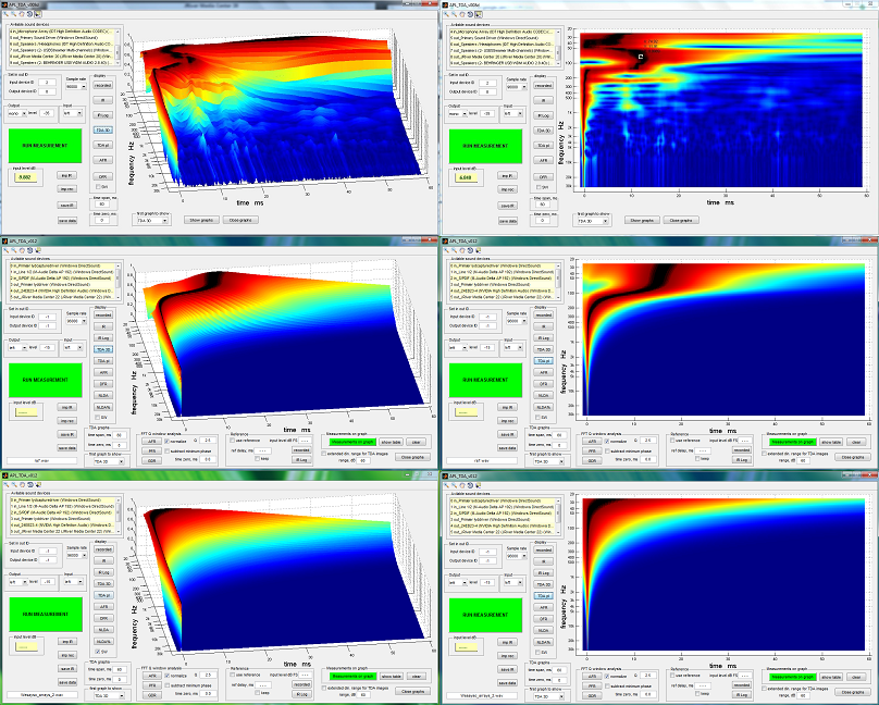

Yes I have, I've done the two back to back when I first tried the Demo version of APL_TDA;
So I decided to take the plunge. I was a bit scared at first. What if this software would prove my DSP processing to be wrong. Anyway, I decided I could learn a thing or two just by trying it.

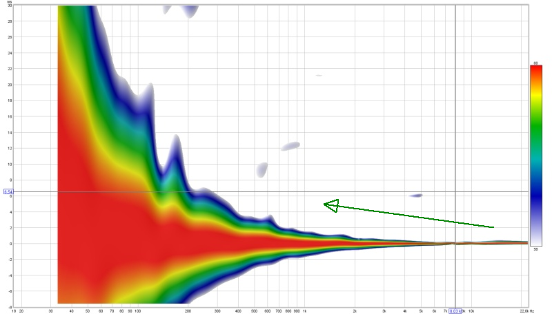

I started as usual, outlining my microphone in REW, making sure my mic is in the sweetspot.
The resulting Wavelet graph in REW:
Next I moved on to the demo version of APL. Installed the required software, including the Matlab compiler and ran a few tests.
At fist I did get odd results at 96000. So I decided to try 48000. My difficulty was getting APL to run trough JRiver's processing. Not the fault of the APL software, just needed to find out how to get it to work. If you look at the uncorrected graph, I was seeing a lot of that. Until I found the right key to get it to run trough JRiver's correction.
Once I got there, confirming the audio route visually in JRiver I got these screen grabs:
And in 2D view:
Mr. Raimonds Skuruls, would you say this is a reasonable result, now viewed in higher resolution? 🙂
I did already say I recognised much of my own priorities in your paper. A way of looking at this audio problem, actually. I enjoyed reading the discussion you had with Toole. I recognised a lot of it in my own rationale, where I differed from Toole's opinion. At least what he did make public in his paper.
I just used different software to get this, the stuff I had available to get me there. To me it does look like it works either way. As it should!
Even the listening impressions you quoted from a client(*) did sound very familiar 😉. So I figured I should be alright running the Demo. Now you can see the minimum phase behaviour I spoke of at the low end. More pleasing than linear phase down to DC.
To show what my result is without my FIR correction:
I keep claiming on this forum this stuff really works, I hope more people do try it.
(*) = on the Prosound website

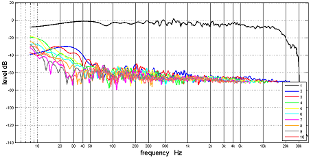

A couple of things to note: the 3D and 2D plots in APL_TDA are normalised.
To see the frequency response you'd need to view the AFR plot, the DFR being APL's version of the group delay.
This graph is build up by slicing up everything with frequency dependent windows (to my knowledge). REW's plot is a lot more cumulative in comparison.
APL's plot looks more like a plot done in thin slices at the top end and thicker slices the further down in frequency you go.
Very informative to get a good view of the timing. Presented by hacking up the IR in slices with thickness depending on the frequency used.
