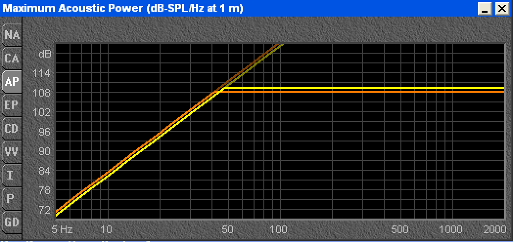

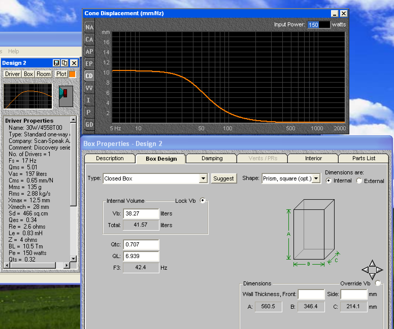

Hi fluid can you help me understand box size for 30W/4558T00 where you optimize at Qtc 0.707 / 21.88 liters / f3 49,86.
Byrtt,
The difference is that Bassboxx pro has the option to include damping material in the simulation when you model the box completely stuffed the size of the box needed is actually much smaller.
If I take the damping out I get this which is much closer to what you had.
Troels did some measurements at the bottom of this page
Port Calculation
It shows that you do need to factor the stuffing into the model if you want the box to behave in a certain way. With a linkwitz transform you can make almost any practical box have whatever Q and response you want with the trade off of maximum spl.

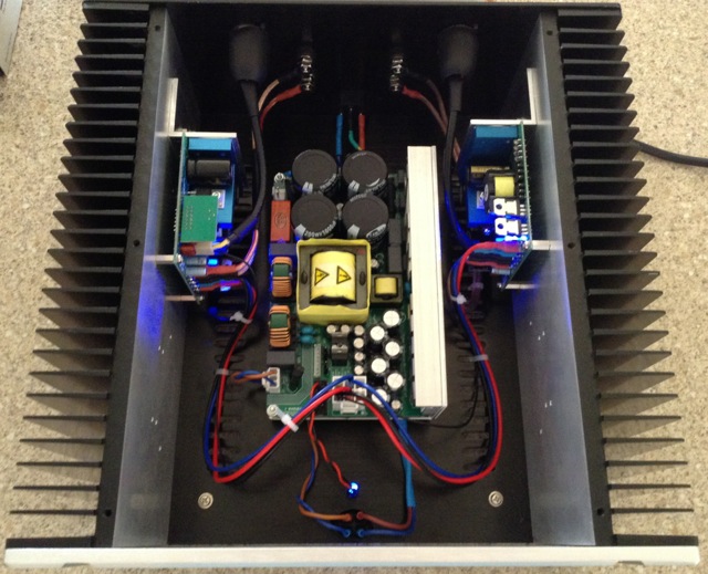

Crown are good brand. If you don't need the plate amp features just bolt a UCD module and power supply to an aluminium plate, use the connection kit and you are good to go. They are a very easy DIY option.
A 4Ohm woofer is a better choice as it is difficult for many amps to supply the current needed to get more than a few hundred watts at 8 ohms.
A UCD400 is good for about 300 watts at 4 ohm before distortion rises. Maybe about 200 watts at 8ohm.
UCD700 is good to 600W 4 ohm but only 300W 8 ohm.
You can use two modules connected to the same power supply to save money. This is two UCD 400 modules connected to a 1200W power supply. Heatsink is complete overkill but I had it already.

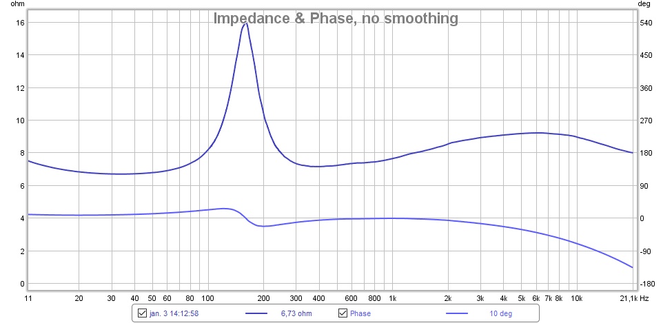

Finally pulled myself together and took an impedance plot of my arrays .
The reference resistor was not non-inductive (47 Ohm // 1mH) therefore the drop in the top.
Have just ordered some 20 Ohm non-inductive, so stay tuned.
The plot clearly shows that the volumen is too small, which I already knew, as the dimensions of the alu-tubing couldn't be changed, but otherwise I think it is pretty clean.
No serious abrupt wrinkles, although there are some small and broad deviations.
What do you think?

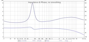

What do you think?
