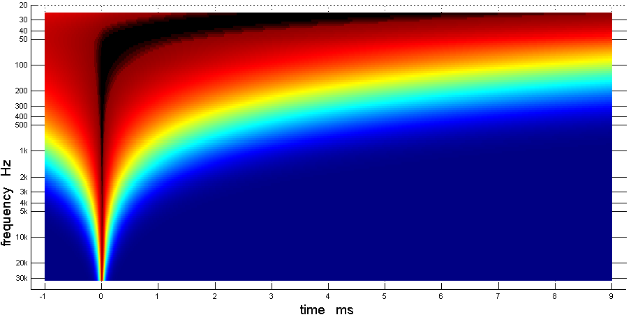

Thanks Brytt for the comparisons and for showing the effect of a 48 db/oct crossover at 80 Hz. I'm not sure if the slope is LR or BW, JRiver don't allow you an option to specify the slope type. But it's clear what's causing the warp around 80 Hz...
...Today has been a gigantic waste. We got dumped with a foot of snow. I hate shoveling snow!
The standard high/low-pass in Jriver they are perfect IRR BW slopes and i know because have looped them back via SPDIF interface to check their precision curve presented into REW, so if you run one filter 48dB/oct its BW -3dB at XO point, and if you cascade two 24dB/oct gets you LR8 -6dB at XO point.

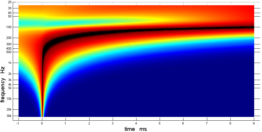

Well doesn't that explain itself "maximize below 1st plot"
Own personal experience is admit A/B test with all-pass filters phase distortion above 1kHz is impossible to recognize but below 1kHz its some audio able especially over longer time listening session then the system setup with good timing gets one much more realism and closer to recording room.

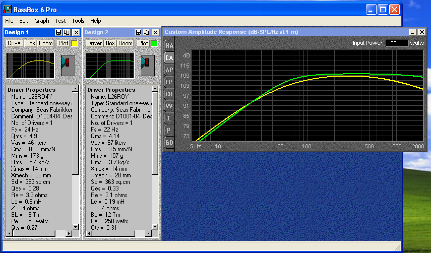

L26ROY / L26RO4Y. 2 layer copper voicecoil difference => different mms/qes...
Someone has got the spec wrong somewhere as both are different in Bassboxxpro to the SEAS datasheet. Both of the SEAS figures seem very high for drivers that don't roll off early. Most drivers with an Le that high would struggle to have much output above 500Hz.
But it does seem that the L26ROY is actually a better driver for a closed box.
These are the parameters bassboxxpro has for them.
