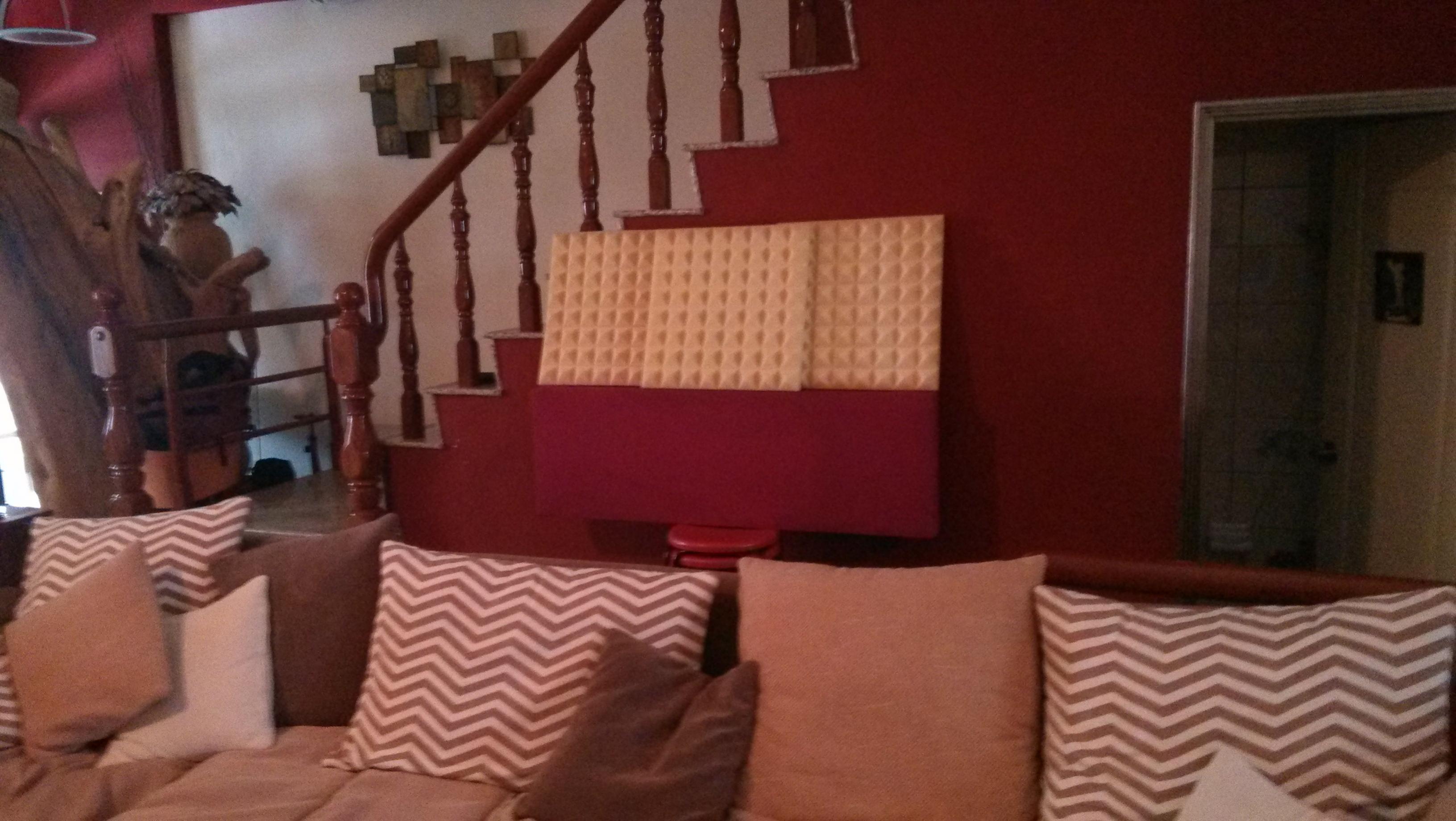

Here's my temporary solution to the back wall, it's portable, and so far, I didn't get huge rolling eyes from the wife... I'm sure she wants to say something, but since I can take it all away quickly (as it is not there most of the time, but only when I listen more carefully or run sweeps), she tolerates the setup... so far.
The bottom is a frame filled with RockWool 3" (9cm) thick, and some 5cm acoustic foam stacked on top.

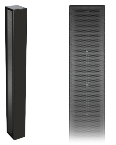

A couple of factors to keep in mind:
- the off axis output will be about the same as the single driver used in the array, meaning no controlled directivity horizontally compared to normal speakers.
- you need EQ to get things in shape. No way around that unless you go with a shaded array or other solutions.
You do get way less in-room reflection problems, mainly from floor and ceiling, the line of drivers has a way to average out those reflections. Vertical planes parallel to the arrays are the biggest source of worries.
Hope this helps to get an idea. I couldn't tell you if it would work out. I have zero experience in a room line that. I have seen more than one line solution used for spaces like that. Horns could be another solution. That way you can determine both horizontal and vertical directivity.

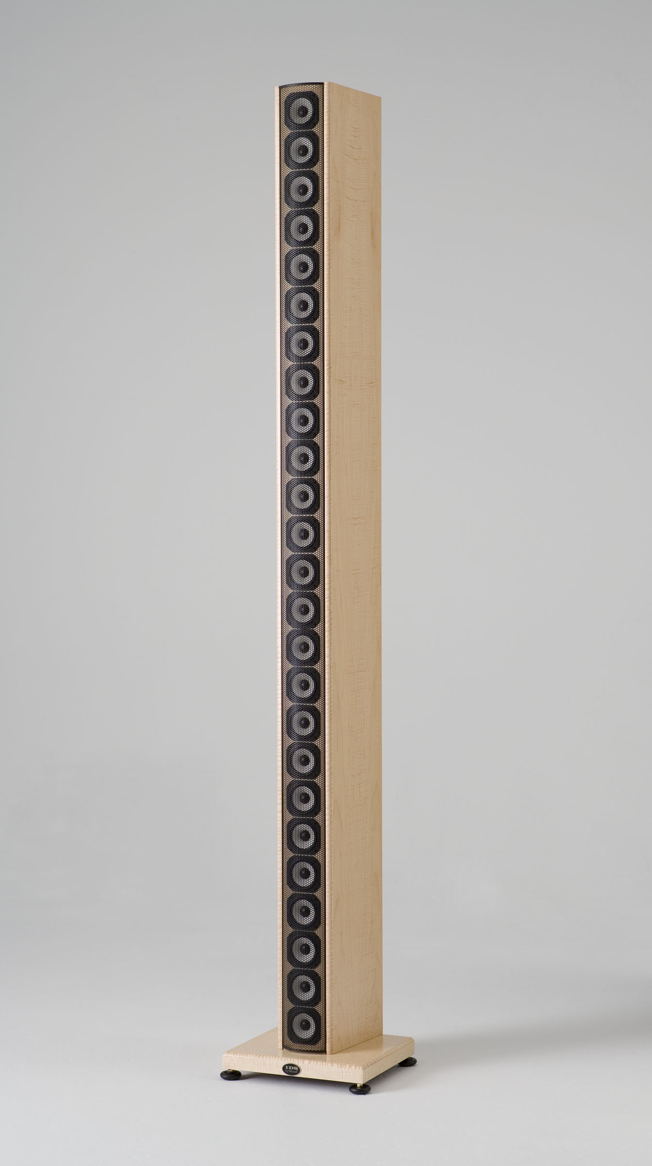

Has anyone in the USA heard these? The driver appears to be a magnetically shielded version of the TG9FD10.
Advantages* of the* IDS Technology
My Experience with Column Systems
![Maple full.jpg Maple full.jpg](https://www.diyaudio.com/community/data/attachments/544/544947-6c357b0b1bb86eb328b4bca89f7d4428.jpg)
those have been discussed a lot.
It's one of the reason wesayso decided to build his own... not willing to spend $18,000...
Although, if you ask him today, I'm sure he will say they are worth it with the amount of work put into them, either the IDS, or the Two Towers... even though, to me, the Towers look even better!

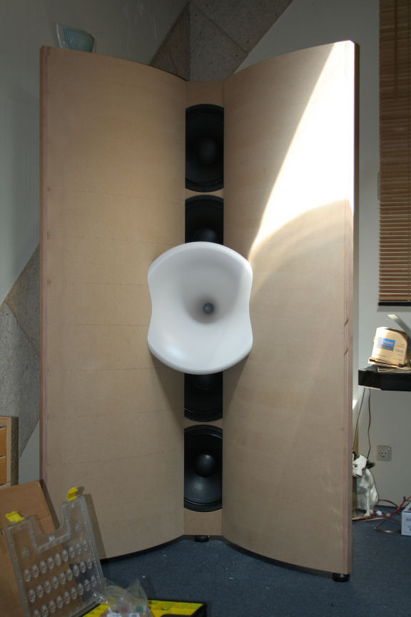

If you want to build something I'd build a reasonably tall array (over 2 M) with wave guides at the side resembling the guides on this one:
(Omitting the horn)
Use smaller drivers and lots of them. In other words, put speakers like mine at the apex of the big guides. You still need EQ and can't use (much) phase correction in live broadcasting.
(Omitting the horn)

- Full Range
- The making of: The Two Towers (a 25 driver Full Range line array)
