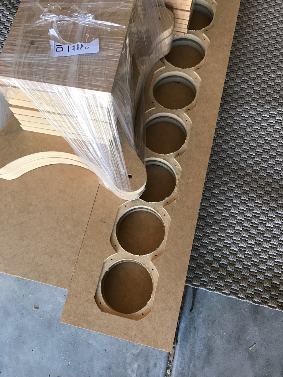

I had a visit from the CNC Fairy today, I will start a new thread to document the build but this is as far as I have got for now. Fingers crossed I got the CAD design right...
Cool! CNC Fairy's are good, much better than a hand router!

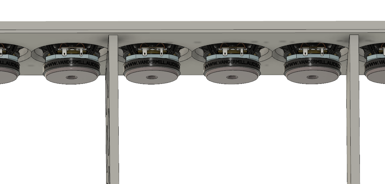

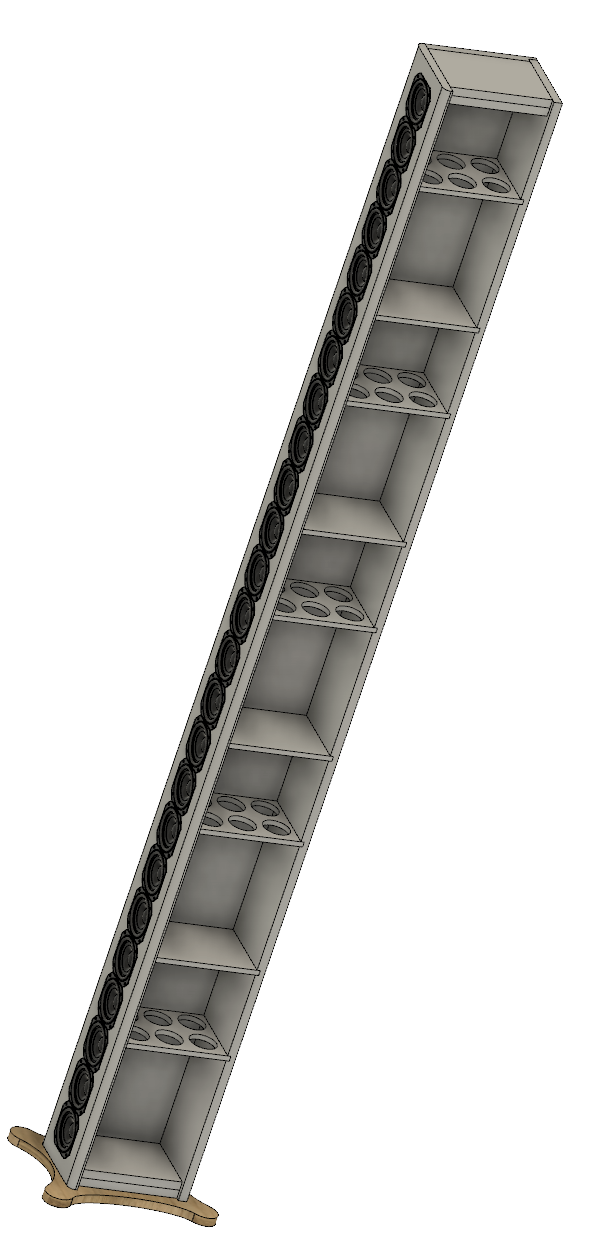

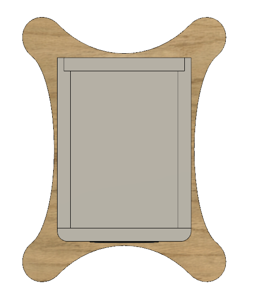

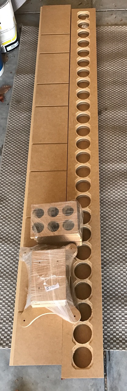

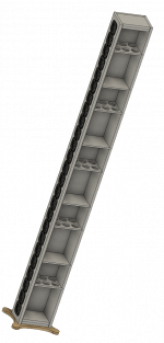

I made a 3D model and used your 3D TC9 to do a sanity check and all looks to fit together nicely.

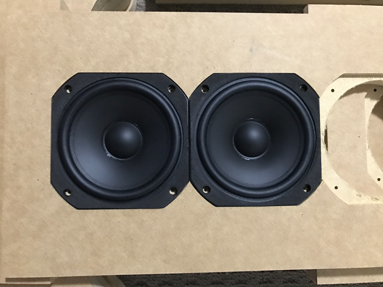

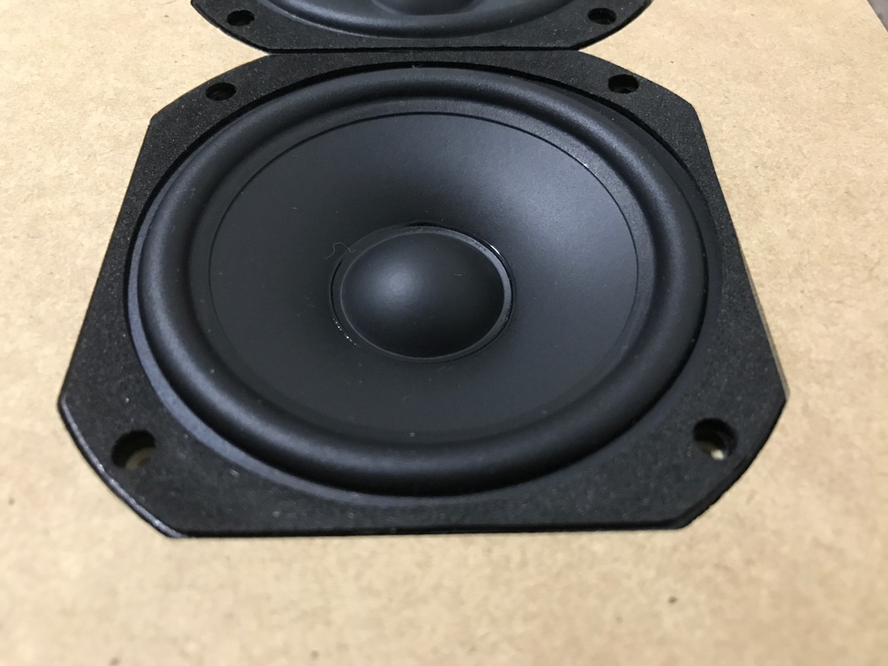

I did see a finished CNC-ed baffle. Do the real drivers fit?
If you can, I'd definitely look at ways to chamfer the sharp edges on the sides. These will be something in common for each driver, thus it will not be averaging out by using many drivers. You'll get diffraction from those sharp edges, how severe it will be I cannot tell you. Though every little bit we can do to avoid it does help.
Duhh... I must be blind. Upon second gaze I do see a round-over, though a relatively small one. It will still help avoid some of that diffraction.
Your drivers are even more closely packed than mine. Good! I still have "some" space between them. If you fill the chamber with damping, be sure to use impedance curves as a guide. Look for the smoothest curve possible. Every bump in that graph is a potential FR problem.
Especially with the TC9 as it's very well behaved when measured without an enclosure.

Your drawing has that uneven number plus the out of sync in-between support which should help.
I did see a finished CNC-ed baffle. Do the real drivers fit?![]()
Until you asked that question I hadn't checked, I have now and they are a perfect fit
There is a 1/2 inch roundover on the front baffle in the model but the actual baffle is still square as that will need to be done manually after the cabinet is assembled. A Top down view should make it more obvious. The features of the model tend to get obscured in the screen grabs wen you need to get the whole line in.
The part that is not shown in the model is my plan to reduce edge diffraction by using pressed wool felt on the baffle similar to a Dunlavy approach. The added benefit is that it will allow a bit of space for excursion as I plan to wrap the line in a fabric sock like OPC except mine will be black.
I can recommend real wool felt on all walls, fiberglass insulation as damping material and a layer of felt between the fiberglass and the back of the driver. I still have some open space behind each driver. The wool felt definitely helped to get better results vs Fiberglass fill only.
The drivers are mounted frame to frame so there really is no space between them!
I would love to use wool felt but the prices of it here are too high. The 4.8mm baffle felt cost me enough. I got some fibreglass insulation at a really cheap price so that will form the bulk of the stuffing and I will probably wrap it in the white polyester that I also have. I have a sheet of 3mm rubber that I might use to line the inside walls with in an attempt to get some CLD. It will be a lot of effort to cut the rubber so it may get dropped.
I am trying to get the best result I can while still being efficient with my time and resources so I doubt I will get to all the tweaks you did, but they are guiding me on where best to put the effort.
Only in hindsight I noticed 25 of these drivers were having the impedance peak very close to the baffle length. Meaning my 2.25 M tall baffle is very close to the ~150 Hz the total impedance landed on. So be sure to fasten the baffle in a non symmetrical way, not divided in 2 of 4 or 8 but at 3, 5, 7 etc. places... I ended up damping the baffle/enclosure + O-rings on mounting screws which cured an irregularity in the impedance.
There will actually be 5 separate sealed enclosures as the solid braces will be glued to the baffle. The entire cabinet was designed to be glued together to form a rigid structure so it won't be fastened at specific points. The Dado's and the faces will be glued and clamped along their entire length.

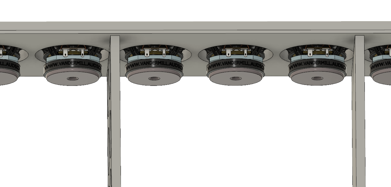

Be sure to look into the points where the braces are between drivers, with the drivers packed that close you don't want to limit the back wave opening. I used a piece of MLV in the opening as to keep as much airflow as possible. I also used that side to wire up the drivers.

I thought very hard about getting CNC cut ply but cost and complexity was too much.

The braces are only 9mm thick so they don't take up too much space, the strength comes from being sunk into the cabinet and glued together.
I am deciding whether to chamfer the back of the magnet cutouts, a 4mm chamfer looks like this.

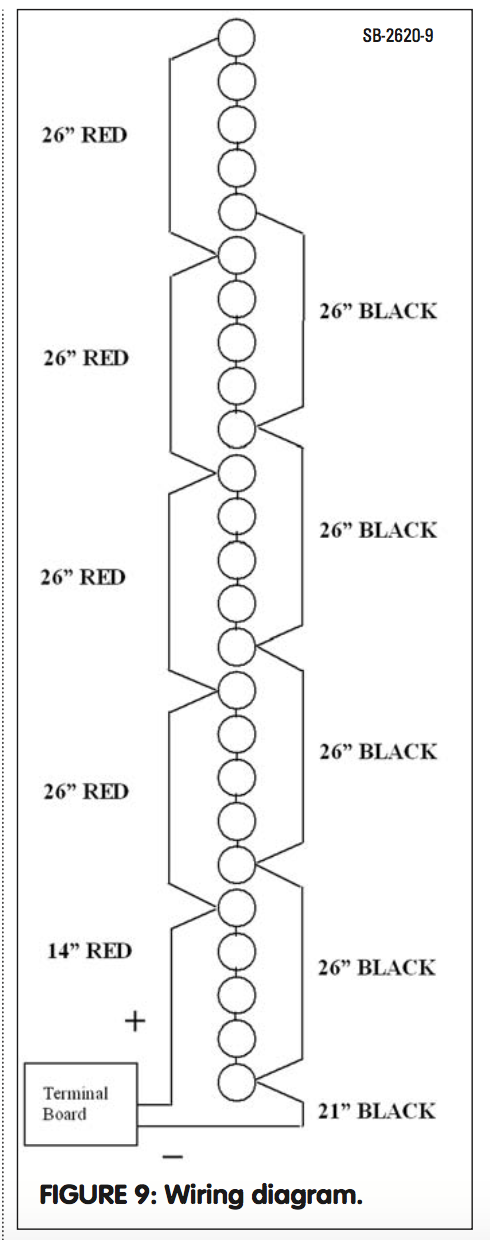

I'm planning to wire mine like this from Roger Russell's Audioexpress article. I've got some knock off Wago wire lever clamps to use where the wires are joined to avoid having to run multiple lengths of wire up and down the cabinet.
- Full Range
